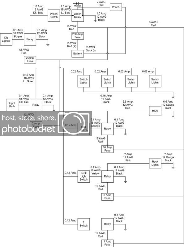

Figure out what you plan on adding to your Jeep and how many amps that will draw. Add a little extra to your calculations to plan for any future accessories. Purchase your fuses and relays according to what you need for each modification.

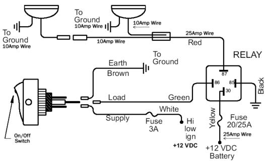

Plan out where you want to mount and install your accessory fuse block. Your fuse block should have one relay installed for your switches and an additional relay for every other accessory you plan on using. Pay attention to the pin numbers on your relays.
  • Pin 85 is the pin where your switches will connect.
  • Pin 86 will be for your ground wire.
  • Pin 30 will always connect to a fuse, then pin 87 will always go to whatever you're powering.
  • If you keep this in mind, the wiring step will be less confusing.
Figure 1. Pins on the relay. Switches can go on either pin 85 or 86. Just try to stay consistent.
Your fuse box will be connected to the battery. For the switches, a single 5 amp fuse will suffice. For your accessory fuses, it will depend on the kind of amp draw you'll have from the accessory, but you should not need higher than a 30 amp fuse and a 50 amp relay. Write out a diagram of your planned circuit to follow as you work on it.
Figure 2. Here is a sample circuit diagram for what we're trying to do.

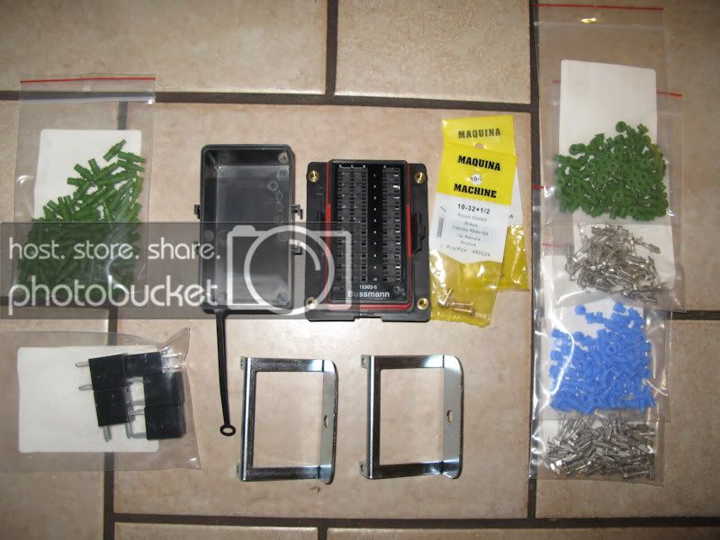

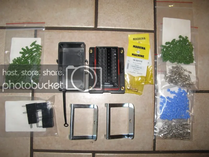

If you have everything planned out, the actual installation should be simple. Mount your fuse box somewhere in the engine compartment. Fasten it down with bolts or screws. Make sure that it's secure enough that it won't move.
Figure 3. Fuse and relay box plus parts needed.

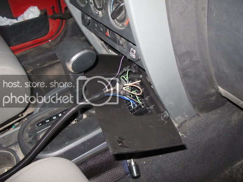

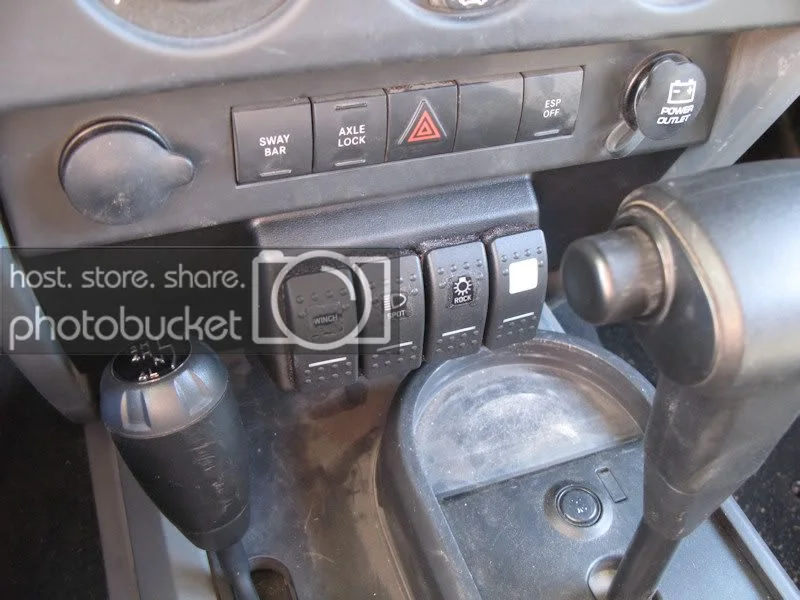

For the switches, you'll need to find a space that can hold all of the switches you need. Some good places for installing a switch block are on the center console below the HVAC controls, above the rear-view mirror, or even on the driver's side A-pillar. Once you have a spot picked, out drill a hole in the paneling large enough to fit your switch block. Clean out the opening with a rotary tool, then fit your switches to the opening.
Figure 4. Switch fitment on bottom of center console.

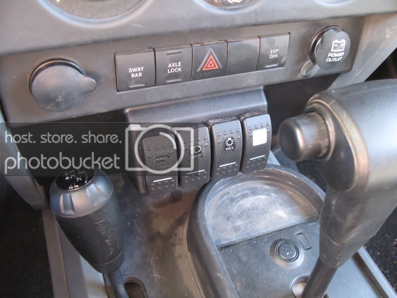

This is the most confusing step, but if you can remember your circuit plan and remember what each pin on the relays are for, then it should be simple to figure out. Start by wiring the switches. Each switch should have three pins: two positive and one ground. You can connect all your switches to a single positive input wire which will connect to pin 87 on your switch relay. The switch relay's pin 86 will connect to a 12-volt power source that is only on when the car is on. The other two pins on the relay will connect to a fuse and a ground terminal.
Figure 5. Wiring the switches.

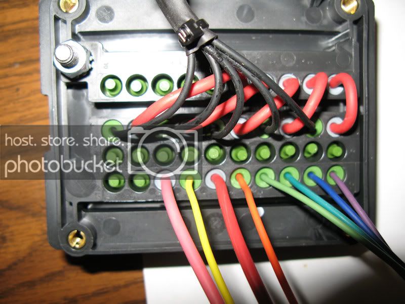

Each switch will have a positive output connecting to pin 86 of a relay. The ground wires will need to be crimped to a ring terminal which will attach to the Jeep's chassis. Once your accessories have all been wired and all the ground wires are firmly connected to the chassis, you're ready to add power from the battery. Connect your 8-gauge wire to a circuit breaker. Mount the circuit breaker somewhere in your engine compartment. Then, connect the circuit breaker to the battery with another ring terminal.
Figure 6. Wiring the fuse and relay box.
