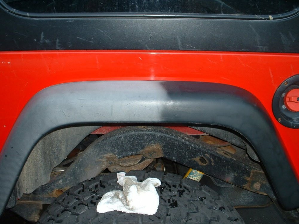

Step 1 – Clean components
The first step is to use a cleaner and try to clean it as much as you can. Sometimes the salts come off easily as you spray cleaner and wipe it off. Do this on all four fenders as well as both front and rear bumpers.
Figure 2. Clean the fenders and bumpers.

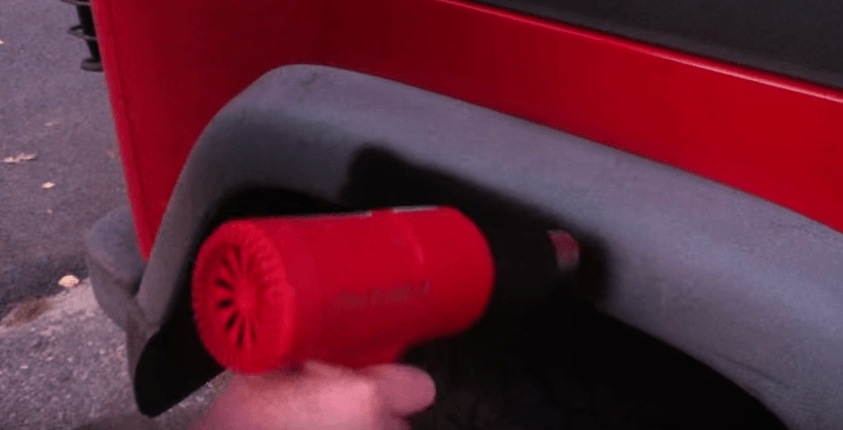

Step 2 – Use heat gun
After you've cleaned them as much as you can, use your heat can to restore them. This process is slow and time consuming, but the results are well worth it. Use your heat gun slowly and move along the fender; you will see the faded color change as you go over it, and don't stay too long after it turns shiny. The heat gun produces roughly 1,000 degrees, so you don't want to stay too long on one area, or you will end up melting the fender.
Figure 3. Use your heat gun slowly and steadily.
