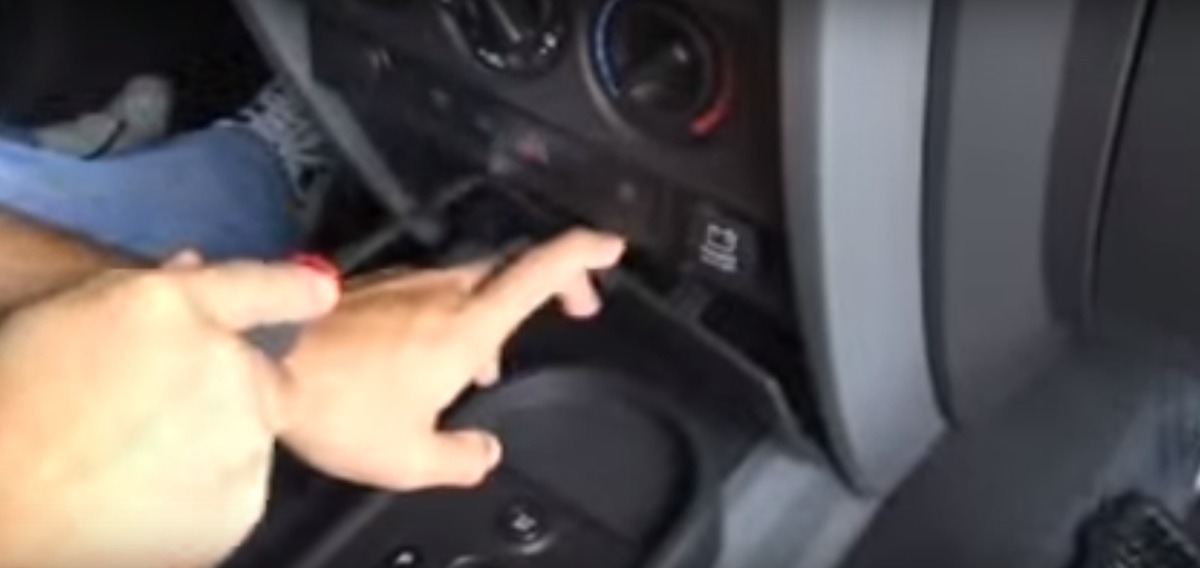

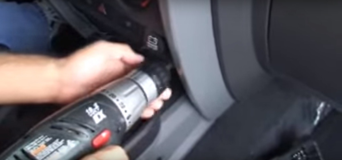

  • Use a flat head screwdriver to pry the panel below the HVAC off.
  • Remove the two bolts behind the panel using either a driver or a drill.

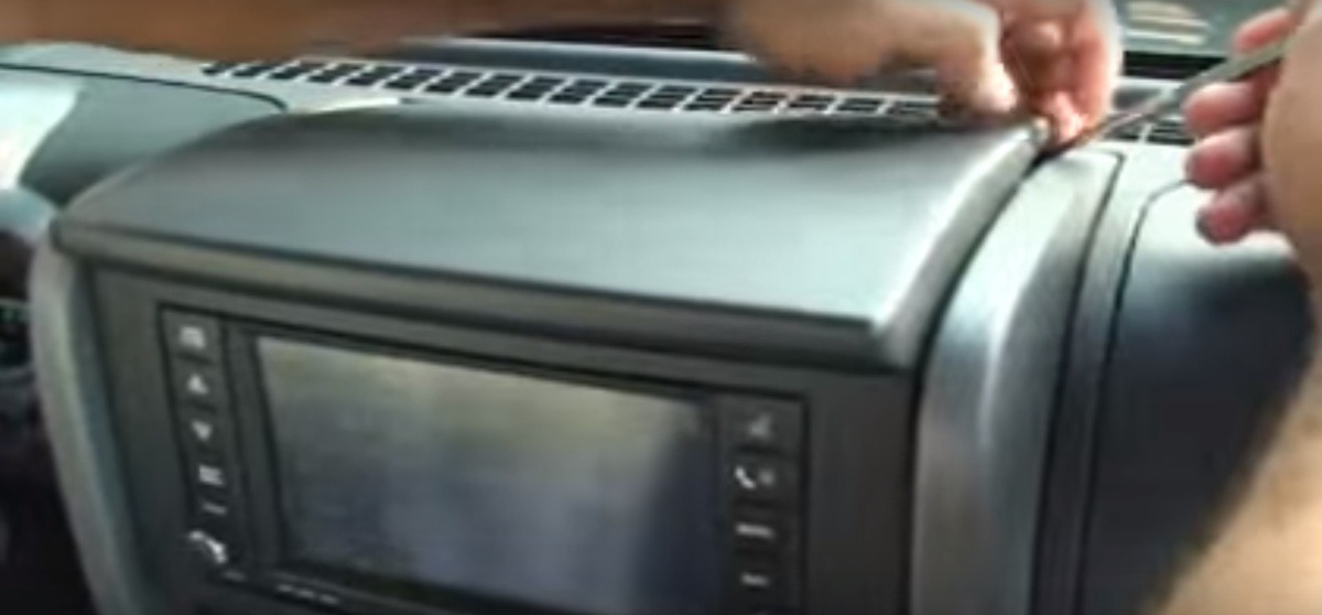

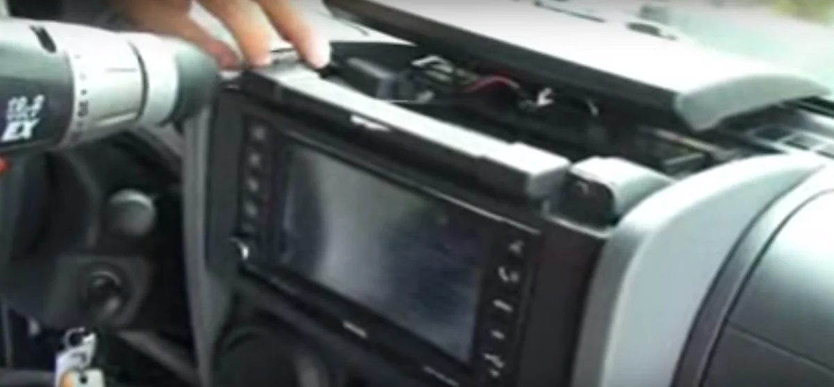

  • Pry off the panel on top of the dash directly above the radio.

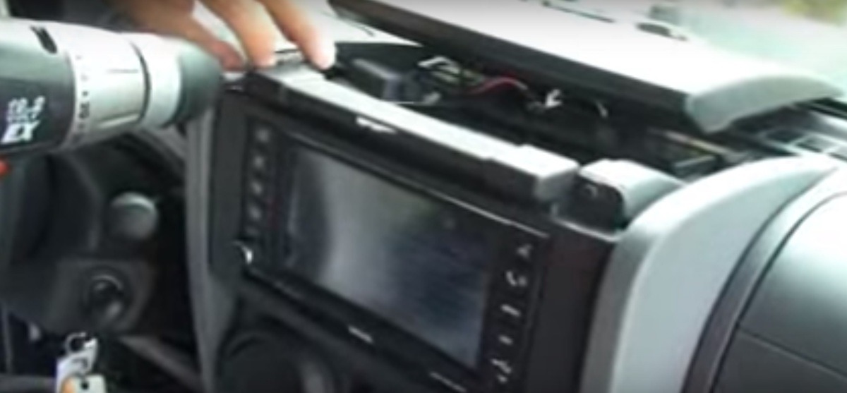

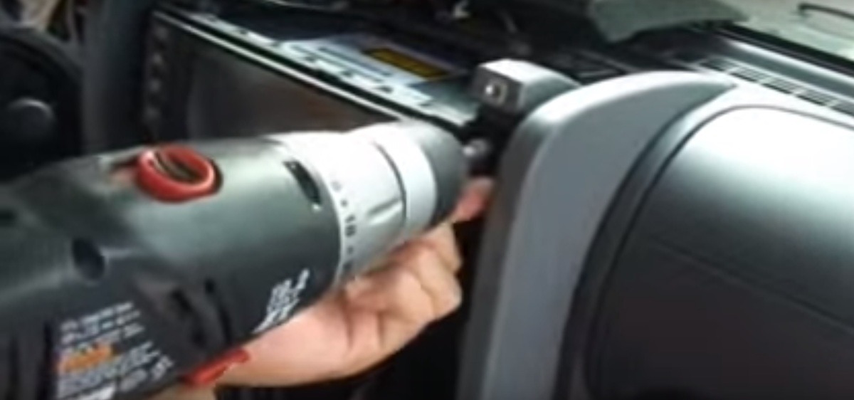

  • Remove the two bolts located on either side of the radio.

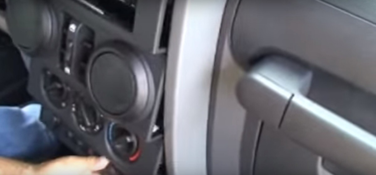

  • Pull out on the center dash trim starting at the bottom to remove it.

Figure 1. Pry off the bottom trim piece.
Figure 2. Remove the two screws behind the panel.
Figure 3. Pry off the top trim panel.
Figure 4. Remove the two screws.
Figure 5. Pull the center console trim piece out.

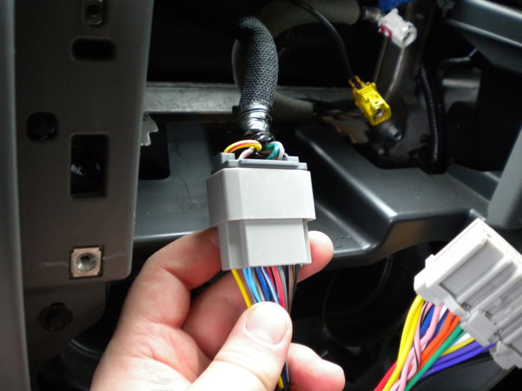

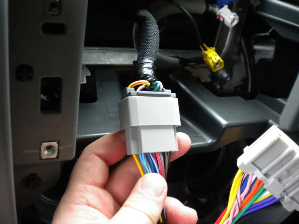

  • Disconnect the gray connector on the back of the factory radio, as well as the white multimedia connector if your vehicle is equipped with one.
  • Install the gray connector from the Lockpick, then install the white connector into the open multimedia slot.
Figure 7. Connect the Lockpick harness adapter into the stock harness.

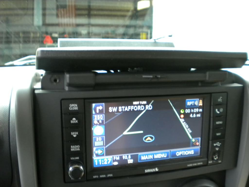

  • Test the new in-motion abilities and plug in a coordinate/destination to make sure the lock-out is disengaged.
Figure 8. Test the new system.
