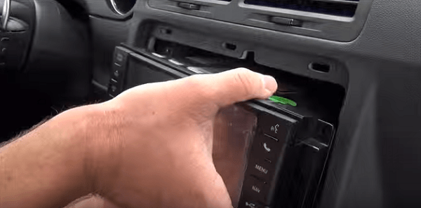

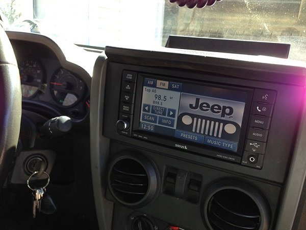

The MyGIG is a solid unit, and a nice add-on by Chrysler to its Jeep Wrangler vehicles. Between navigation and satellite radio, there are plenty of options for keeping you informed and entertained on the road.
Figure 1. Jeep Wrangler MyGIG heat unit.
But if you’re finding yourself a bit frustrated by an older unit that’s simply dated and in need of an upgrade, here’s how you can do it yourself at home.

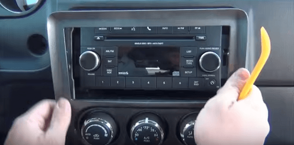

Step 1 – Remove radio
Using a flat head screwdriver, pop the dash off the face of the radio. Remove the panel gently by pulling forward. There are four 7mm screws–remove them and pull the radio out. Unplug all wires without damaging them.
Figure 2. Radio surround popped off.

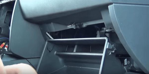

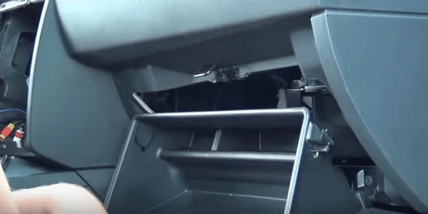

Open glove compartment, pull down drawer, un-hinge door to drop it to floor—this will give you access to the Uconnect module.
Figure 3. Drop the glove box enough to run jump cables through.

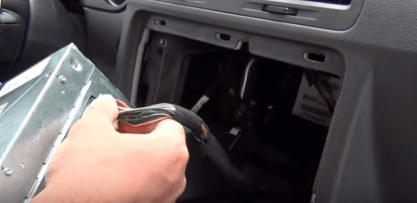

Disconnect the two cables going into the Uconnect module and plug them into your new radio’s jumper kit.

Plug in the existing radio harness; if you are using the aforementioned jumper kit, this is where you connect the new wires (do not connect the existing Uconnect harness—it’s now useless if you upgraded to the jumper kit).

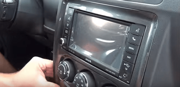

Figure 4. Connect the harnesses.
Plug all wires into their appropriate connectors (marked accordingly on the rear of the RHR radio)—this includes AM/FM connector, GPS, and USB connector.
