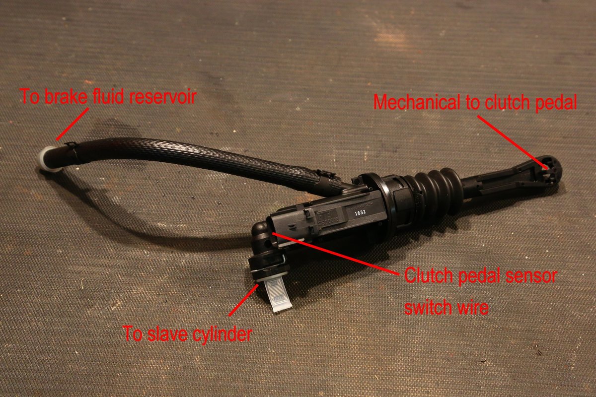

The new part
The old part
Study the orientation of the part to help find the various connections. Note that the clutch pedal sensor electrical connection is butted against the fender well. You can disconnect it after loosening the master cylinder from the firewall.

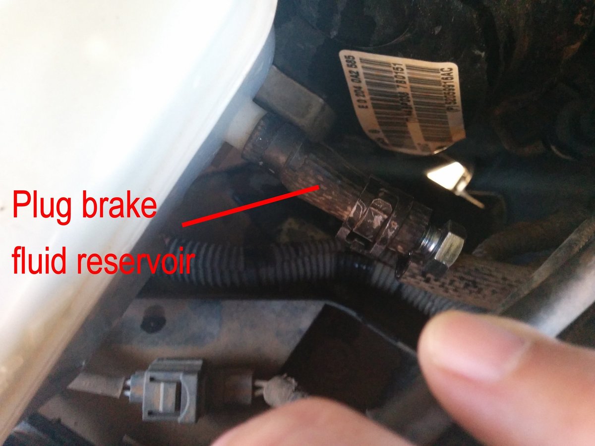

Disconnect the brake fluid reservoir hydraulic line to the clutch master cylinder. Plug it to prevent leakage. I cut off a short piece of the old line I'd just disconnected and threaded a 1/4-20 bolt into it.

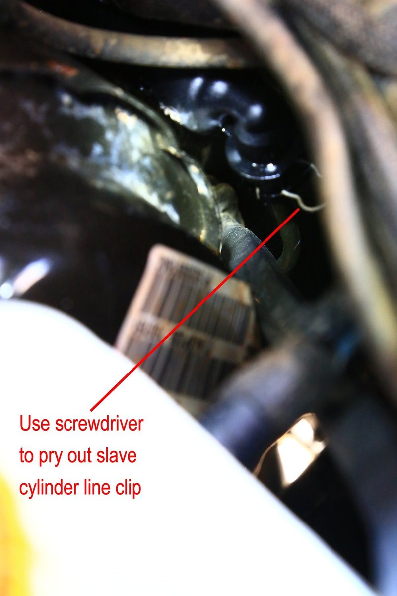

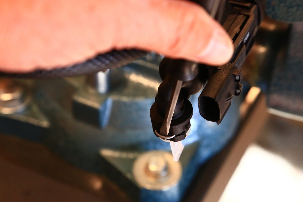

Use a screwdriver to pry out the clip that holds the hydraulic line to the slave cylinder in place.

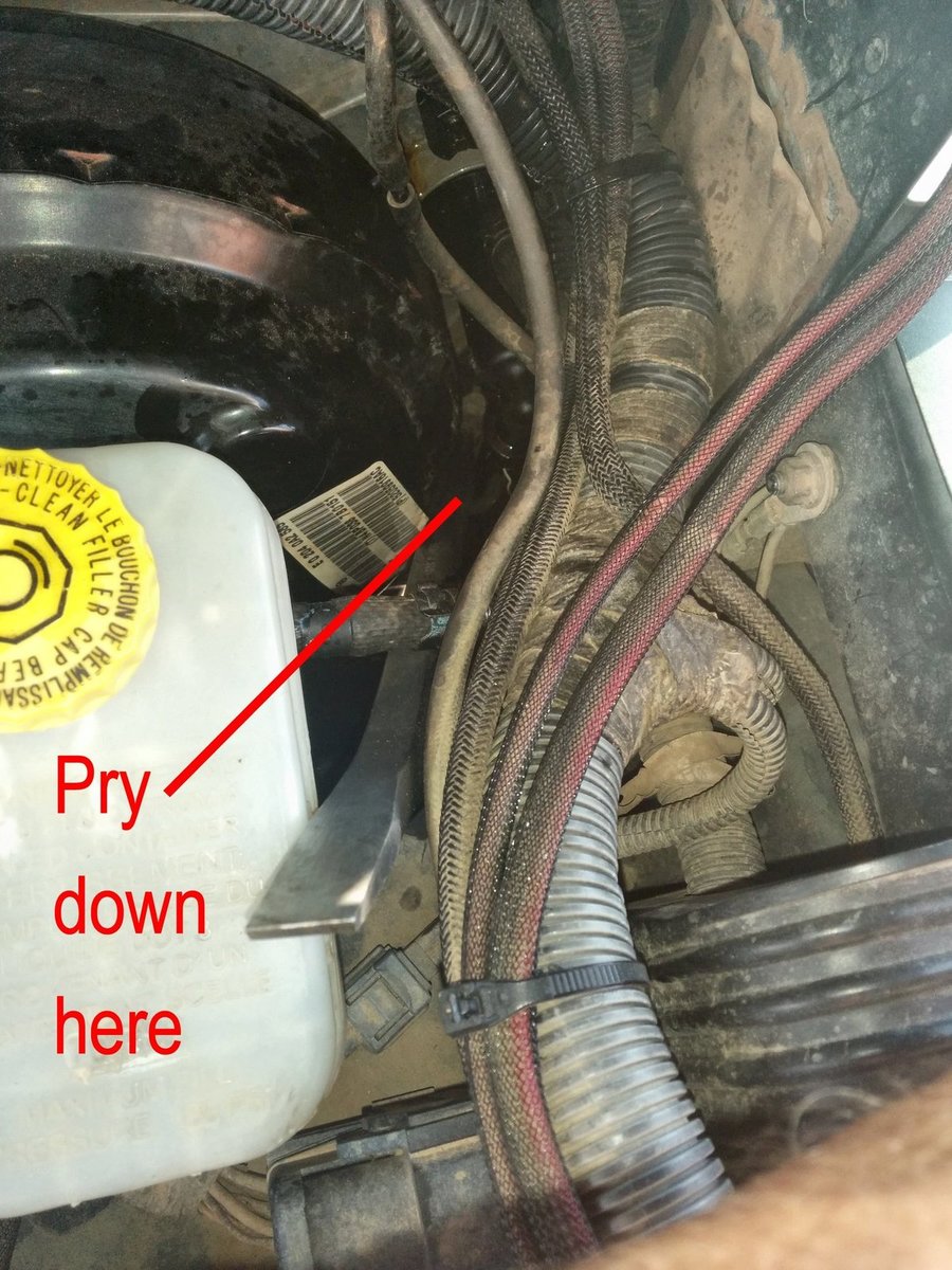

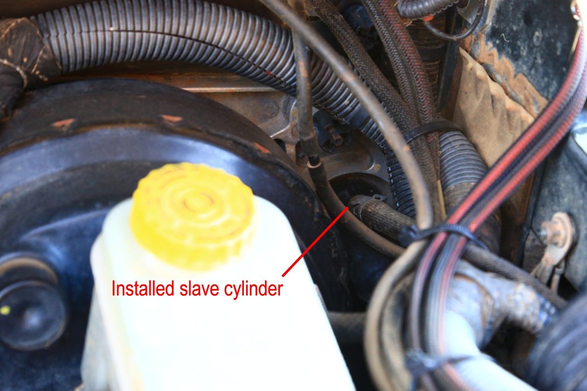

The slave cylinder hydraulic line connection to the master cylinder is very tight. I had to pry it down, and it took a lot more pressure than I expected. Before doing it this way, note further down how I would learn later to get better access to this area through the inner fender liner.

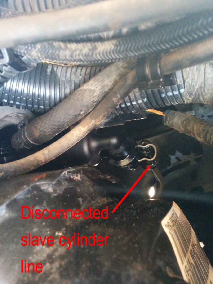

This is what the disconnected slave cylinder hydraulic line looks like. Just ensure you aren't missing any of the specially shaped seal.

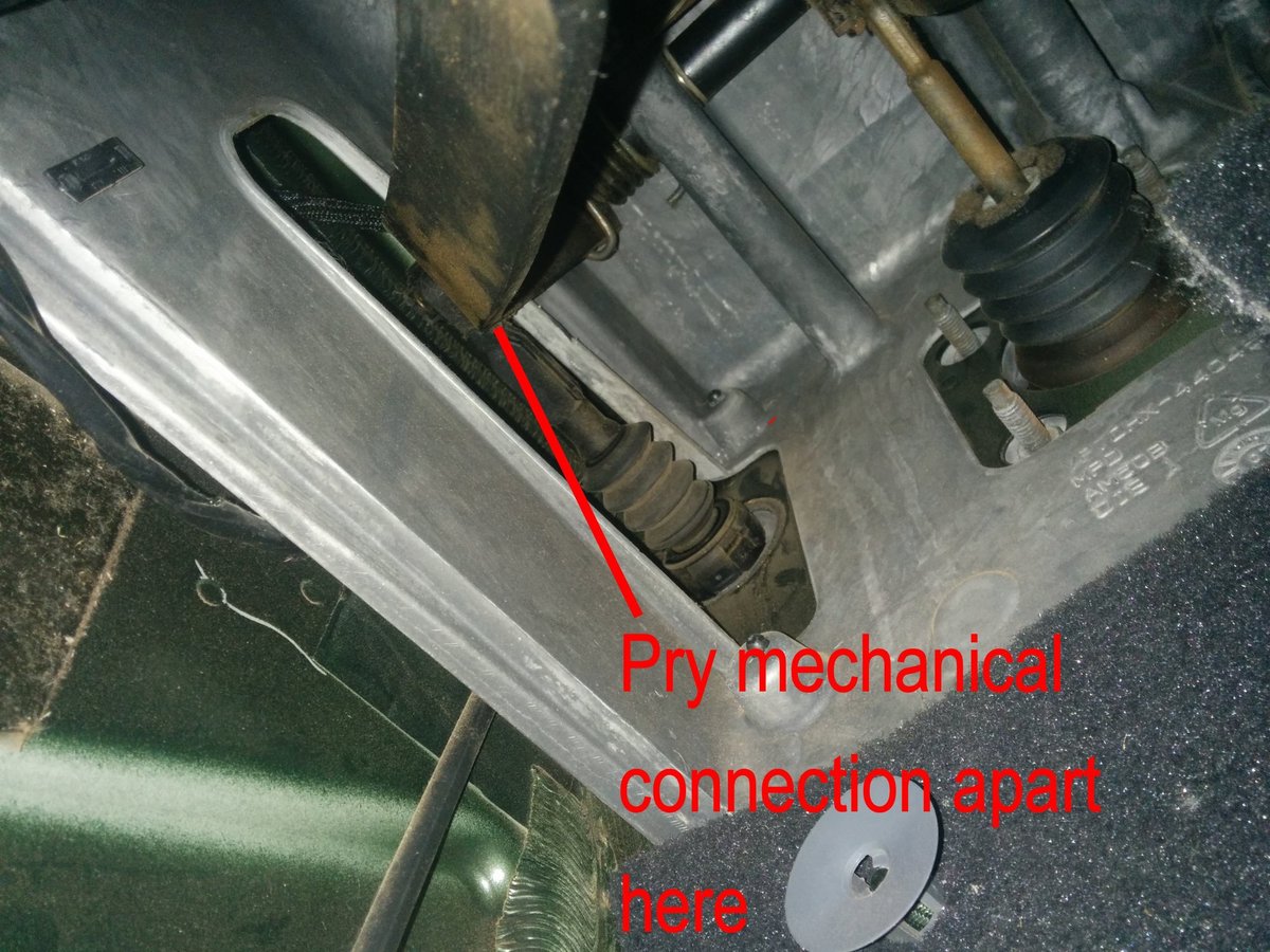

Pry the mechanical connection to the clutch pedal apart with a screwdriver.

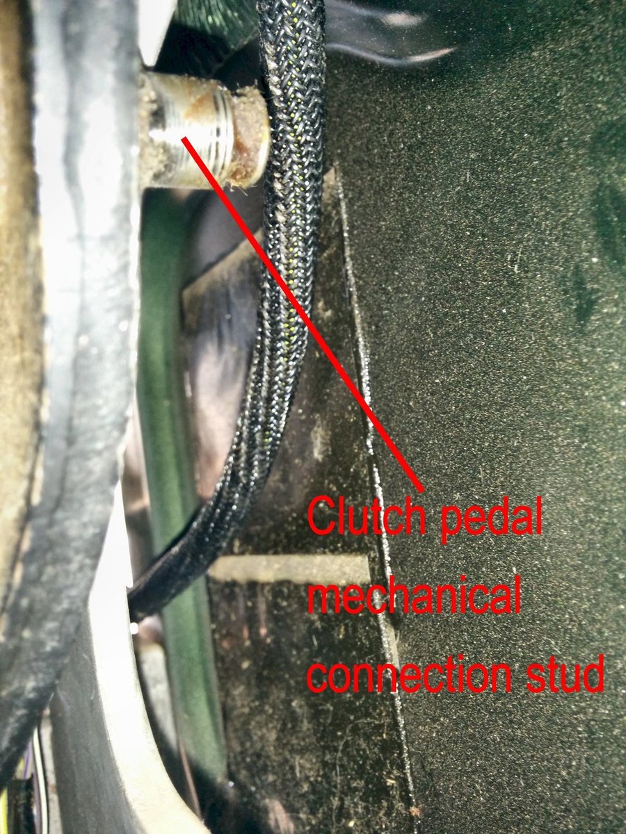

This is what the stud that the mechanical connection goes to looks like. It's just a press fit, but does snap into place. You might want to put a little grease on it before reassembling.

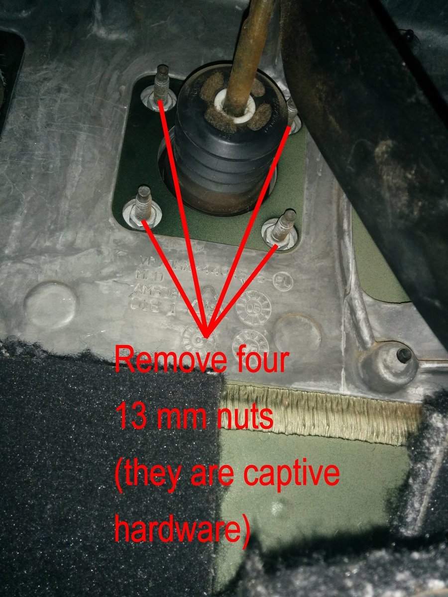

In order to rotate the clutch master cylinder you'll have to make clearance for the connection to the brake fluid reservoir to rotate around--it bumps into the power brake booster. So, remove these four nuts behind the firewall. The nuts are captive--they will stay in place up there once the brake booster is loose. Because they are captive, you'll have to loosen each one a little bit, then move on to another one, keeping all within a few threads of each other on the stud. If one starts to get tight as you're unscrewing it, move on to another one and return to that one when you get the other ones about even with it. From under the hood, pull the booster forward to clear the holes for the studs, then push it to the side--only about 1/2" clearance is needed. Be careful to not put too much pressure on other hydraulic lines.

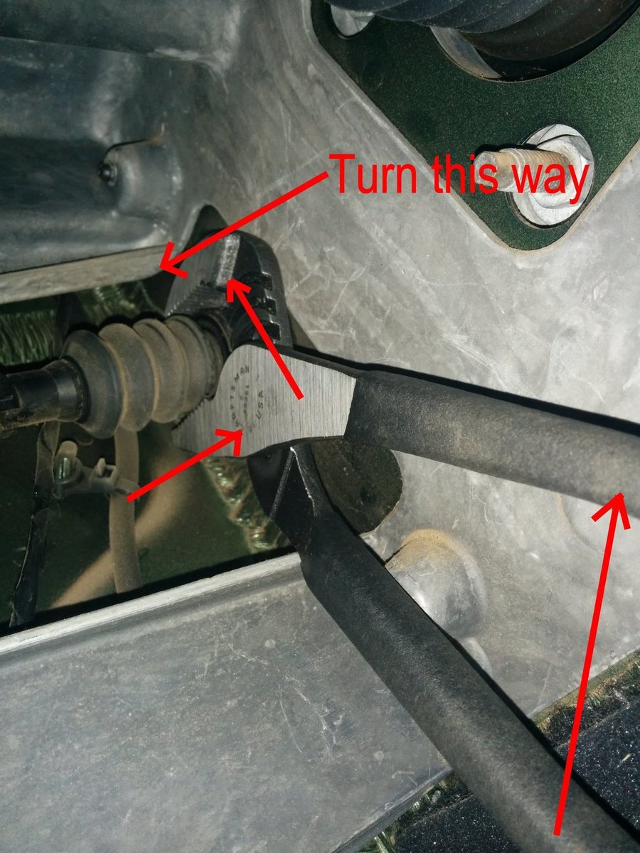

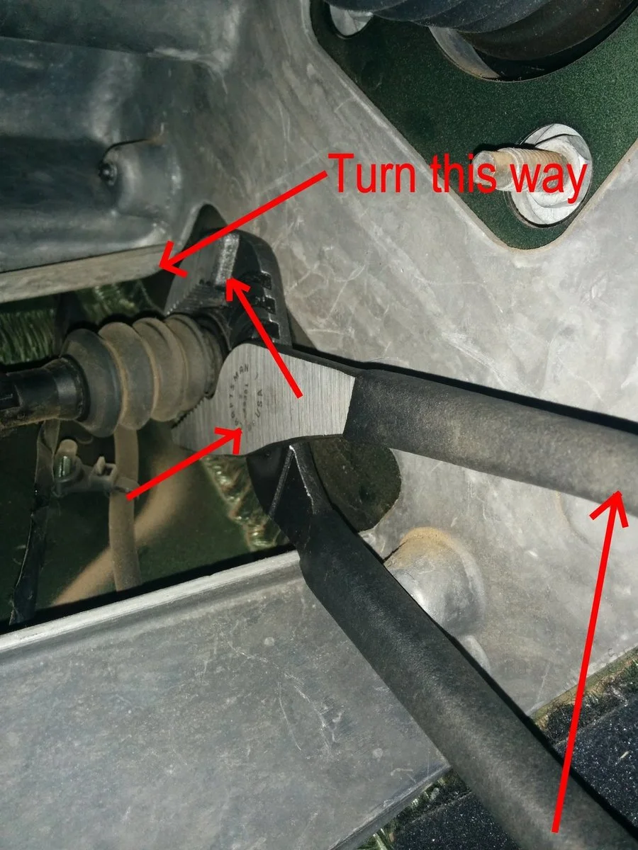

Using a pair of channel lock pliers, rotate the clutch master cylinder from under the dash in the direction shown. If you rotate it the other way, it's easy to break the stop tabs. But, the slave cylinder is keyed in place and will not be able to slide forward to remove--so turn it the correct direction.

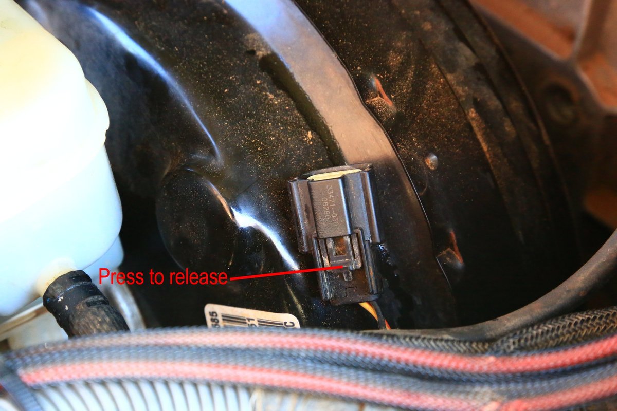

Once the slave cylinder is rotated and pushed back, disconnect the clutch pedal position sensor electrical connector. This is actually connected to another adapter that is magnetically attached to the slave cylinder. If it comes apart there, just disconnect as shown above--your new part has that other adapter.

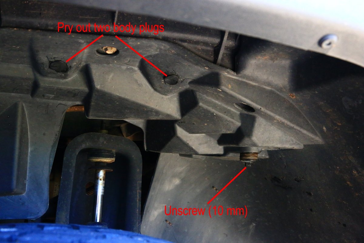

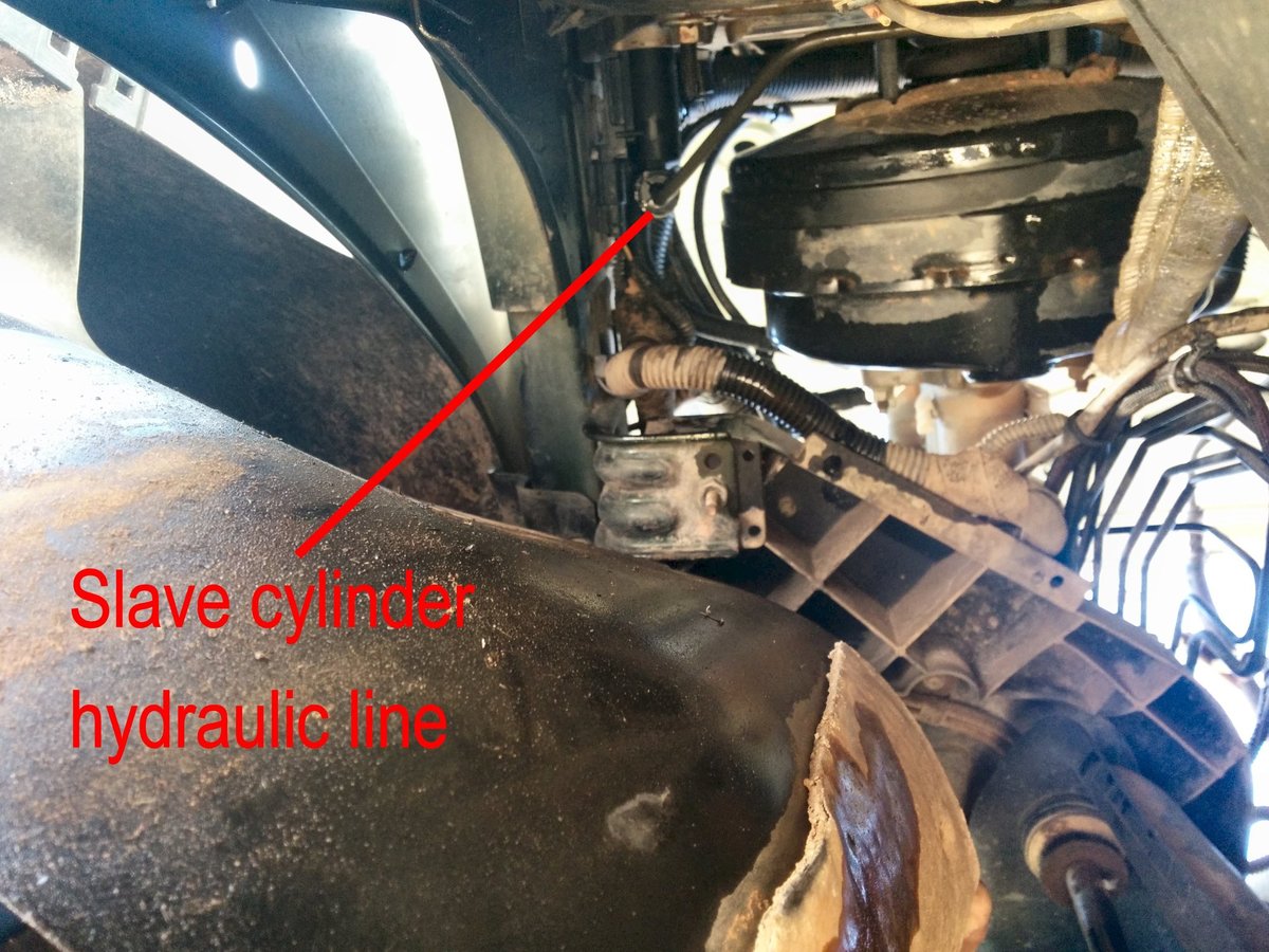

Partway through the job a friend came over and we were discussing how to make the task easier. I mentioned I'd considered pulling the fender, including the inner fender liner, but it was such a hassle and takes those special clips (which I have a few spares of). He said I could probably gain access without removing the entire fender, so we removed the plugs and bolt marked on this image.
That gave me this view, looking up from underneath as he pried out on the fender. From here it was easy to reconnect the hydraulic line to the slave cylinder, which is a very, VERY tight fit. You'd think if not fitted properly that the clip on the master cylinder would not slide into place, but such is not the case. It will slide into place and you'll have brake fluid squirting all over when you press the clutch pedal.
