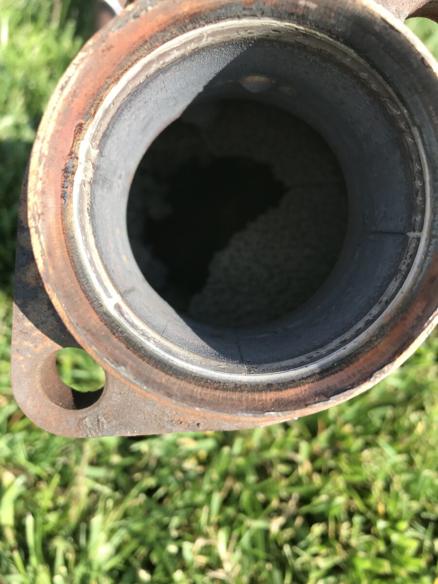

My 08 started running rough only after about 13 miles of driving. I pulled the codes and they were for egr valve and cyl 6 misfire. I changed the egr valve and both the plug and wire on cyl 6 as thats all i had time for. Could this possibly be a catalytic converter issue? It runs fine on a cold start in the morning but is rough running bye the time i get to work.
