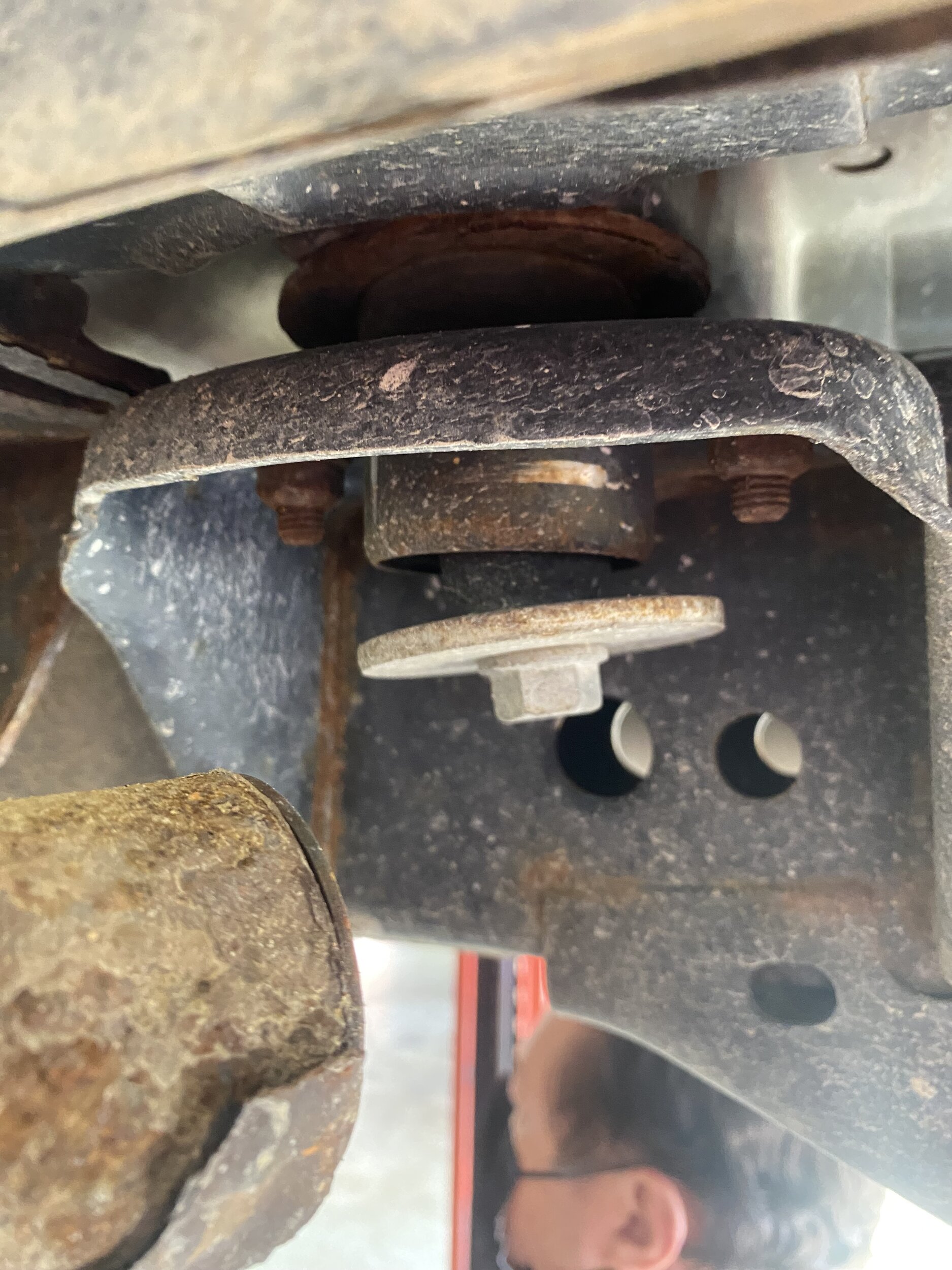

So today I took it to a local shop an asked for an opinion. When it was up on the hoist he noticed the vibration was coming from a bad transmission mount. he also noticed that the body has shifted on the frame so the body mounts are bent (I attached a pic of on of the mounts as an example.

my question to you is this body mount issue something that is a big deal or is it something that doesn't necessarily have to be repaired? if it does require repairing how long do you think the jeep would be out of commission for? I have a trip I will be taking with the jeep soon so I'm trying to figure out where stand with this being safe to operate with the body mounts the way they are in the pic.

The body's not going to fall off but if the mount bolt is loose you'll have a noise coming from there when hitting bumps probably. Are all the body mounts like the one in the picture?
The ones on the driver's side were like that (at least 2 that I saw) and the passenger's side ones seemed pretty decent and straight from what I could tell. I plan on getting any damaged body mounts repaired through insurance so just hoping it wont take too long for them to get it done at this point. It doesn't seem like anything I need to worry about safety wise until that happens at least.
