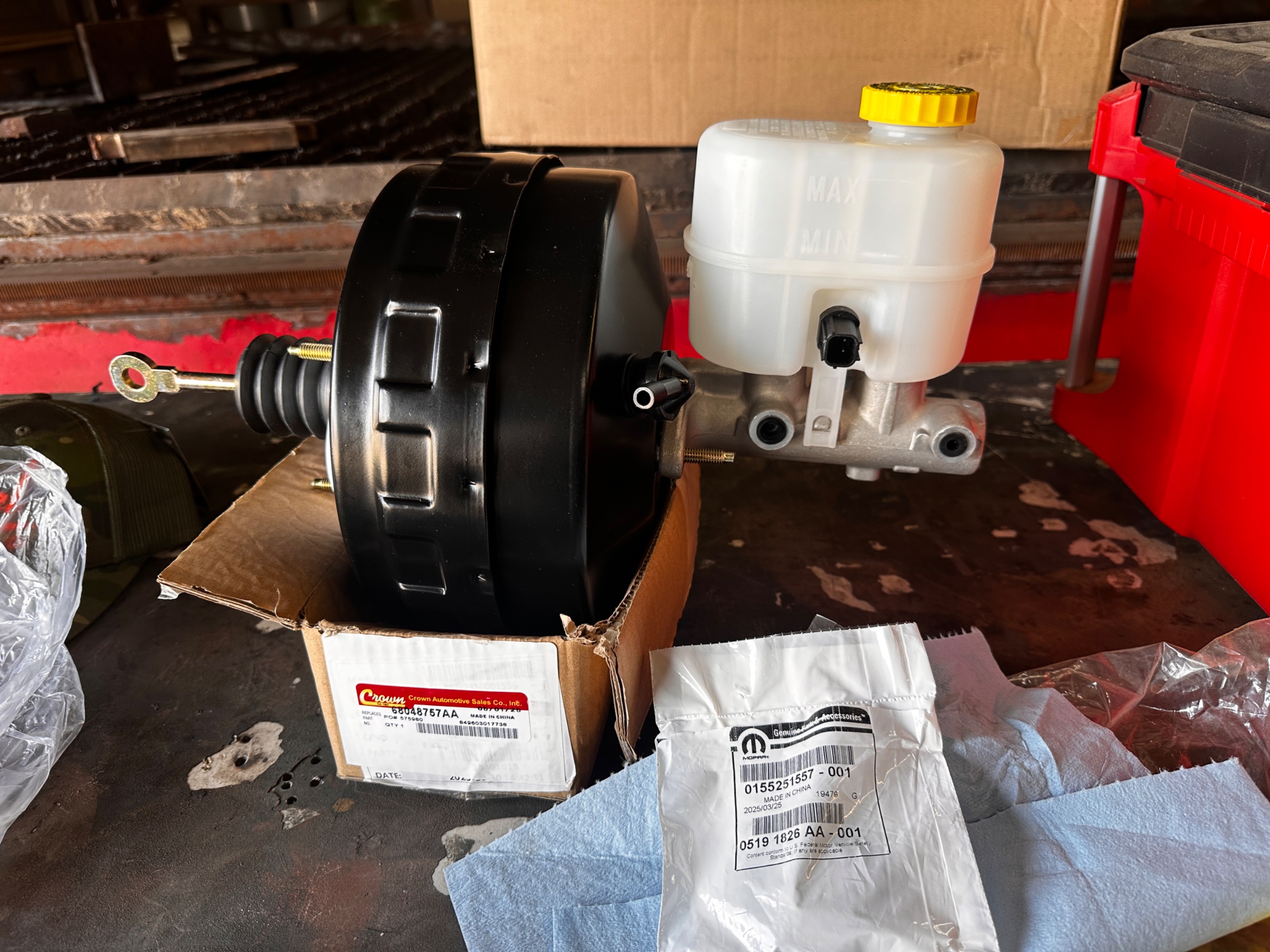

Looking for some info on the J8 booster upgrade.
I bought a J8 booster from Jeephut. Full master cylinder and booster kits are hard to find, so i bought just the booster. Can I swap JUST the booster? or is the OE master cylinder different and will not work with the new J8 booster?

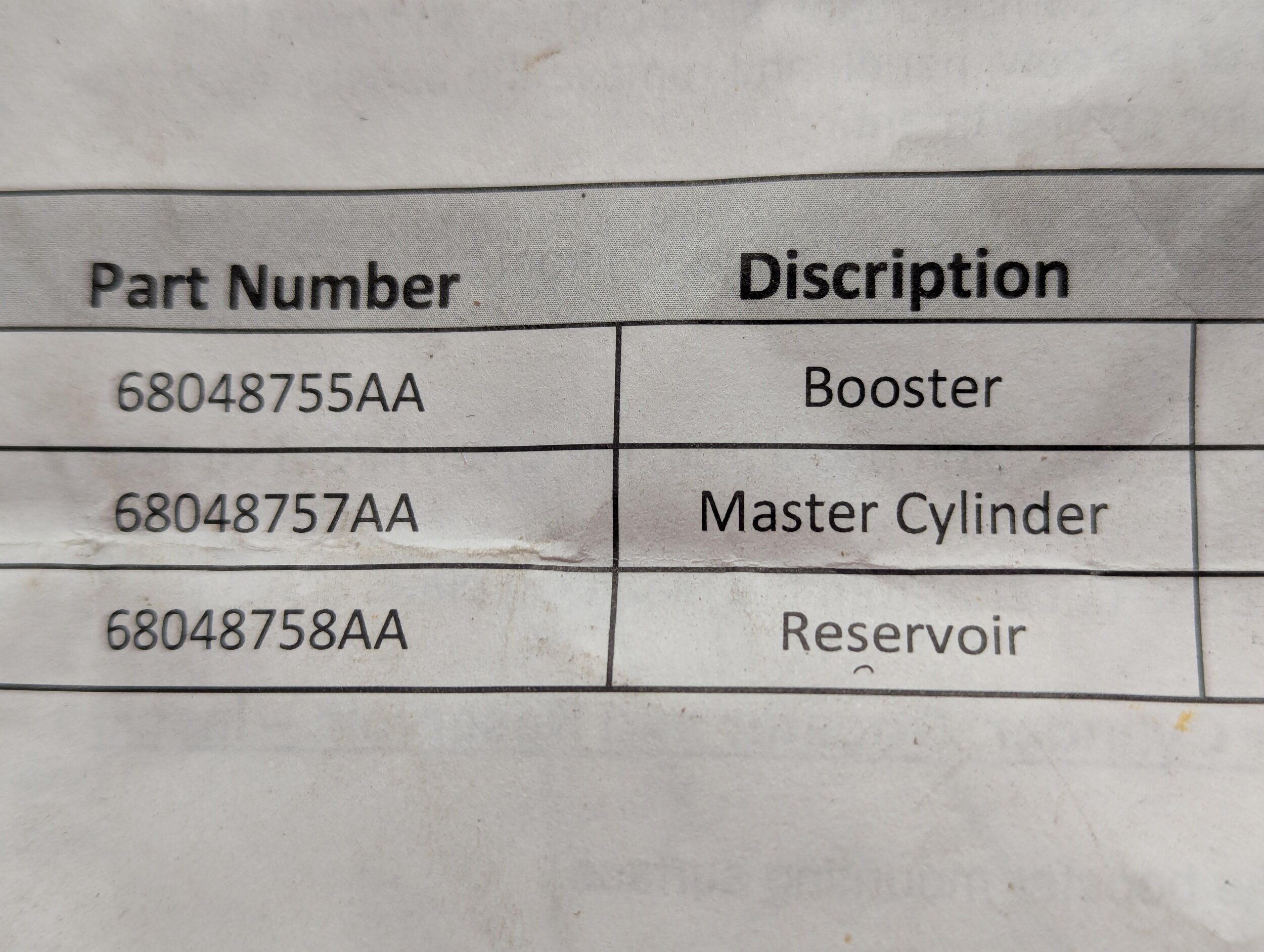

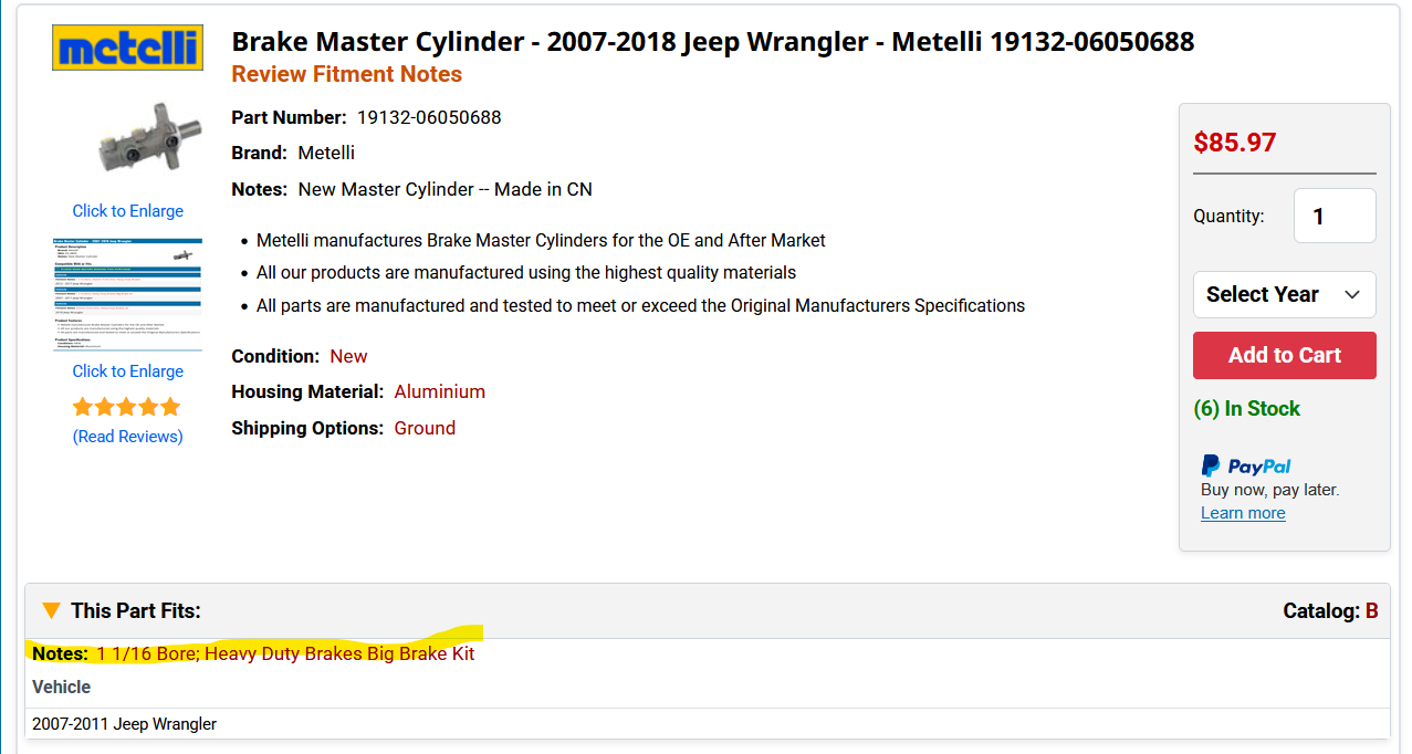

Ok I read the questions. Can I buy a replacement master cylinder? Anyone have a breakdown of the parts that are included in the kit?
I found this part number for the master cylinder, the source is 50/50 reliable. My local auto supply cannot find the number.
68048757AA
