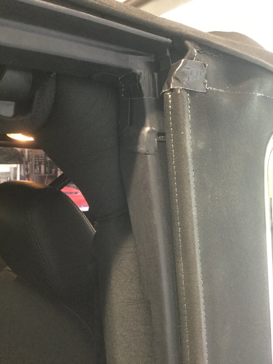

no leak but i notice where the side window wraps around the door always flaps and pulls out of the jamb. Happens on both sides. the top is 3 years old but was just installed for the first time a few weeks ago. Is this a common problem?
I can add some velcro along the jamb. For today I put a few pieces of tape on it.
I have also ran into this problem a time or two. When putting the windows in I’ve found it beneficial to zip the window about halfway. Set the corners and wrap them in the door jamb. Afterwards, closing the door to set it and add pressure. Then finish zipping the window and velcrowing, etc.
i tried this and it seemed to be about the same. I ordered 10 feet of industrial strength velcro and will add a strip to both sides. That should cure the flapping...i hope.
