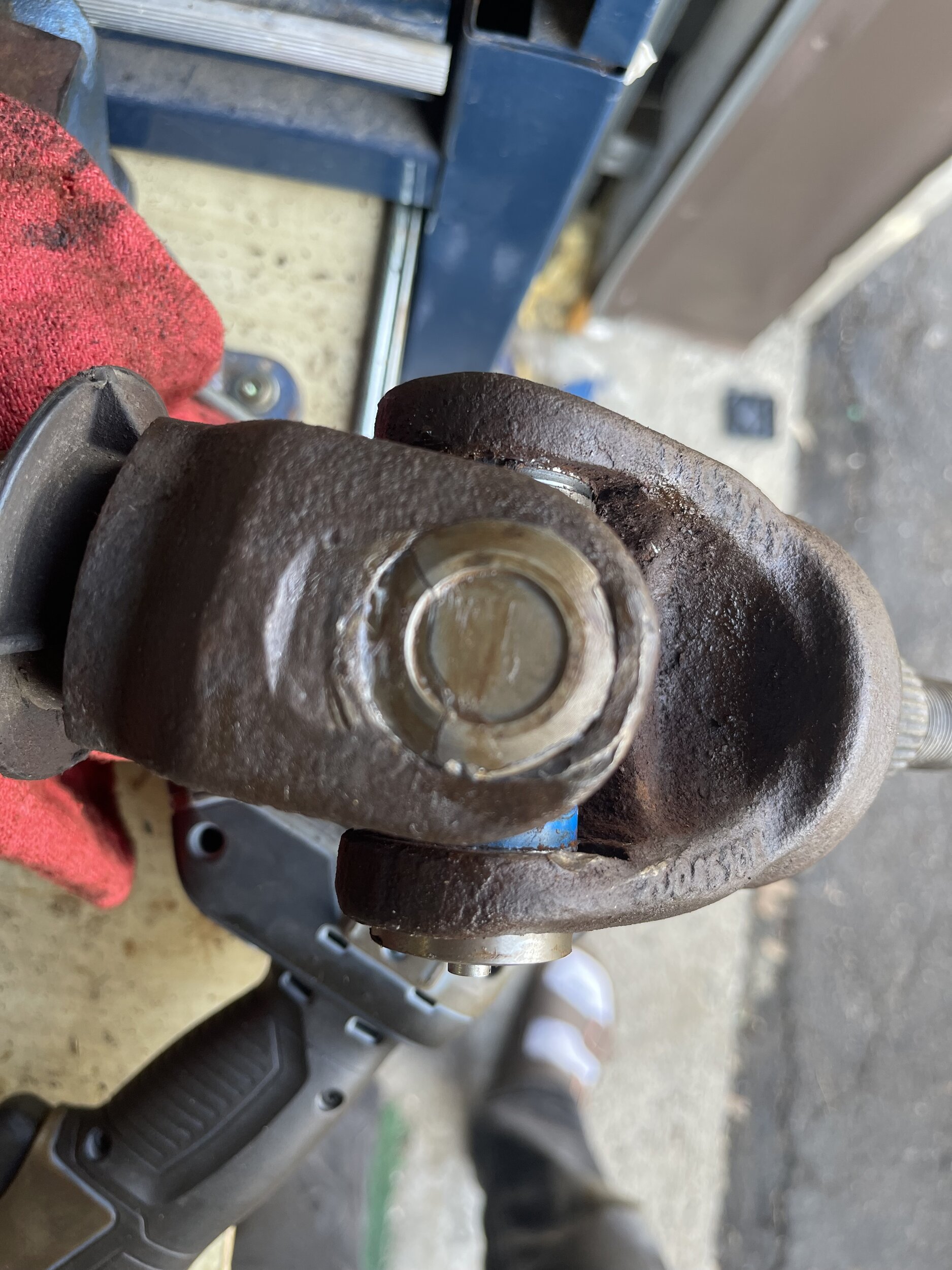

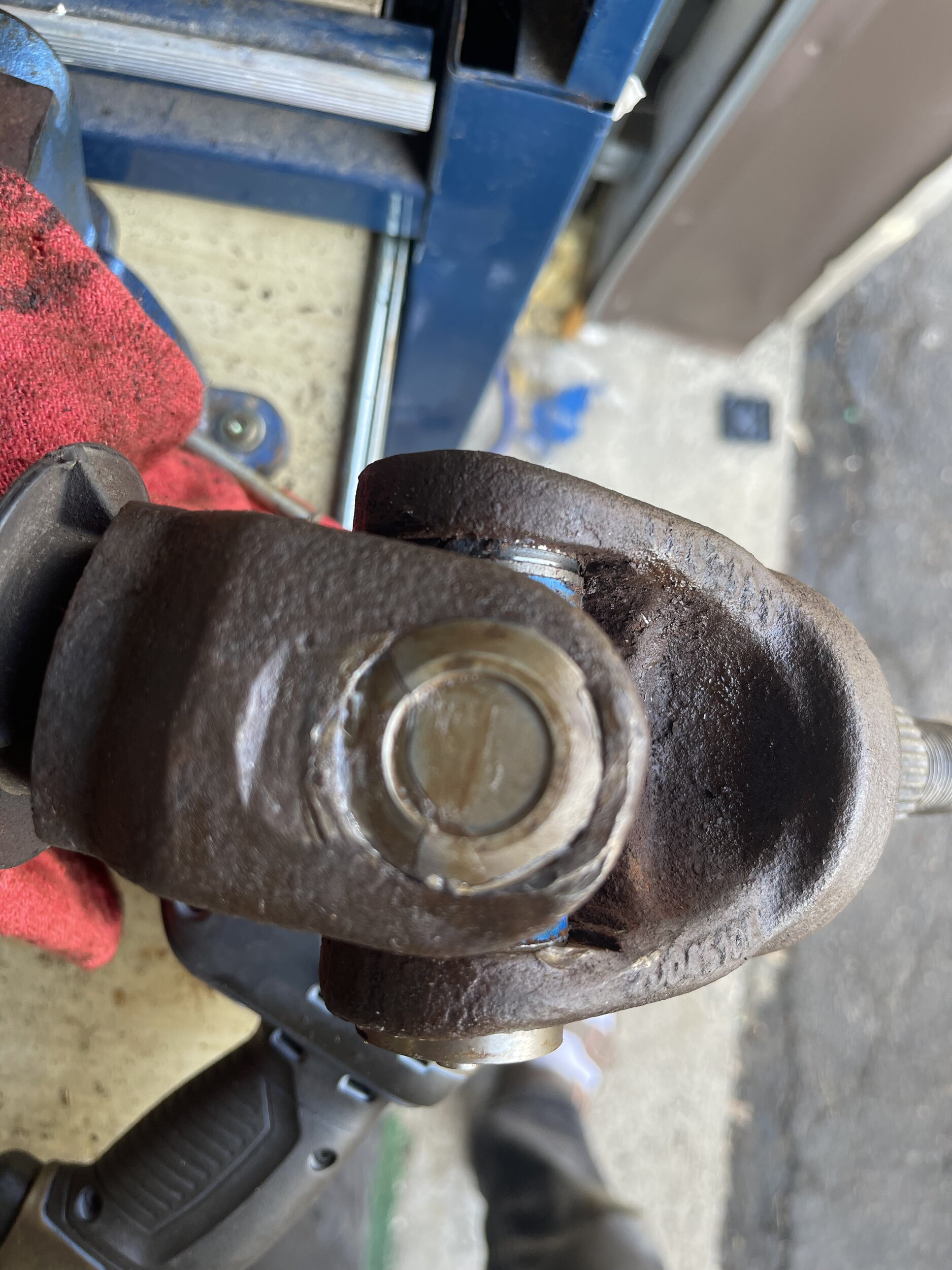

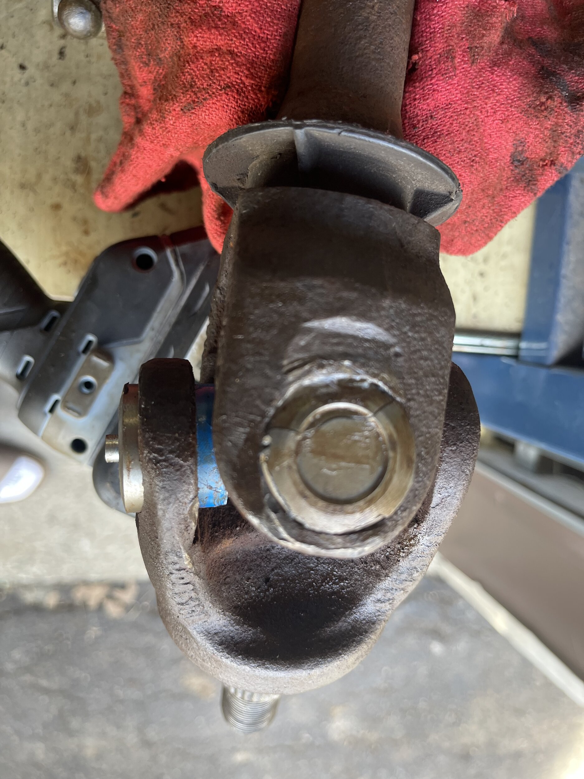

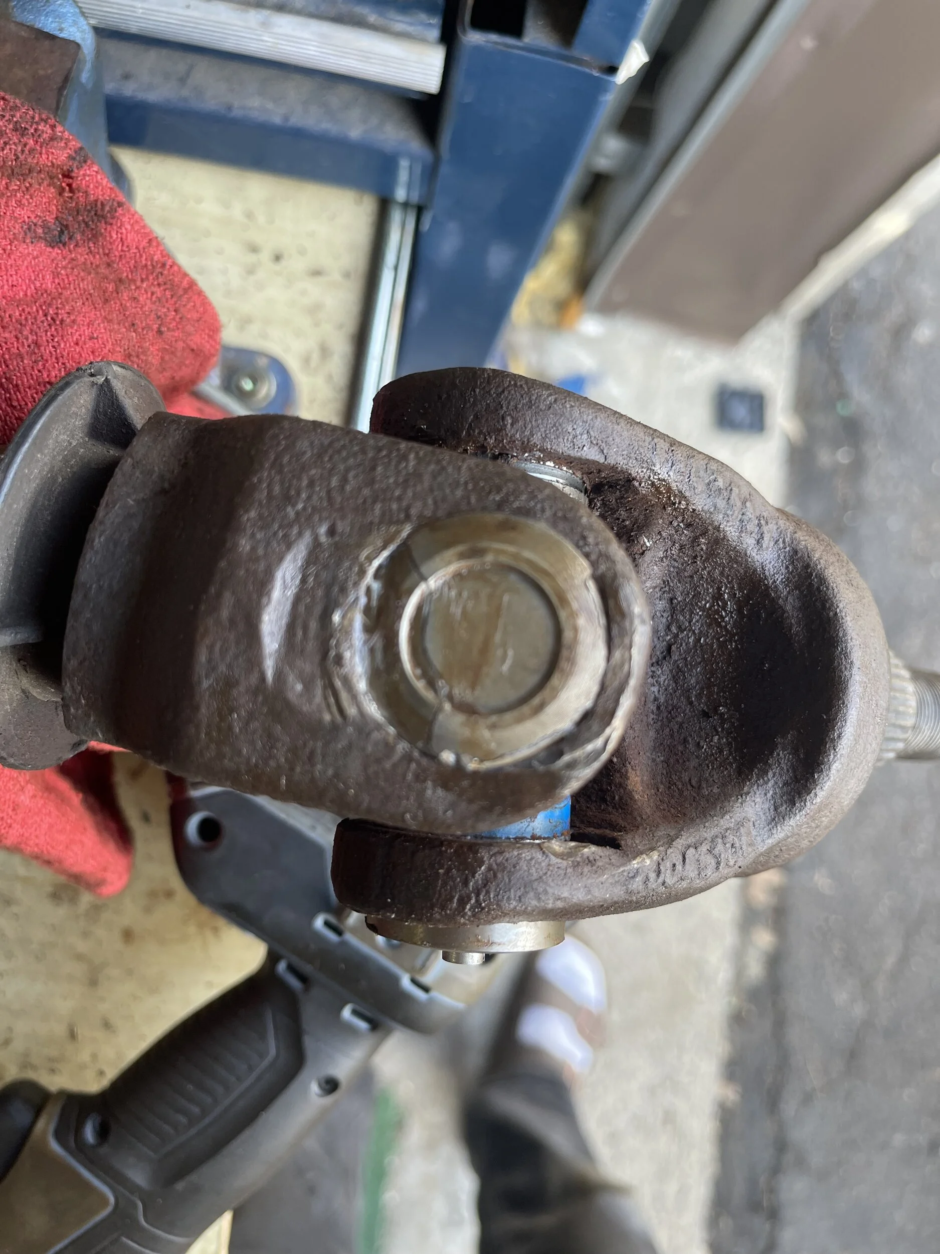

I wouldn't use inside each of those caps are about 75 pins once one falls out they keep falling out then you will experience severe vibration and a good chance of the shaft dropping too the ground
