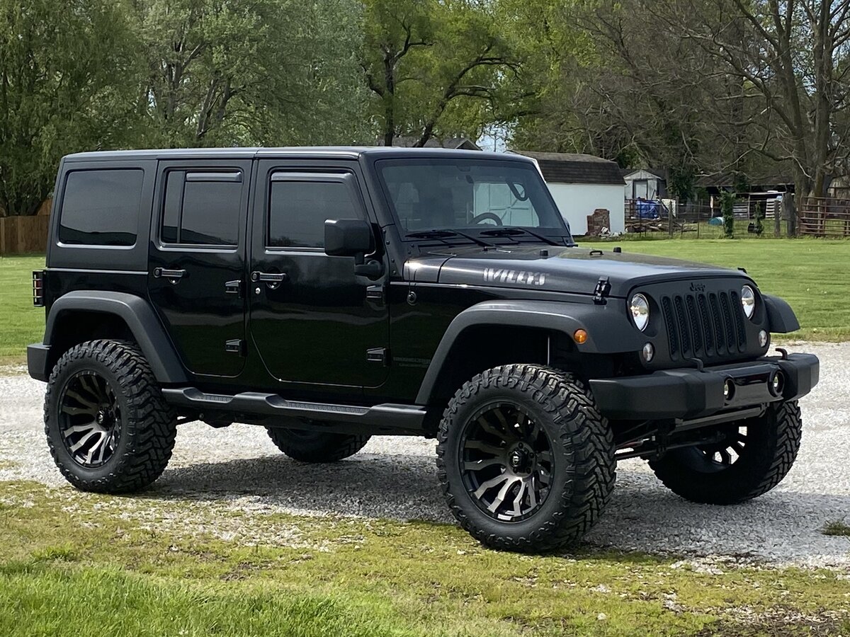

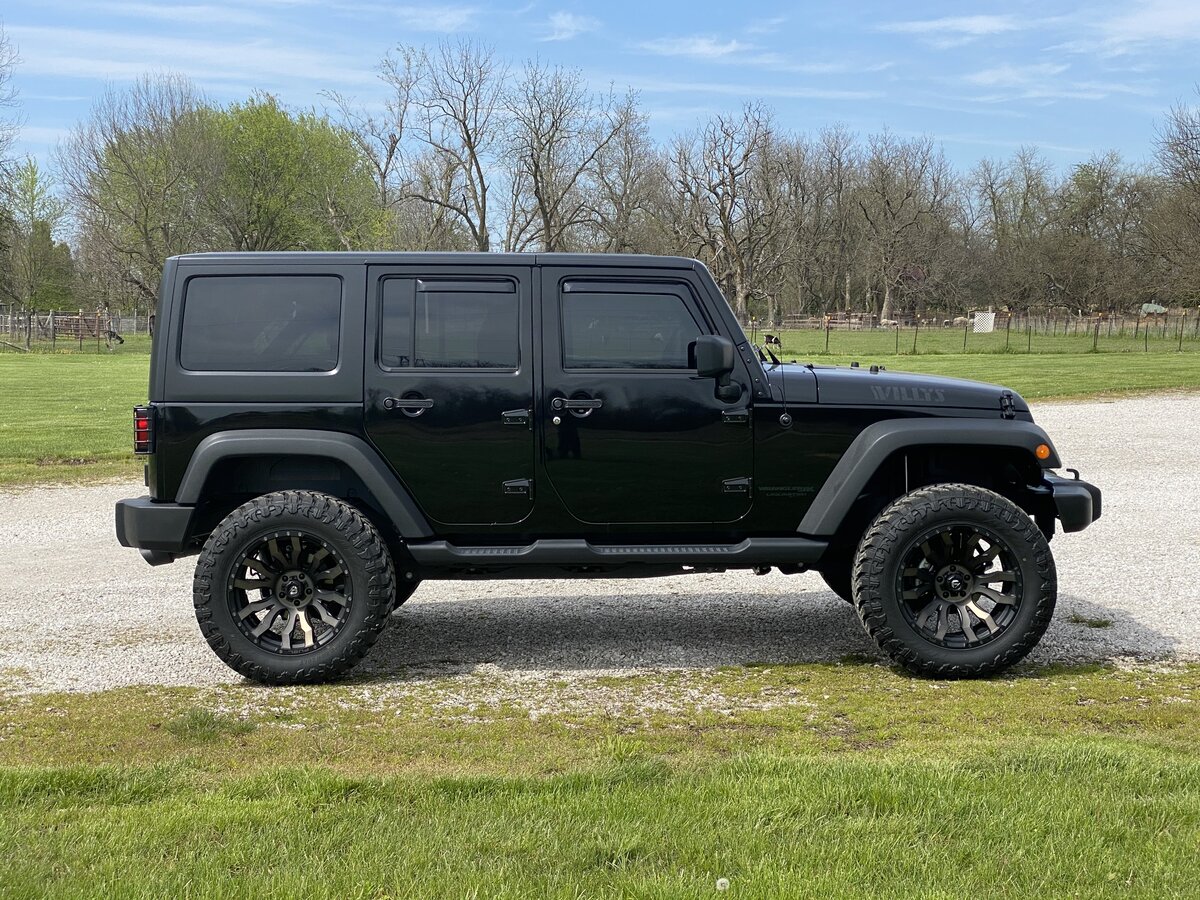

I am very happy with my rough country 3.5” lift and steering stabilizer. Honestly I can afford any lift but I didnt need a $5000 lift for what I do. You could buy the best lift kit in the world and someone will tell you its crap. The ride is amazing and the shocks are great. Dont listen to the so-called “experts”.
