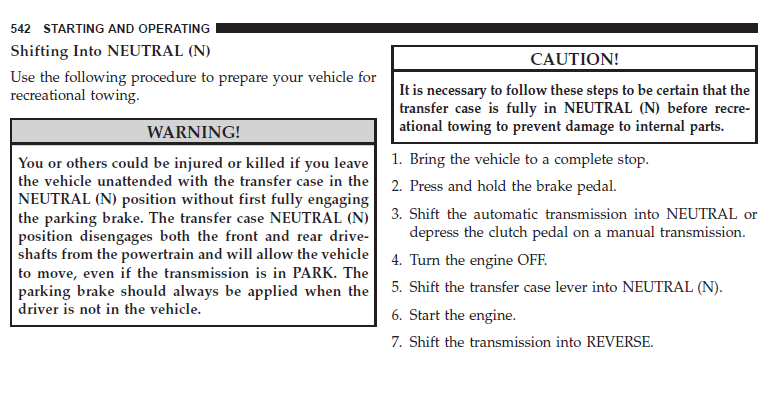

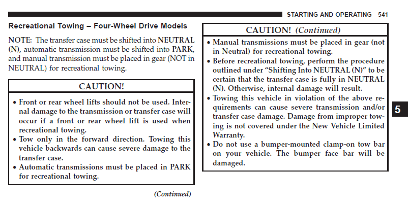

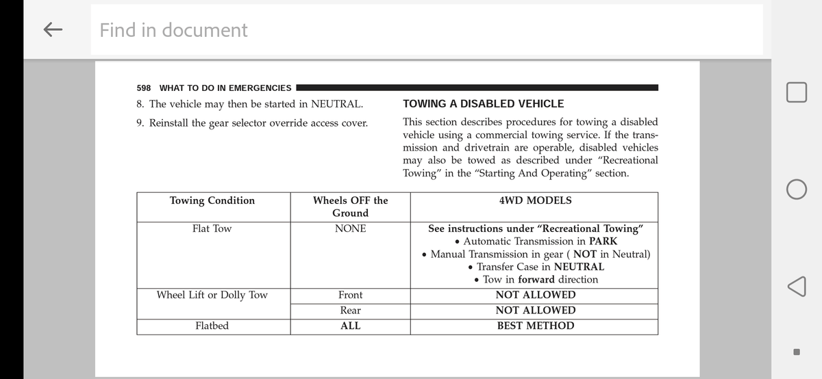

<blockquote data-quote="JeepJeezy" data-source="post: 445831" data-attributes="member: 21715"><p>You tow in park so the transmission fluid doesn't burn up. Some vehicles actually need an aux pump to keep the fluid flowing while in tow. I just checked and I was able to shift the transmission into park with the transfer case in neutral. You do this with the key on acc and the engine not running.</p></blockquote><p></p>
[QUOTE="JeepJeezy, post: 445831, member: 21715"] You tow in park so the transmission fluid doesn't burn up. Some vehicles actually need an aux pump to keep the fluid flowing while in tow. I just checked and I was able to shift the transmission into park with the transfer case in neutral. You do this with the key on acc and the engine not running. [/QUOTE]
