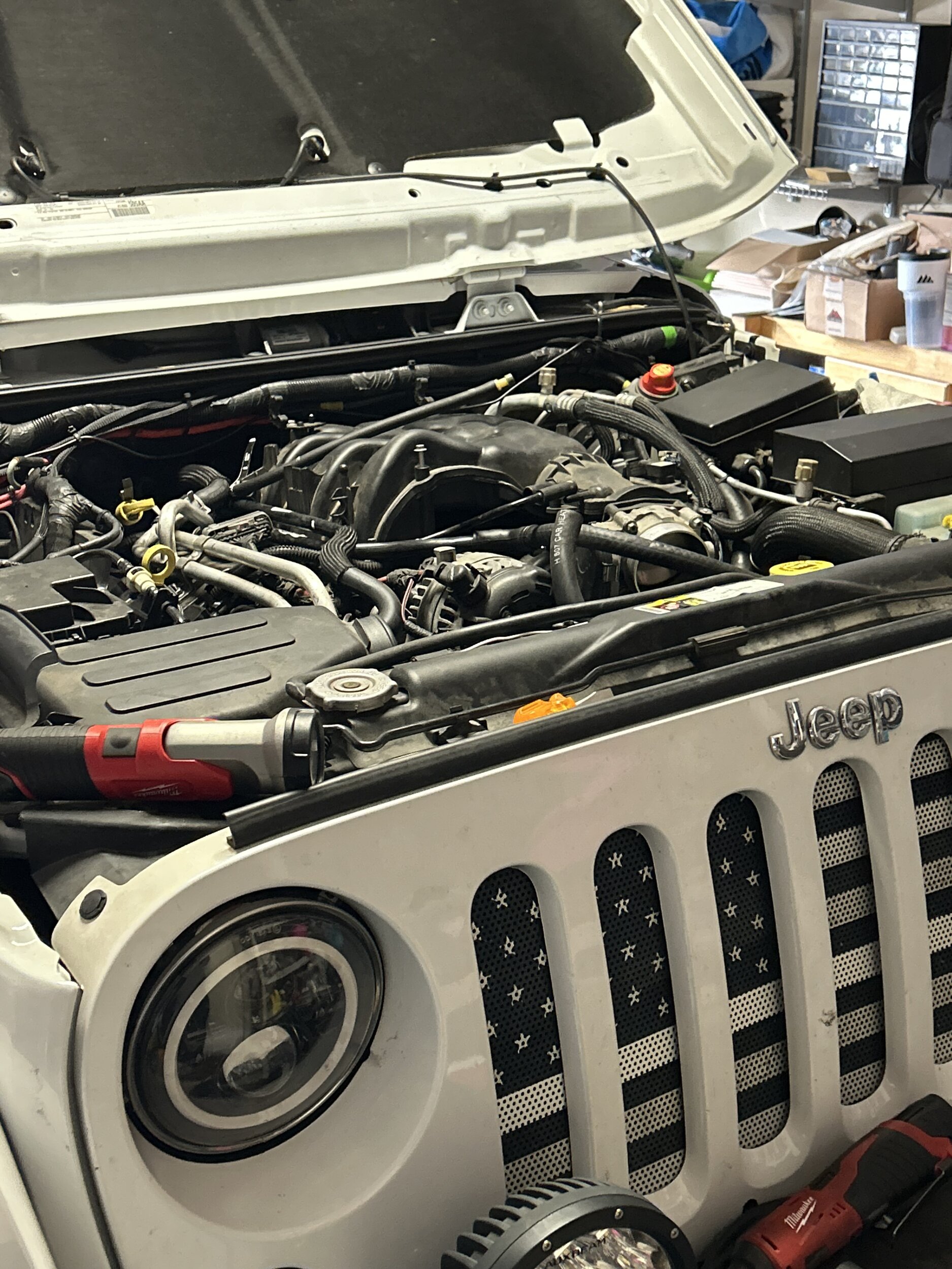

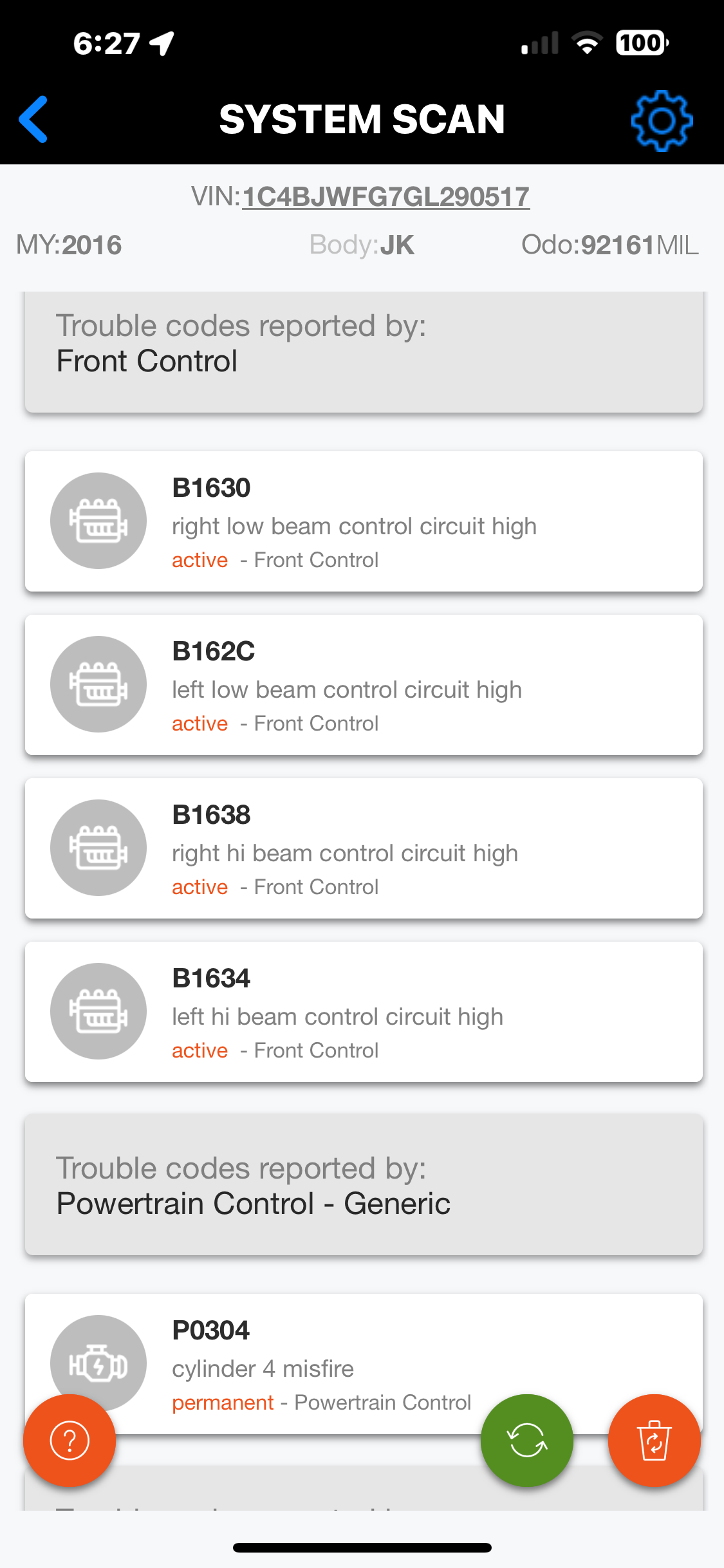

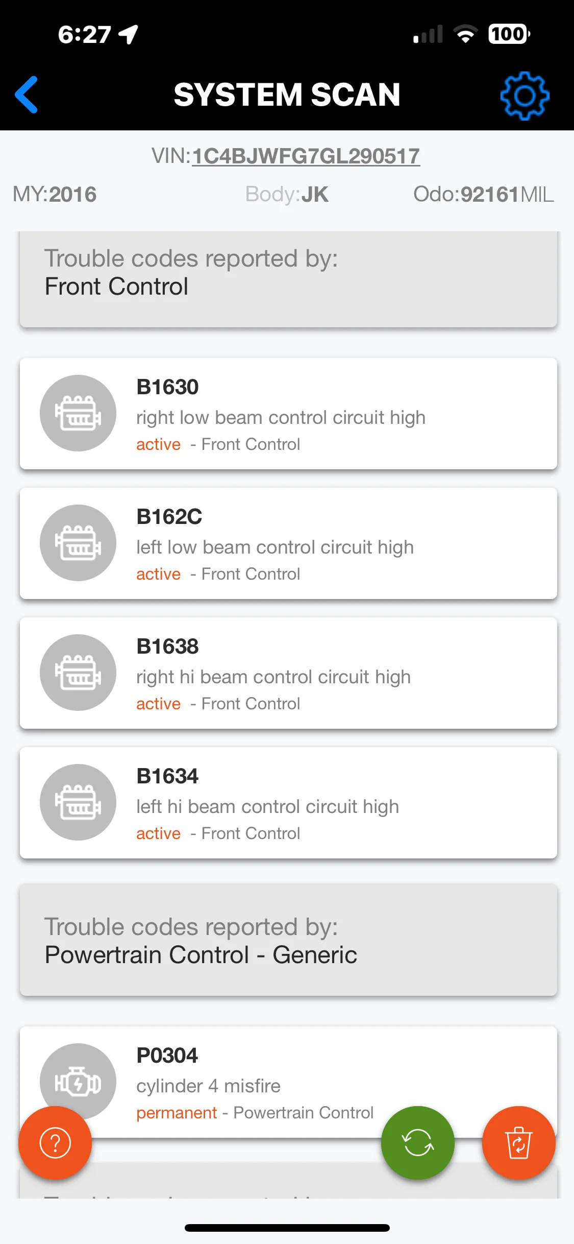

Replaced plugs, coils and upgraded the injectors. The light goes on, I clear it with a JScan…a week and ~200miles later it’s back.
Runs super smooth but I’m perplexed what next?
Pix for attention…

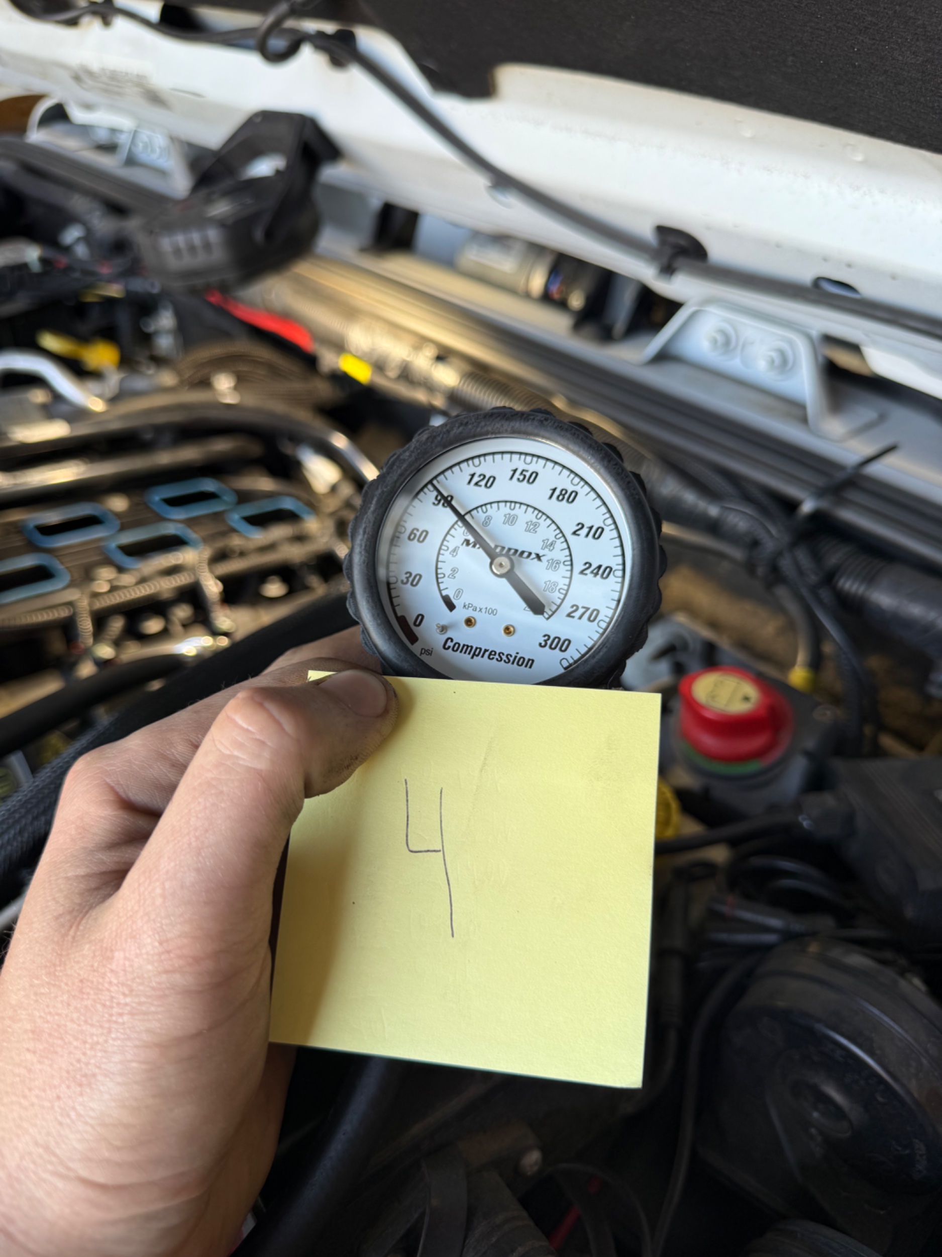

I recommend examining the wire harness at/around cylinder #4.
If you feel ambitious, consider swapping the plug and coil pack from #4 w/ another and see if the misfire remains on #4.
I would also consider doing a compression/leakdown test.

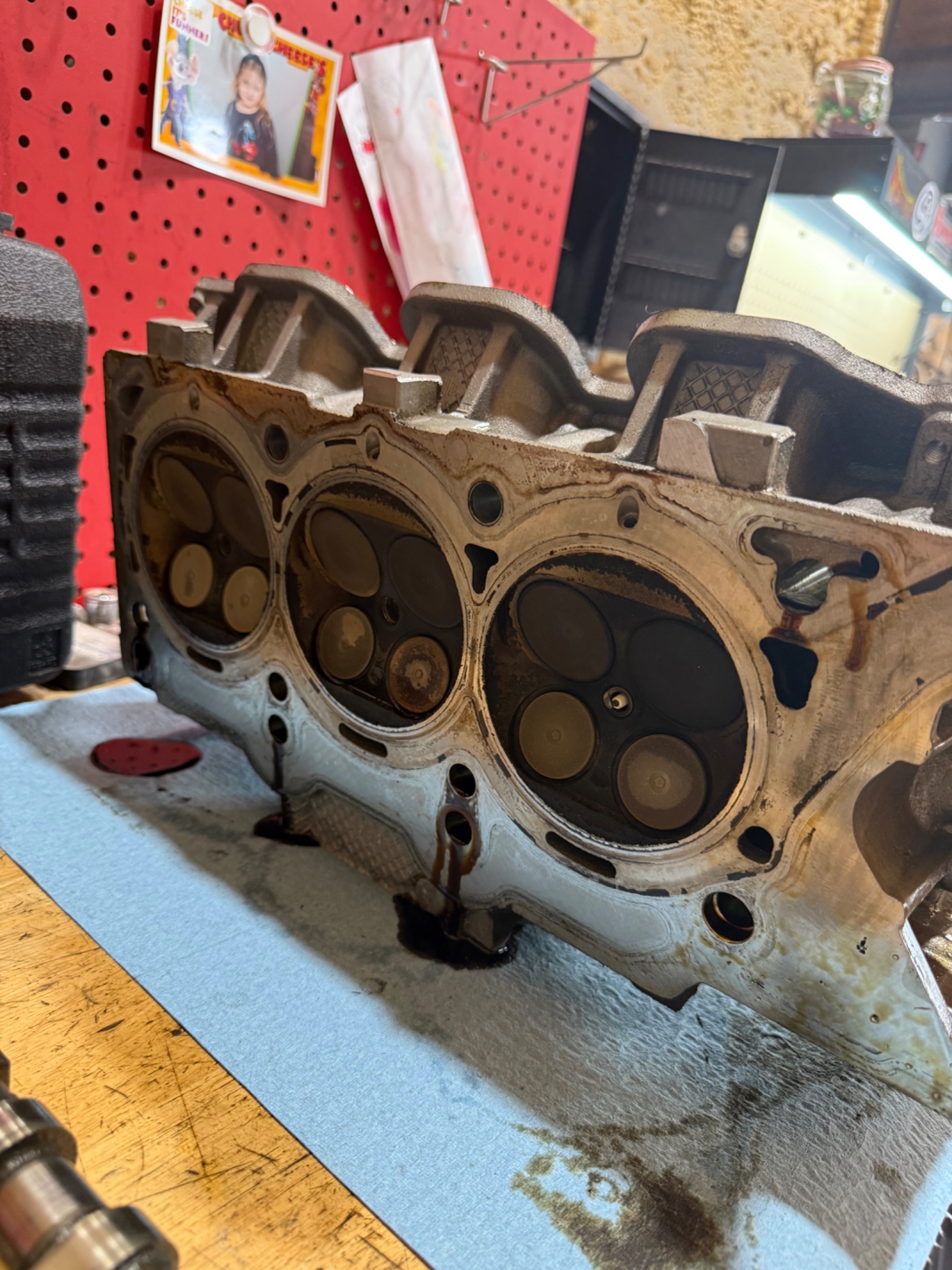

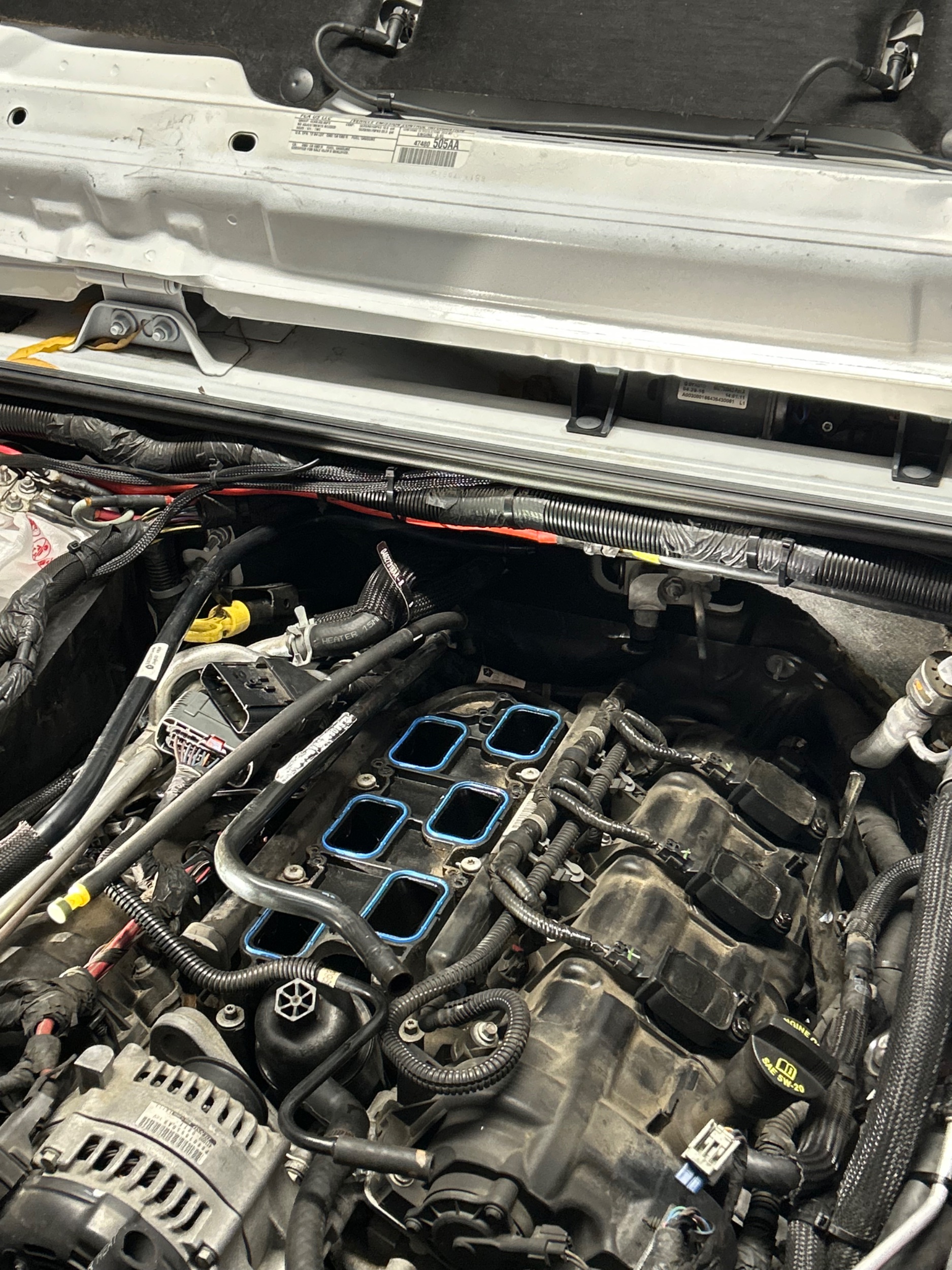

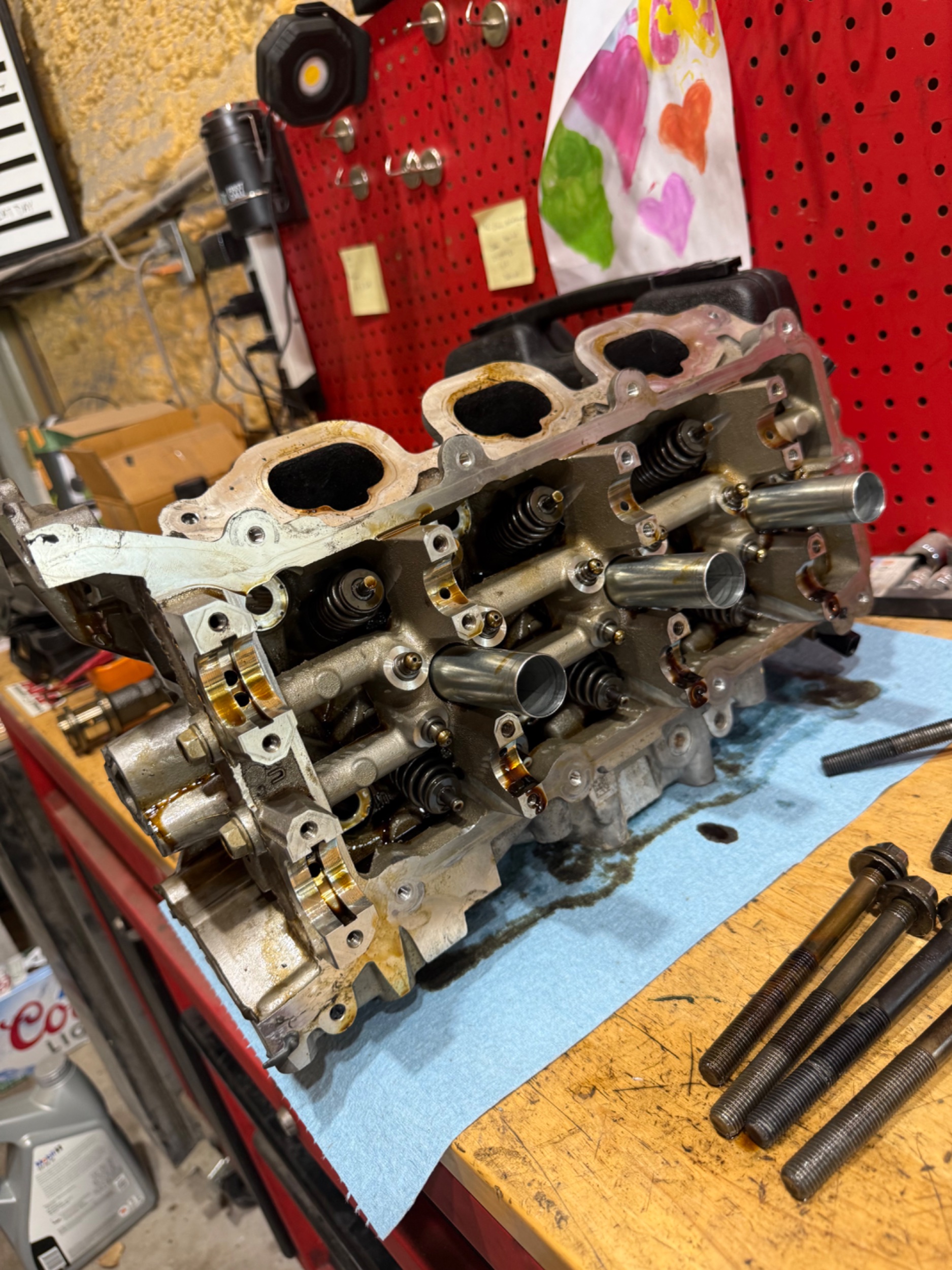

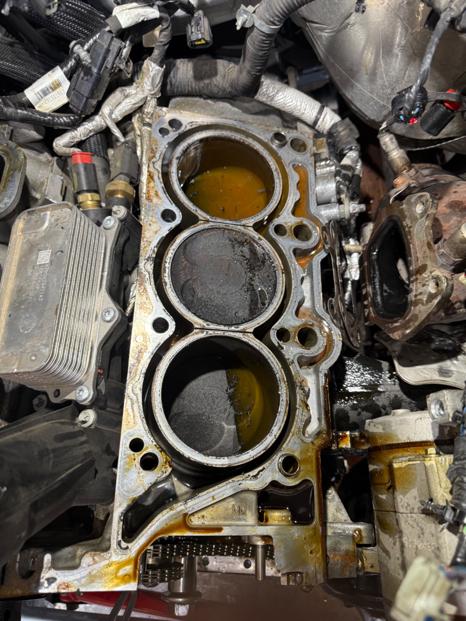

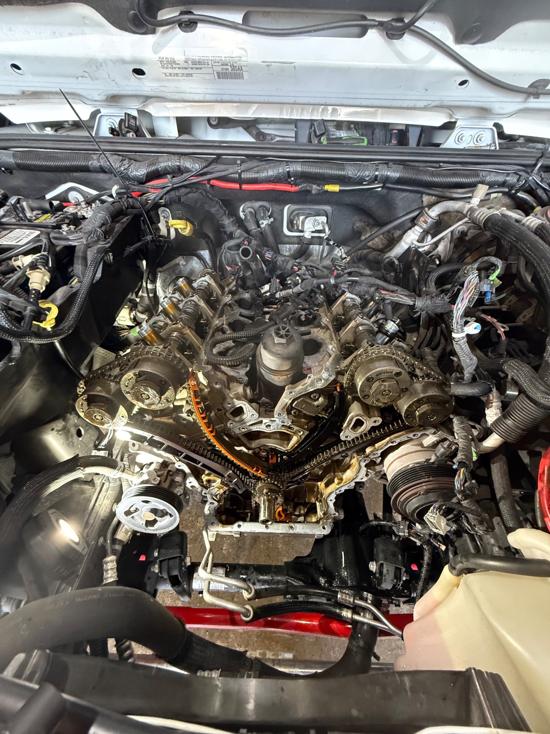

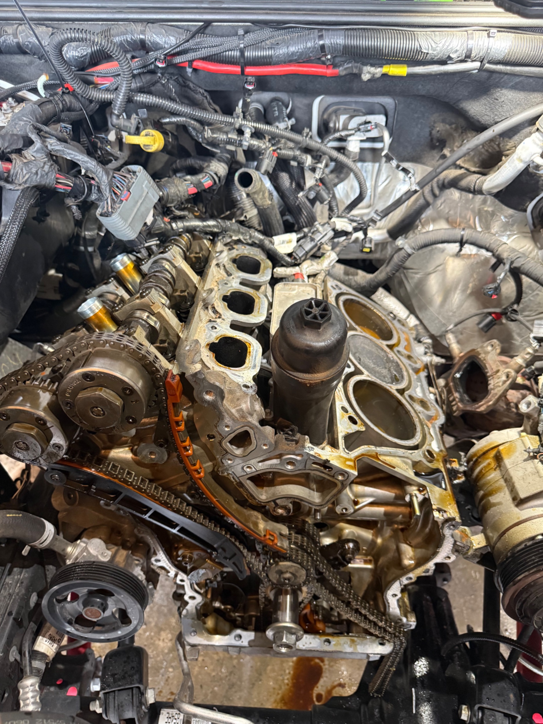

Well, it’s been a while but thought I’d follow up.
Cyl 4 has a valve that won’t close all the way so it’s not holding compression.
So after some serious emotion annd strings of four letter words coupled with disbelief, I’m going to pay a few grand to have it fixed. I’m all in and a new motor is too expensive, and a few grand isn’t even 6 months of car payments so…
I’m just shocked really. I bought her used with 70k-ish miles and don’t rag on it. I’m the second owner, but I’m absolutely shocked that an engine would lose a valve with only 93k miles.
