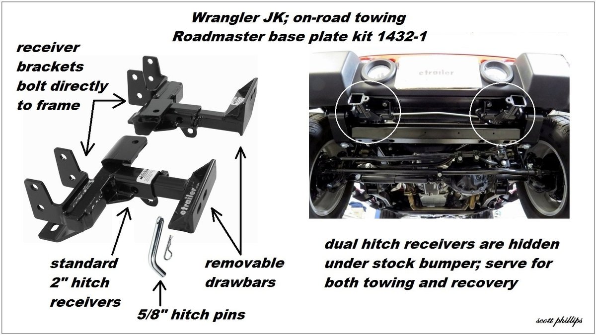

Step 1 – Install towing base plates
  • Base plates can be used with the stock Wrangler bumper.
  • The removable draw bar extensions are pinned into standard 2", Class 3 receivers.
  • With the draw bars removed, the dual receivers are mostly hidden under the front bumper.
  • The dual receivers also serve as strong recovery points for D-ring hitch adapters.
For detailed information and instructions see eTrailer.com's base plate for tow bar.
Figure 1. Roadmaster base plates.

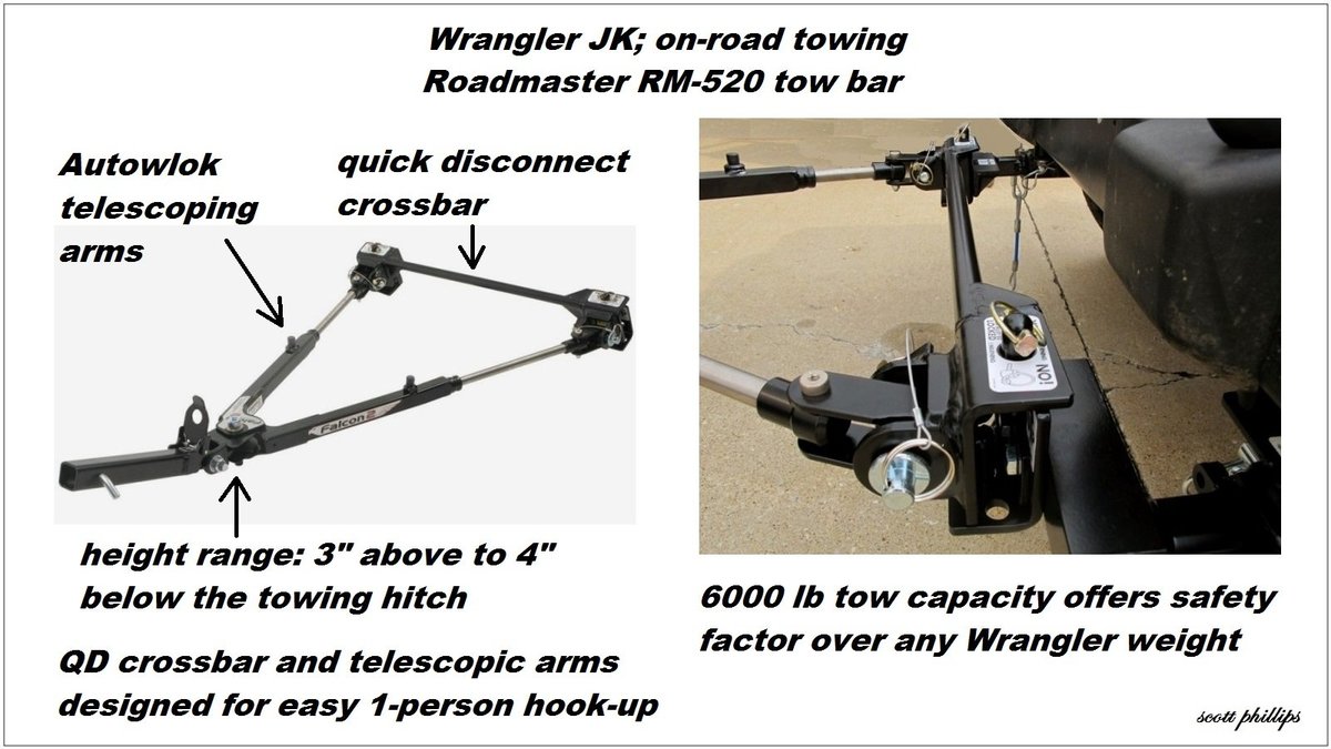

Step 2 – Tow bar
The Wrangler JK line weighs 3,800 to 4,500 lbs and requires a Class 3 tow bar rated to pull 5,000 lbs. The Roadmaster Falcon 2 is rated for 6,000 lbs and mates to the Roadmaster base plates. It can be hooked to the Wrangler in minutes by one person. The Autowlok telescoping arms allow variable reach to the Jeep bumper and the quick disconnect bar pins into place. When the tow vehicle begins moving, the arms lock rigidly.
For details, see eTrailers.com's two bars.
Figure 2. Roadmaster Falcon 2 tow bar.

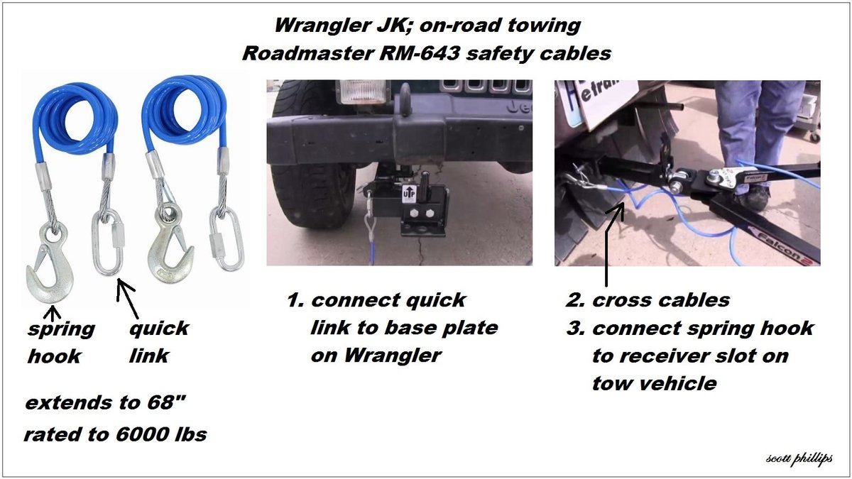

Step 3 – Safety cables
The safety cables prevent separation if the hitch fails. The quick link is connected to the frame mounted base plate on the Wrangler and the spring hook is connected to the slot in the tow vehicle's receiver. The coils keep the cables from dragging and the vinyl sheath won't scratch the tow bar. The cables are crossed to help limit the Wrangler's lateral motion if the hitch breaks. The Roadmaster RM-643 galvanized cables are rated to 6,000 lbs and extend to 68".
For details, see eTrailer.com's accessories and parts.

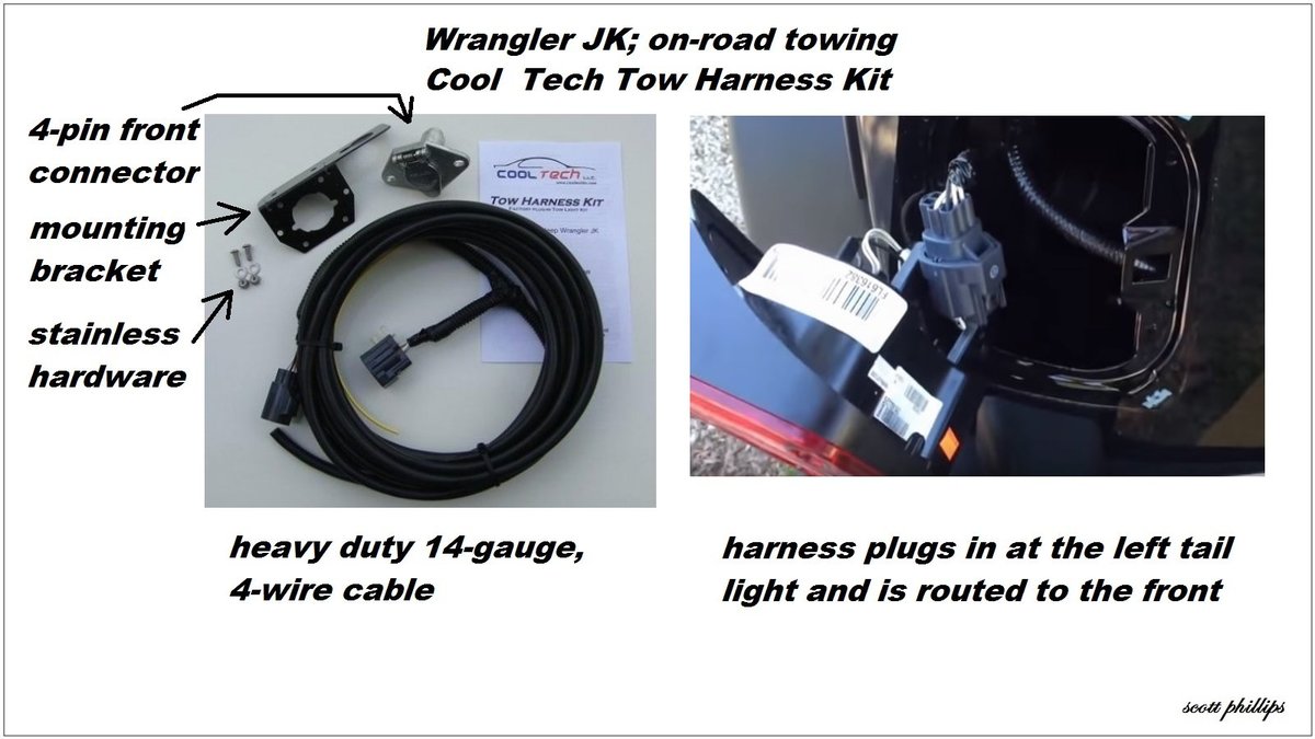

Step 4 – Tail light wiring harness
For occasional towing, temporary magnetic lights can be attached to the rear of the Wrangler and the wiring routed up to tow vehicle. However, the best solution for regular towing is to operate the Wrangler's own lighting system by connecting it to the tow vehicle's lights. The Cool Tech JK Tow Harness is an easily installed and well regarded choice; which plugs into the the left tail light connector and is routed to the front, where the umbilical connector plug is mounted near the base plate hitch receivers. The Cool Tech harness will illuminate tail lights, brake lights, turn signals and side markers.
For more information, see CoolTechllc.com's parts and accessories.
Figure 4. Cool Tech tow harness kit.

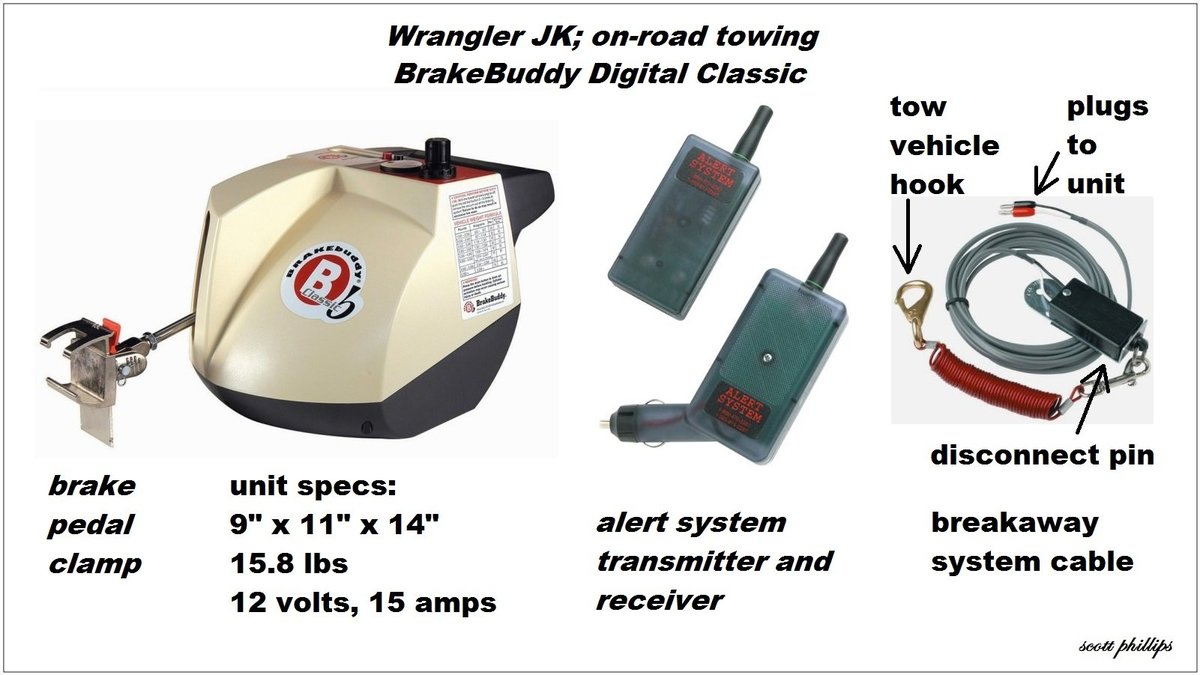

Step 5 – Supplemental braking system
Towing requirements vary by state with some mandating supplemental braking on all towed vehicles, and others graduating the requirement by towed vehicle weight. However, it is always wise and prudent to tow a 4,000 lb Wrangler with a supplemental braking system, including an emergency breakaway detector. As with all things Wrangler, there are scores of choices with different means of operation.
The BrakeBuddy Digital Classic is a portable unit that can be quickly switched between vehicles. When it detects forward inertia from the tow vehicle slowing, it uses compressed air to modulate an arm that acts directly on the Wrangler's brake pedal. It uses power from the Wrangler's battery operated power outlet and it will activate the Wrangler's own brake lights during braking. It does not, however, operate the tail lights or turn signals. The BrakeBuddy comes with a breakaway system that will stop a loose Wrangler and a wireless receiver in the tow vehicle to let you monitor its operation.
For detailed instructions, see BrakeBuddy.com
Figure 5. BrakeBuddy Digital Classic.
