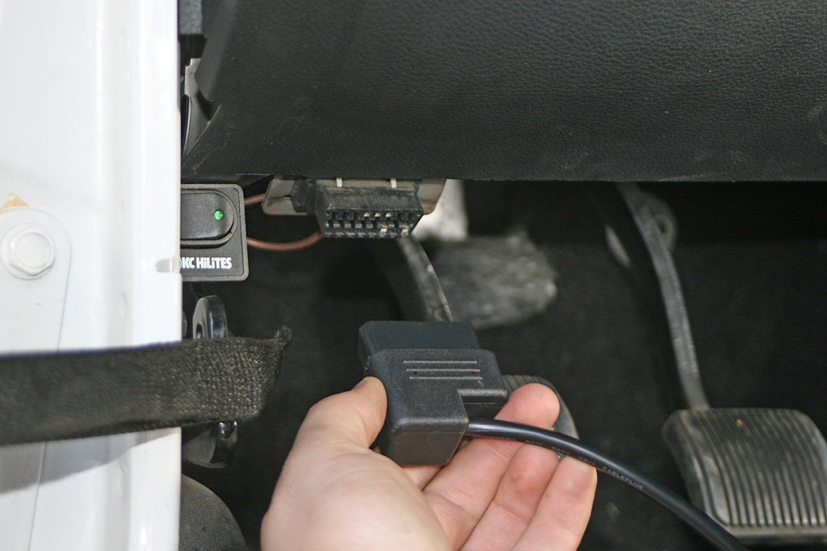

  • Connect your OBD-II scan tool or code reader to the diagnostic port located under the driver's side dash.

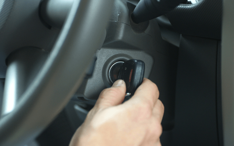

  • Turn the key to the ON position without starting the car.
  • Push the key into the ignition cylinder (towards the steering column) and, while holding it in, turn the key to the OFF position and back to the ON position three times. Be sure to end with the key in the ON position.
Figure 3. Cycling ignition key.

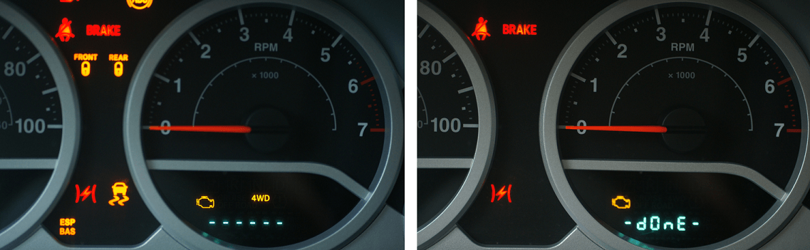

  • If done correctly, all of the dash lights will illuminate and the display normally reserved for the odometer reading will appear as a series of six dashes.
  • The dashes will be momentarily be followed by any stored fault codes.
  • After all fault codes have been displayed, the message will read "-d0ne-" and the key can be turned off.

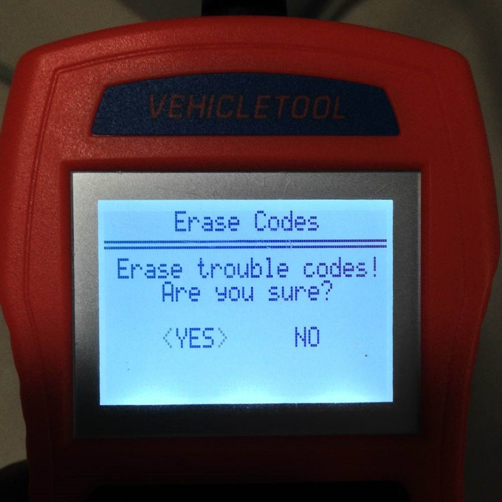

After replacing the faulty component(s), you may once again connect your scan tool or code reader to the diagnostic port and proceed clearing all fault codes. Once the fault codes have been cleared, the vehicle can be started to ensure the Check Engine light is off.

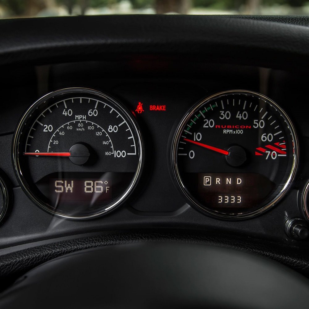

Figure 6. Erasing fault codes.
Figure 7. Gauge cluster with Check Engine light now reset.
