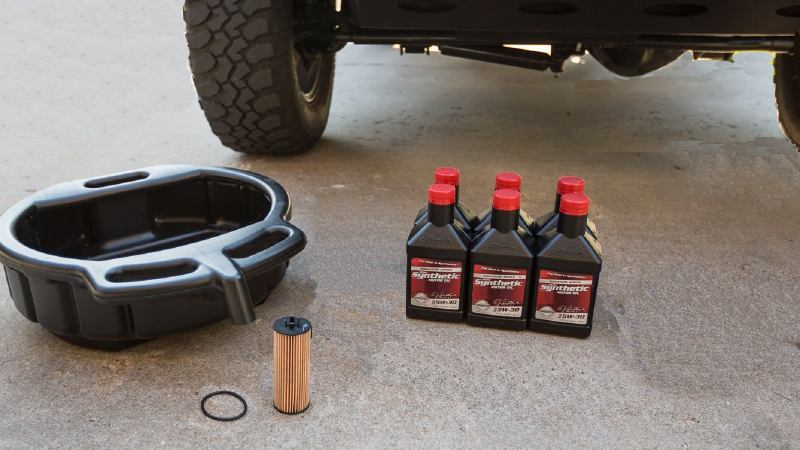

Figure 1. Oil change gear for a Jeep JK.

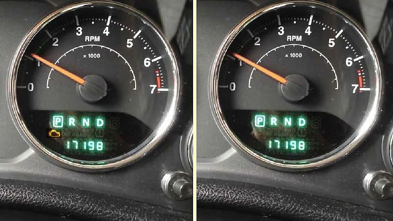

Starting with the 2008 model year JK, the “check engine” engine silhouette would come on to remind the driver it was time to change his or her oil and filter.
Figure 2. Change oil indicator (on left), and cleared (right).

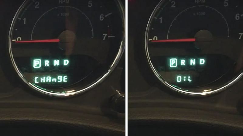

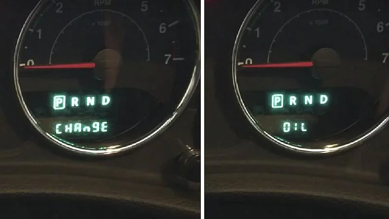

Later models added a text message on the IP. Here, the 2014 Wrangler shows a two-part message that flashes back and forth until the oil change system is reset.
Figure 3. Split message to reset the oil change light on 2014 Wrangler.

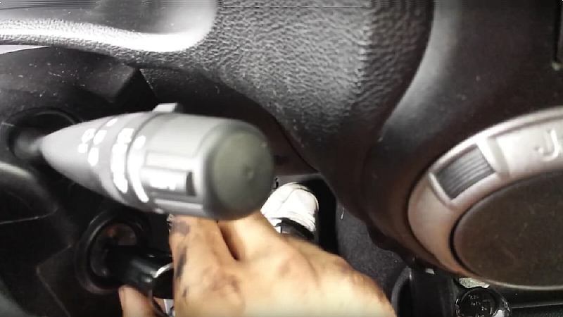

Turn the key to the on/run position, but don't start the engine. With the key in the on/run position and the engine not running, you will hear chimes ringing for a few seconds. Wait for the chimes to stop and the lights that come on for a diagnostic test go off.
Figure 4. Turn the key to the on//run position without turning on the engine.

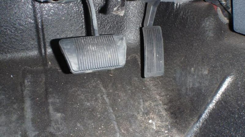

Step 2 – Fully depress accelerator pedal
Press the accelerator pedal fully down three times within ten seconds.
Figure 5. Press the gas pedal down fully three times.
