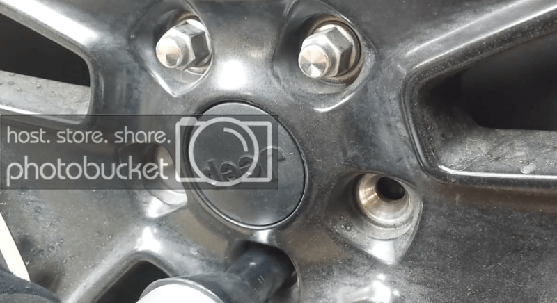

Step 1 – Remove the rear wheel
Take your 19mm socket and loosen each of the lug nuts holding your tire in place. Although newer vehicles should not have any issues with seized hardware, you can still spray some penetrating fluid onto each nut to make it easier for them to be removed.
Figure 1. Remove the rear wheel.

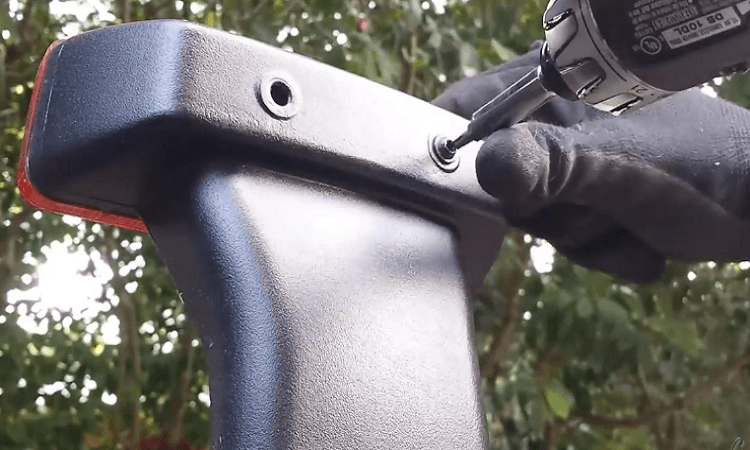

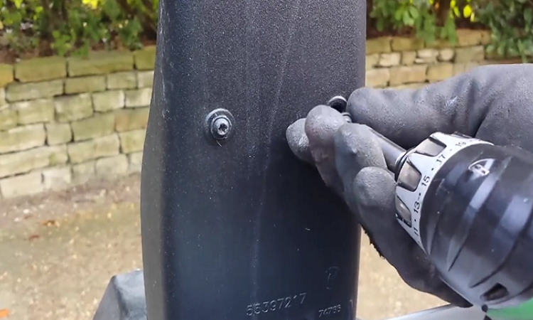

Step 2 – Remove the old stock
As mentioned before, the main reason shops charge a lot to replace these lights is because the complete stalk assembly needs to be removed. This includes the light housing and the plastic stalk that connects to the wheel mount.
  • Loosen the bottom T20 Torx screws that connects the stalk to the wheel mount.
  • Loosen the top T20 Torx screws and push out the brake light assembly.

Figure 2. Loosen the bottom T20 Torx screws.
Figure 3. Loosen the top T20 Torx screws.

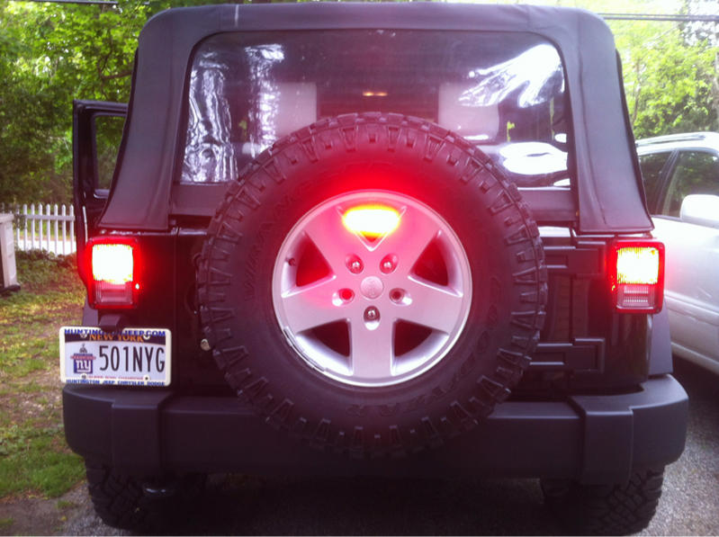

Step 3 – Mount the new light
Install the new brake light assembly onto the wheel mount.
  • Connect the light wiring.
  • Tighten the upper and lower T20 Torx screws.
  • Check the light and ensure that the bulb is working.
  • Then mount the wheel back in place.
Figure 4. Third rear brake light installed.
