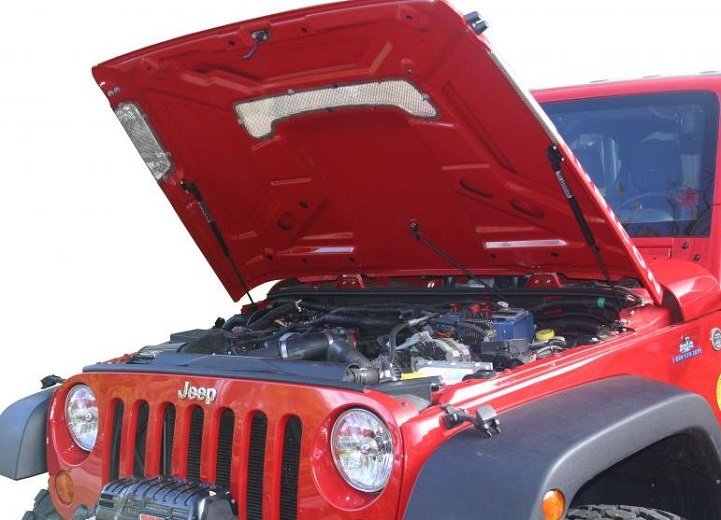

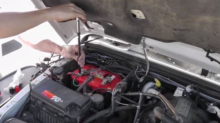

Step 1 – Pop the hood latches and raise the hood
Pop the hood latch on either side of the hood. Lift the hood and secure it in place with the retaining rod. If you have a lift kit installed, the shocks should hold it in place for you. Locate the battery on the left or passenger side near the firewall.

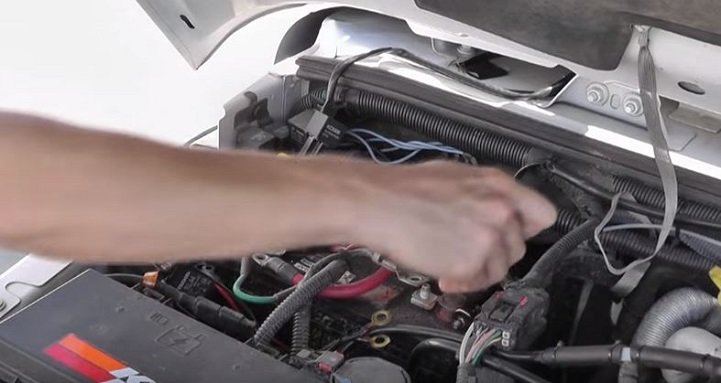

Figure 1. Lift the hood and locate the battery.

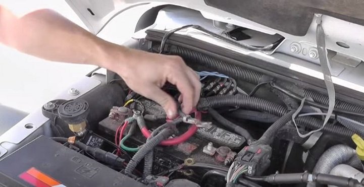

Step 2 – Disconnect any accessory wires first
If you have any other cables connected to the posts besides the main terminal cables, disconnect those first. Always start with the negative side first.
Figure 2. Disconnect any accessory wires from the battery first, starting with the negative side.

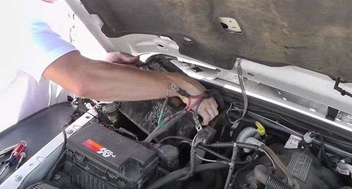

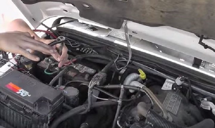

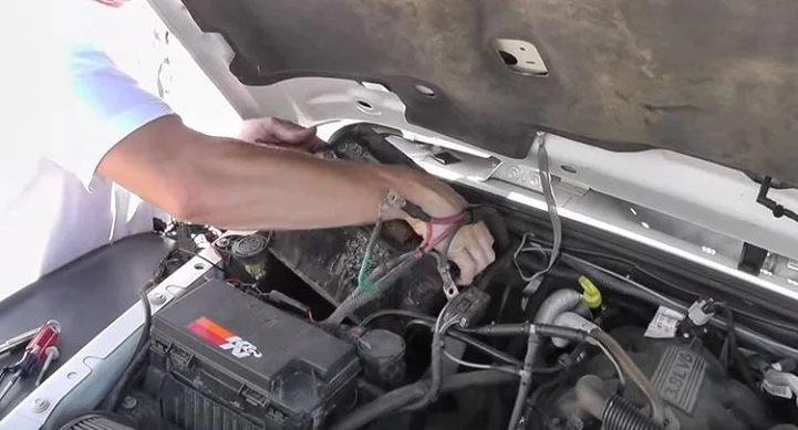

Step 3 – Remove main battery terminals
Using a 10mm wrench or socket, start with the negative (black) battery terminal first and disconnect it. Take care when removing the wires if any acid or corrosion is present.
Figure 3. You can use the open end of a 10mm box wrench to remove the terminals from the battery posts.

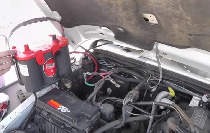

Step 6 – Install new battery
Make sure that your replacement battery meets the specifications that your Wrangler demands for cold cranking amps and for as long a life as you need. There are many brands to choose from, including the ever popular Optima red or yellow top series or Diehard, which is another popular choice among Wrangler owners. Get the correct size and shape in order for it to fit back in place without any additional modifications. When the battery is dropped into place on the tray, remount it using the existing bracket or you may wish to purchase a new aftermarket bracket. Re-tighten the mounting bolt until it is snug.
Figure 6. This Optima red top has an extra set of terminals: the front facing for starting the Jeep and the top terminals are for accessories.

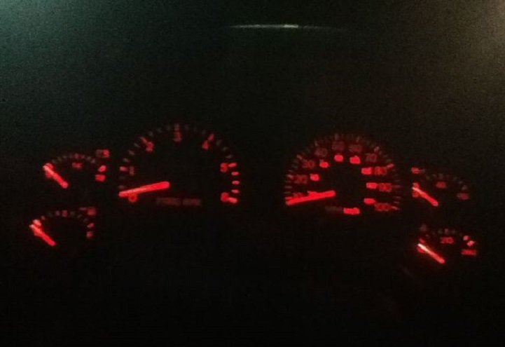

Step 8 – Verify startup
Once the battery is reconnected, verify that you can start her up with no problems and no CEL remain lit.
Figure 8. Make sure she starts right up and no CEL or codes are present.
