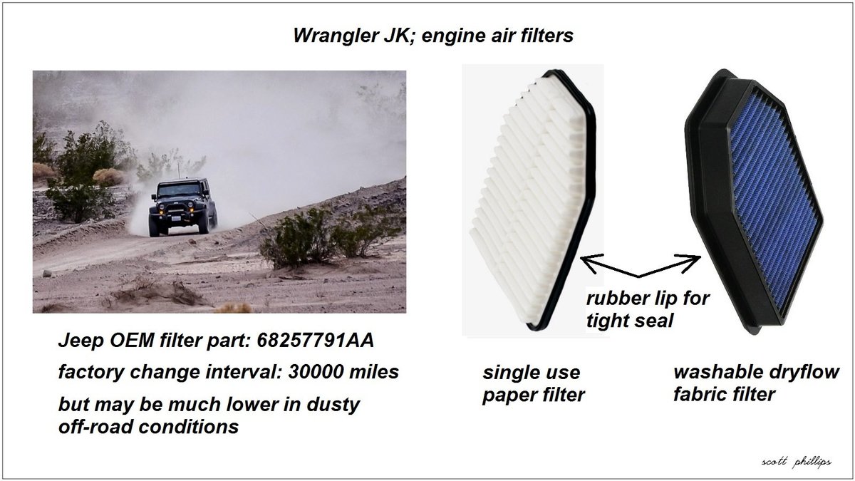

The Jeep's maintenance manual prescribes changing the filter every 30,000 miles, but dusty off-roading can clog the filter very quickly. The OEM Jeep filter is part number 68257791AA, and every auto parts store has several filter choices as well. Aftermarket filters may be made of disposable paper for economical single-use, or long-lasting, washable fabric. However, most Wrangler owners have found that the oiled, reusable filters clog very quickly in dust and dirt; and should be avoided for off-roading. Fortunately, there are several non-oiled "dryflow" filters on the aftermarket, which are of good quality and washable. In either case, look for a filter with a rubber lip to seal the air box tightly and keep out destructive dirt.

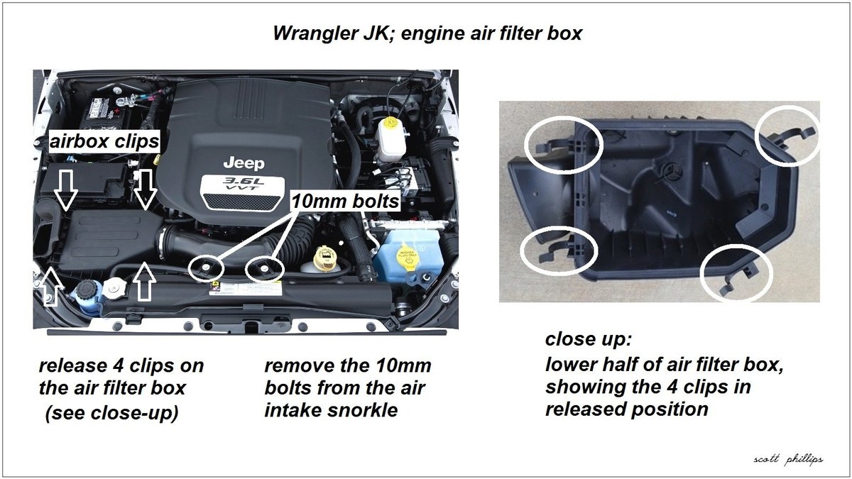

  • Reach down around the four corners of the air box and unsnap the four clips that hold the top of the box on. Push the clips outwards at the top. See Figure 2 below for a close-up view of the clips.
  • Use the 10mm wrench to remove the two bolts that fasten the air intake snorkle to the radiator shroud. This is to allow the air box lid greater movement.

Wear mechanic's gloves to protect your hands from rough or sharp edges.

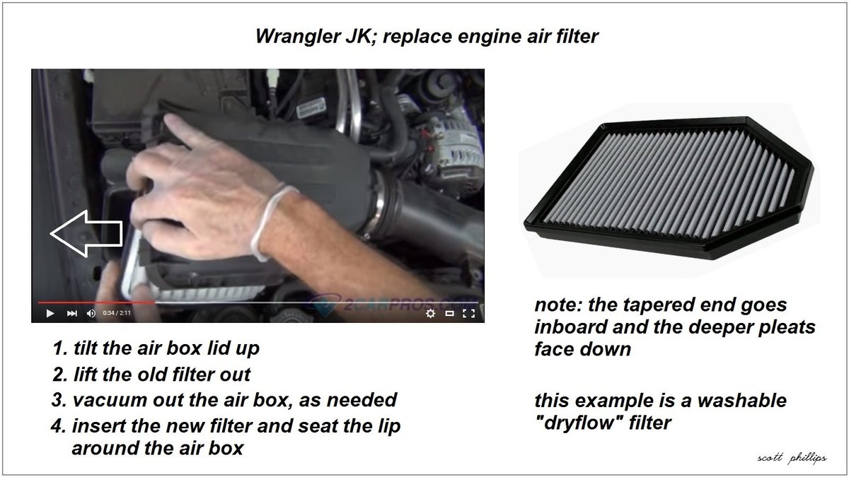

  • Lift the air box lid and tilt it upward by flexing the intake snorkle.
  • Lift out the old air filter.
  • Vacuum the dirt out of the bottom of the air box, if needed.
  • Install the new air filter with the pleats facing down and the tapered end inboard.
  • If the old filter appears fairly clean, perform the flashlight test in Step 3.

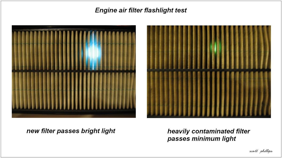

Step 3 – Air filter contamination flashlight test (optional)
Hold a bright LED flashlight under the new air filter and note how much light passes. Then do the same with the old filter and see how it restricts light passage. The light restriction is a fair comparison to the airflow it restricts and helps in judging how contaminated the filter is. In the picture below, see the comparison between the new filter and the very dirty filter. Note how the dirt and oil vapor change the bright blue-white LED to dim green.

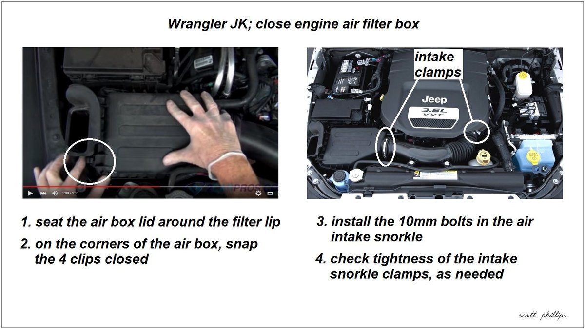

  • Snug the air box lid down around the lip of the new air filter and ensure that it is seated.
  • Close the four clips on the corners of the air box.
  • Install the two bolts that fasten the intake snorkel to the radiator shroud.
  • Using the 10mm wrench, check the tightness of the intake snorkle clamps.

Tug lightly on the air box lid to test it for security and ensure that the four clips remain tight.
