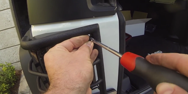

Although this is very simple to do, many people make the mistake of removing all four screws in order to take off the tail light assembly. For those of you interested in just replacing the bulbs, do not do this! The last two screws hold the plastic guard to the actual light assembly, so it helps prevents water from leaking inside. Just remove the two screws from the inside of the tail light.
Figure 1. Remove the two inside screws.

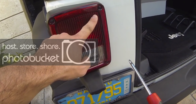

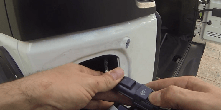

Step 2 – Pull off the tail light

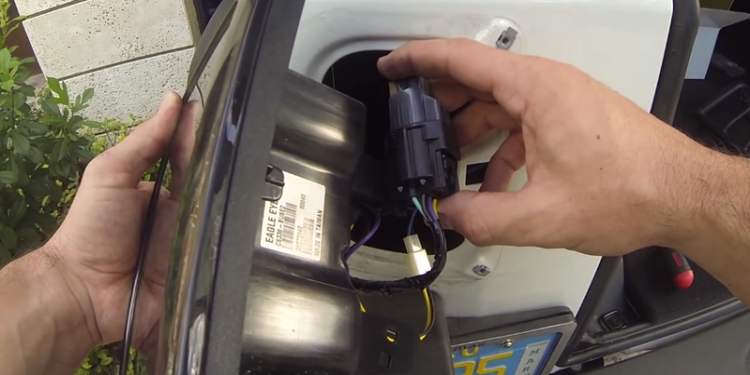

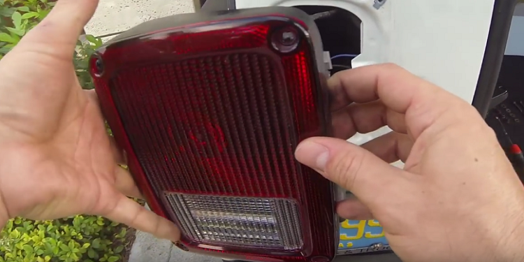

Gently grab each side of the tail light assembly and pull it outwards. Then disconnect the wire plugs from the light bulbs.
Figure 2. Remove the tail light assembly.
Figure 3. Disconnect the light bulbs.

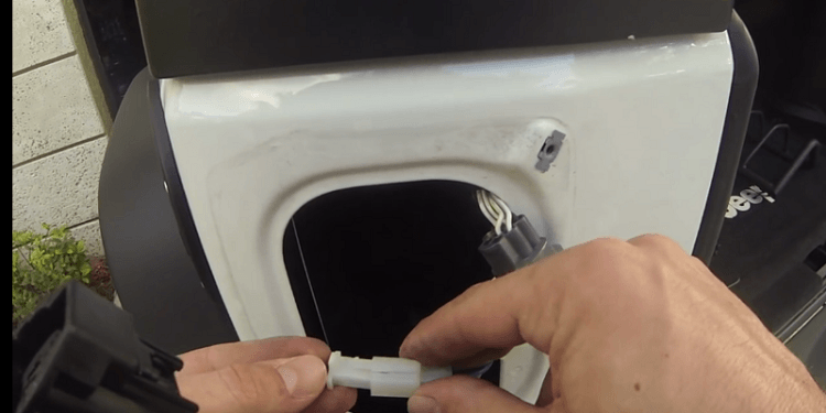

Step 3 – Connect the new light bulbs
Upgraded lights bulbs, such as LEDs, make use of the special transistor wire found inside the Jeep's chassis. Take the new tail light assembly to connect it to the chassis transistor and bulb wires.
Figure 4. Connect the transistor wire.
Figure 5. Connect the bulb wires.

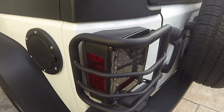

Figure 6. Install the mounting screws.
Figure 7. Guard installed.
