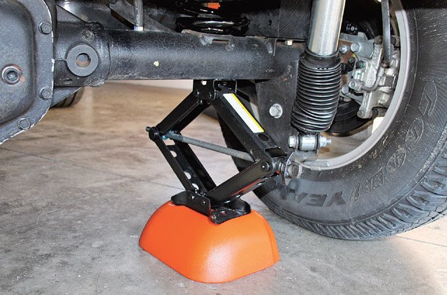

Step 1 – Raise the rear wheels off the ground
Raise the rear wheels with a floor jack using the factory jacking points under the axle tubes. Place jack stands under the jacking points before removing the wheels or crawling under your Jeep. Also, pull the wheels off the car for brake access.
Figure 1. The factory jacking points.

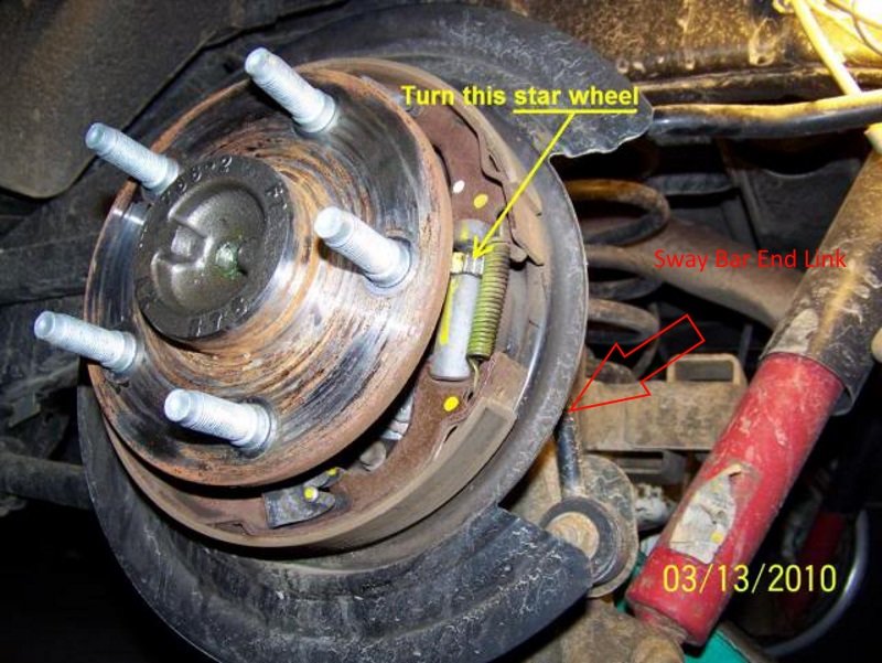

Step 2 – Remove the star wheel access plug
On the back of the brake drum/hub assembly you will see the rubber access plug next to the ABS wheel speed sensor on the backing plate. You may need to disconnect the sway bar end link, depending on how much room you need to work. Remove the plug by prying it out of the backing plate with a pick or flat head screwdriver.
Figure 2. The rubber plug is located between the sway bar end link and star wheel.
Step 3 – Adjust the star wheel
Use a flashlight to locate the star wheel (Figure 2) through the backing plate. You'll need to turn the star wheel with a flat head screwdriver or brake spoon.
These directions are provided assuming your facing towards the front of your Jeep. Adjust the passenger side by turning the star wheel counterclockwise. While turning, rotate your tire feeling for increased resistance. This is the brake shoes contacting the rotor. You'll want to get your brake shoes as close to the rotor as possible without rubbing. Continue adjusting the star wheel (counterclockwise to close the gap, clockwise to open) until the ideal point is reached. Repeat the process for the driver's side, but note that the you'll need to move the star wheel in the clockwise direction to open the gap and the counterclockwise direction to close the gap.
Once the adjustment at the wheels is finished, check the adjustment at your emergency brake handle. You want the parking brake to begin tightening and engage between four and eight clicks. Try moving the parking brake lever to this point, and place your transmission in reverse with your foot on the brake. Slowly release the brake. You should see the rear of your Jeep lift up and not move, indicating your parking brake is holding. Double check the adjustment using a hill.
If your parking brake lever is still out of adjustment (not within the four to eight click window), readjust the star wheel several clicks at each wheel in the appropriate direction. Make sure the brake shoes are not excessively dragging against the wheels. Continued in-operation of the parking brake lever may indicate worn/broken parking brake shoes, rotors, parking brake cable, or parking brake lever assembly.

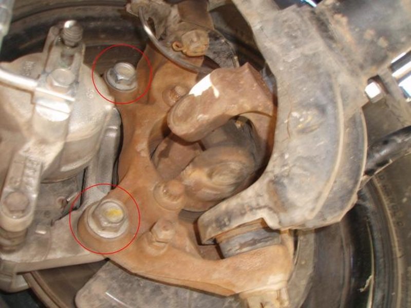

Step 4 – Remove the caliper mounting bracket
If you do not have an impact wrench, you'll need to loosen the 19mm lug nuts a couple turns with the wheels on the ground. Follow Step 1 for the procedure. Two 18mm bolts hold the caliper mounting bracket to the spindle. Turn them counterclockwise to remove them. Once they're loose, support the brake caliper with a bungee cord or wire to keep pressure off the rubber brake hose.

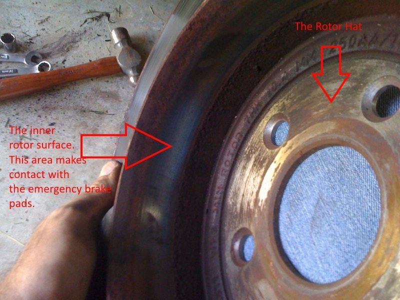

Step 5 – Remove the brake rotor
The rotor is not fastened to the hub once the wheel lug nuts are removed. Pull outwards on the rotor to remove it. You may need to tap on the "hat" (raised inner section of the rotor) with a hammer to break loose any rust holding it to the wheel studs.

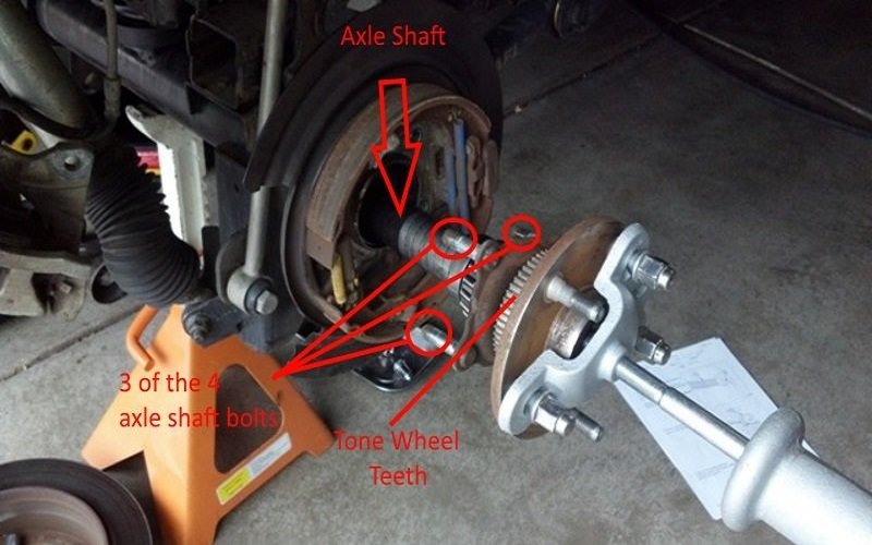

Step 6 – Remove the axle shaft flange

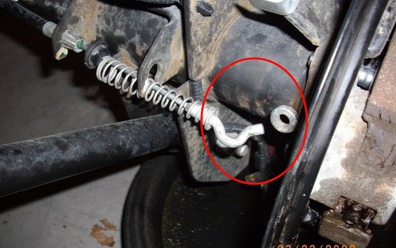

Begin removing the axle shaft flange by removing the four 18mm nuts holding the axle shaft backing plate to the housing. As you begin to remove the shaft, some differential fluid may leak from the axle tube. Raise the axle tube above parallel to the ground to prevent this. Grab the end of the emergency brake cable where it hooks to the eye loop through the backing plate and twist it free with vice grips. To remove the axle shaft from the axle tube, you'll need to pull outward on the axle shaft hub flange. This can be done by hand, with a slide hammer, or a pry bar. Be careful not to damage the tone wheel teeth. Pry in multiple positions against the hub flange to reduce binding in the axle tube and differential.
F
Figure 5. Removing the axle shaft with a slide hammer.
Figure 6. The emergency brake cable eye hook.

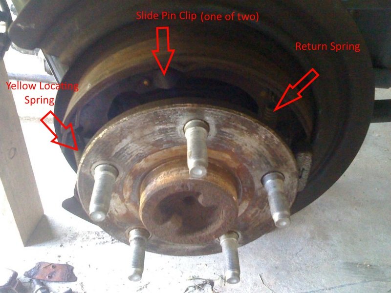

Step 7 – Remove the emergency brake pads
Referring back to Figure 2 and using Figure 7, you'll need to locate and remove the two slide pin clips, yellow locating spring, as well as the return spring on the opposite side. The clips can be pulled off the pins with a flat head screwdriver. The springs can be removed with needle nose pliers or a drum brake spring removal tool. Wiggle the pads free from the backing plate.
Figure 7. The parking brake springs and slide pin clips.
Step 8 – Install the new emergency brake pads
Set the new pads against the backing plate, making sure the pad notches fit into the star wheel adjustment mechanism and backing plate pad stop. Install the yellow locating spring, and then the return spring. Move the pads over the slide pins and install the clips.
