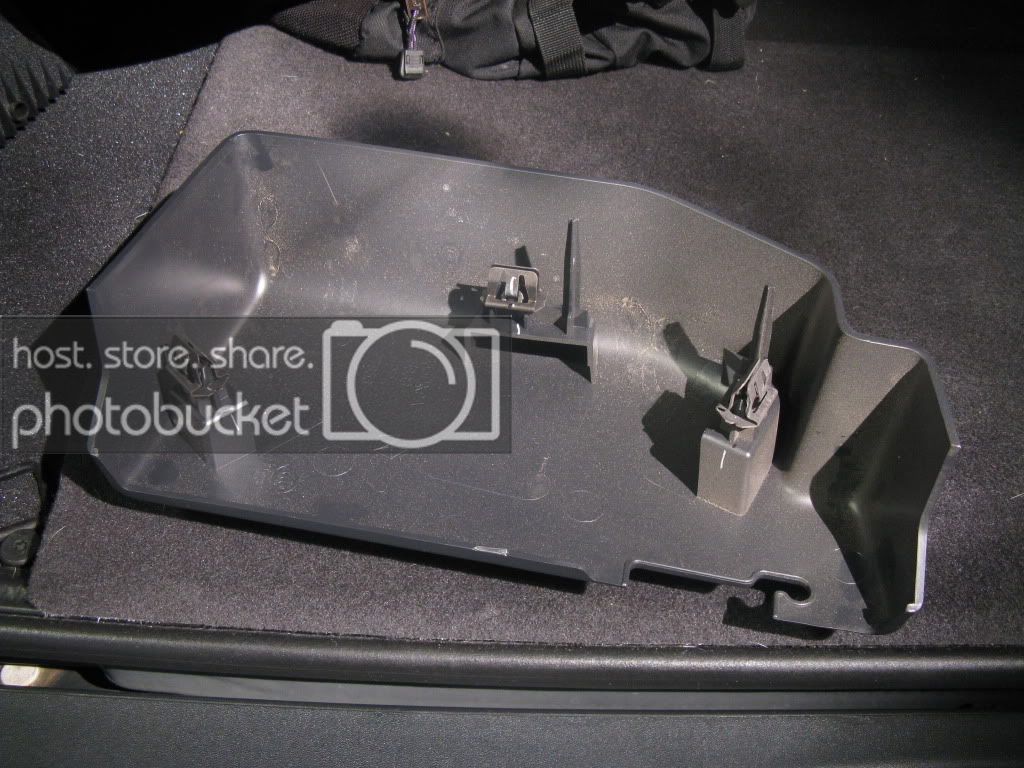

Step 1 – Remove the plastic housing
Locate the plastic housing that covers the wiper motor assembly. This part can be found on the inside of the rear window behind the rear wiper. The plastic cover will come right off with a gentle pull.
F
Figure 1. The plastic cover comes off with ease.

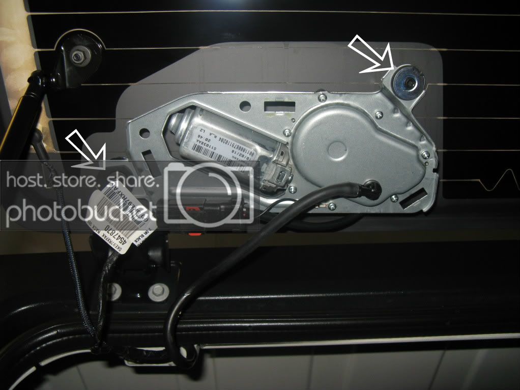

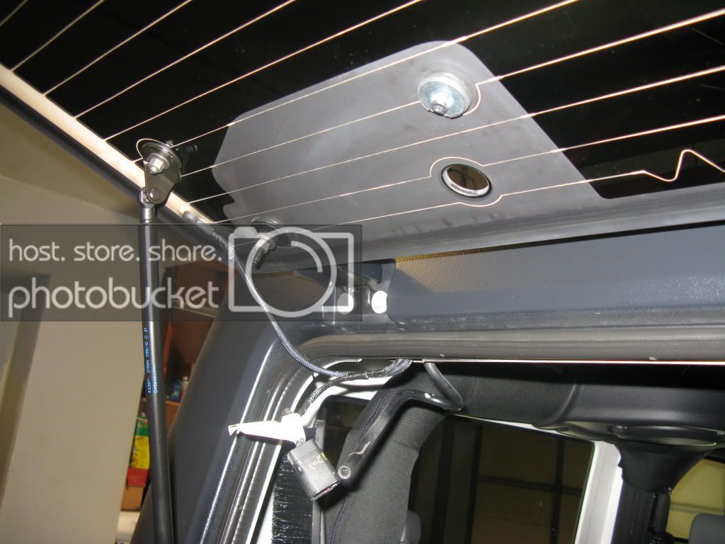

Step 2 – Begin to remove the motor housing from the rear window
There is a nut on the left and a bolt on the right that need to be loosened but not fully removed. See Figure 2 for the location of these. Proceed to seperate the electrical connection on the bottom of the housing. There is also another hose that will need to be removed at the "L" fitting.
Figure 2. Entire motor assembly and location of the nut and bolt.

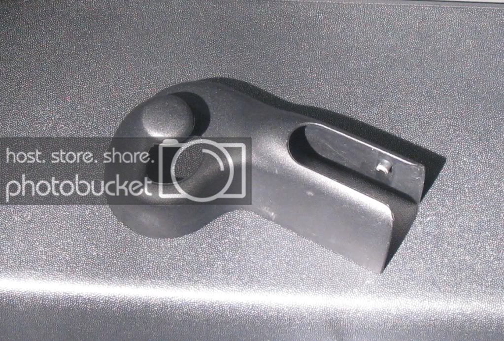

Step 3 – Remove the plastic housing on the wiper blade
Now you need to work on the wiper arm itself on the outside of the rear window. At the base of the wiper arm you will see a small plastic cover. This cover removes easily like the cover from the wiper motor. Simply pull this small piece off to reveal the nut.
Figure 3. Plastic housing from the base of the wiper arm.

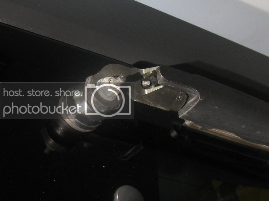

Step 4 – Remove the nut and wiper arm
This step requires some patience and care. Once the nut is removed, this frees up the wiper arm. However, prying the arm off of the delicate nozzle underneath needs to be done carefuly. This is where the gear puller can help because attempting to pry this off with a flathead screwdriver can result in damaging some of the plastic pieces behind the arm. The wiper arm needs to be pulled directly toward you and off the nozzle underneath.
Figure 4. Location of nut; remove the arm carefully.

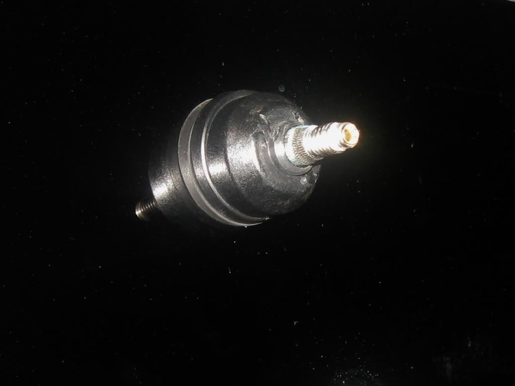

Step 5 – Loosen the nozzle to remove the entire assembly
Once you have removed the wiper arm, what you are left with is a small brass nozzle with a small plastic boot. Simply pull off that plastic boot to reveal the nut underneath. Once you remove this nut, the entire motor assembly will be ready to come off easily.
Figure 5. Brass nozzle.
Figure 6. Wiper assembly fully removed.
