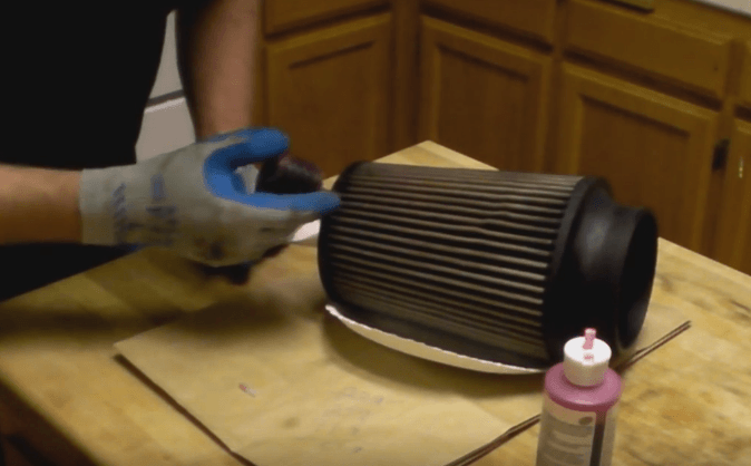

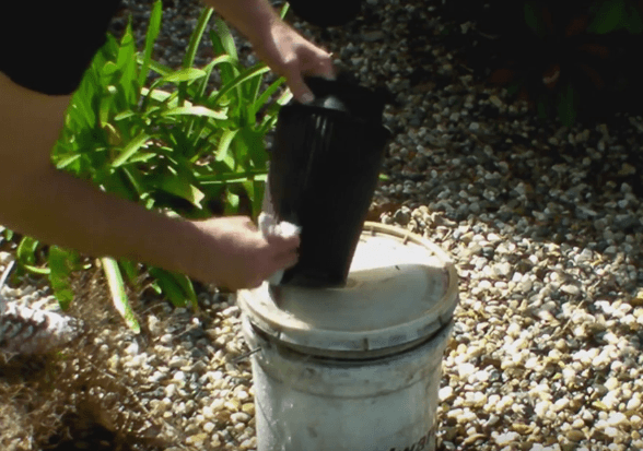

Step 2 – Agitate filter with brush
After applying the cleaning spray to the filter, use a small amount of water to wet the filter. Then, use a brush to go around the filter and loosen any dirt that might be on the filter. Do not forget the inside of the filter.
Figure 2. Agitate filter with brush.
Pro Tip
Do not use a harsh brush because you will risk damaging the filter.

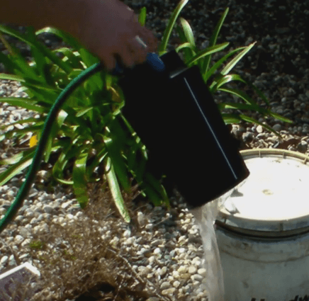

Step 3 – Wash filter with water
Now, use water at a high pressure and thoroughly clean your air filter in an out. Some cleaning kits have a dyed cleaning solution. In this case, watch for the solution coming out of the filter to be clear. After washing the filter with water, you are almost done! Wait for the filter to dry for a few hours. Leaving the filter in the sun will expedite this process.
Figure 3. Washing filter.

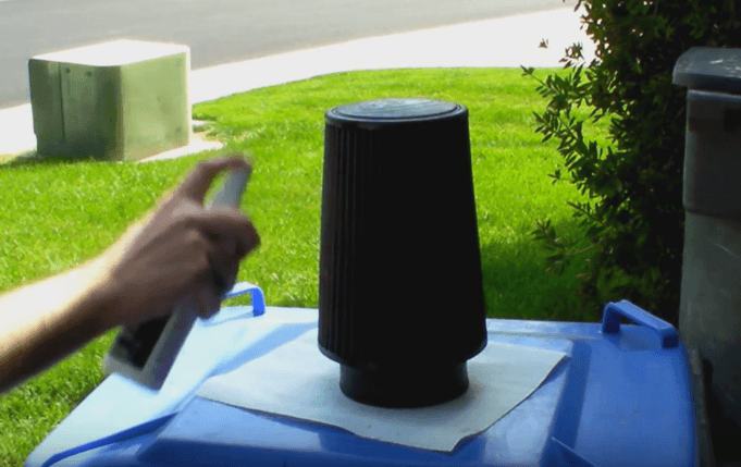

Step 4 – Re-oil and install filter
Starting at the top of the filter, add the recommended amount of oil based on the kit that you purchase. It is better to use less oil instead of risking over oiling the filter. After letting the oil settle for a few minutes, the filter is ready to be installed!
Figure 4. Oiling filter.
Pro Tip
Over oiling your filter can cause your engine to run terribly, due to oil buildup on the MAF sensor wires.
