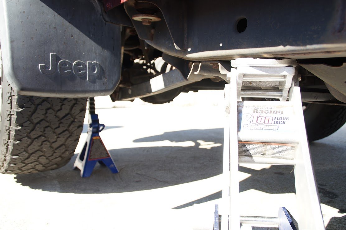

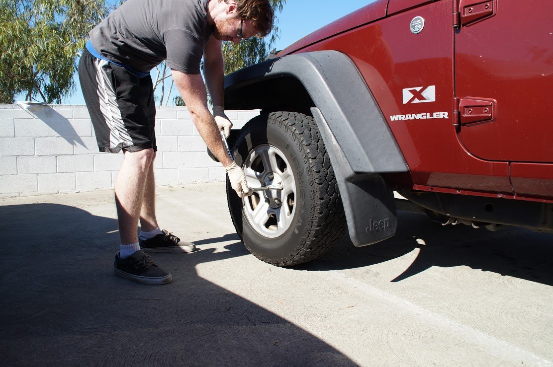

Loosen the lug nuts on the wheels you will be removing, then raise the car and secure it on jack stands. Remove the wheels you will be painting.
Figure 1. loosen lug nuts.
Figure 2. Raise the car and secure it with jack stands.

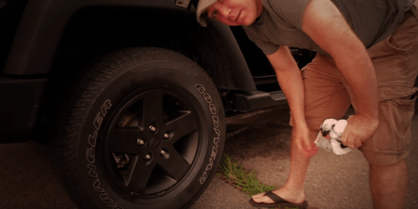

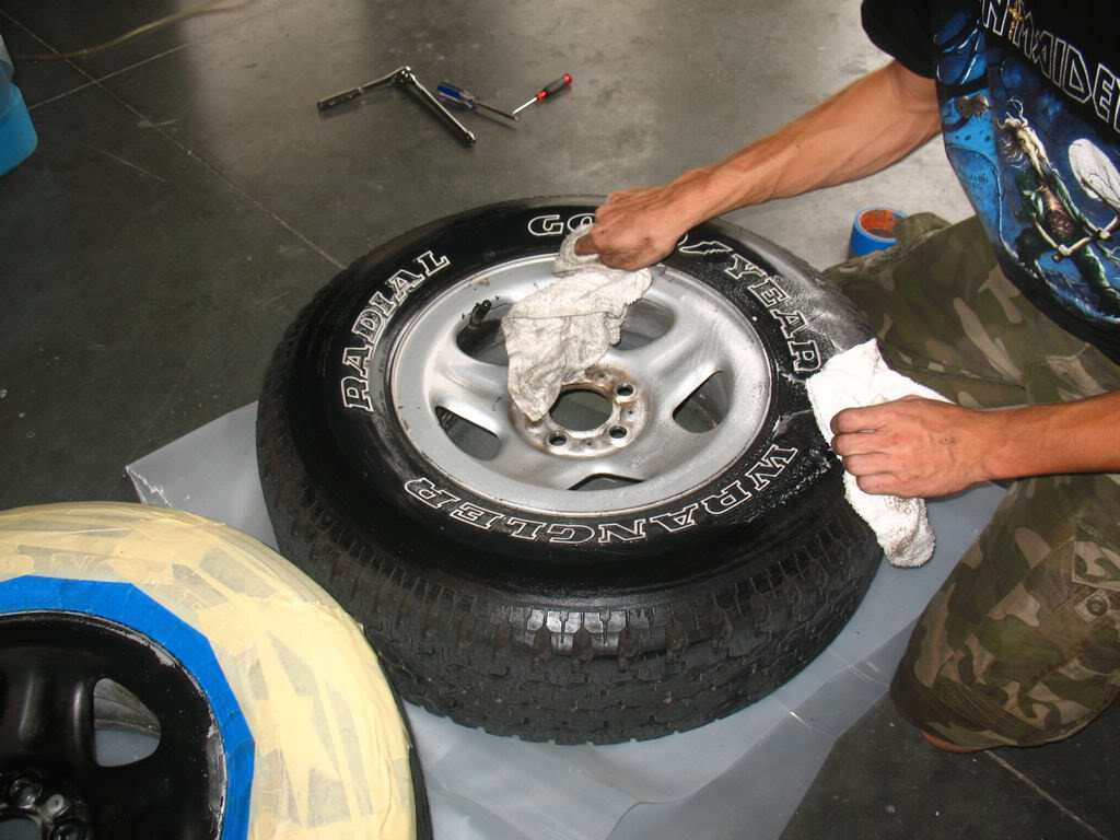

Step 2 – Clean the wheels
Use your soap, water and rag to clean the wheels thoroughly and dry them properly. Make sure there is no dust or dirt on them. Anything left on it will be trapped under the paint and could cause an uneven application.
Figure 3. Wash and dry the wheels.

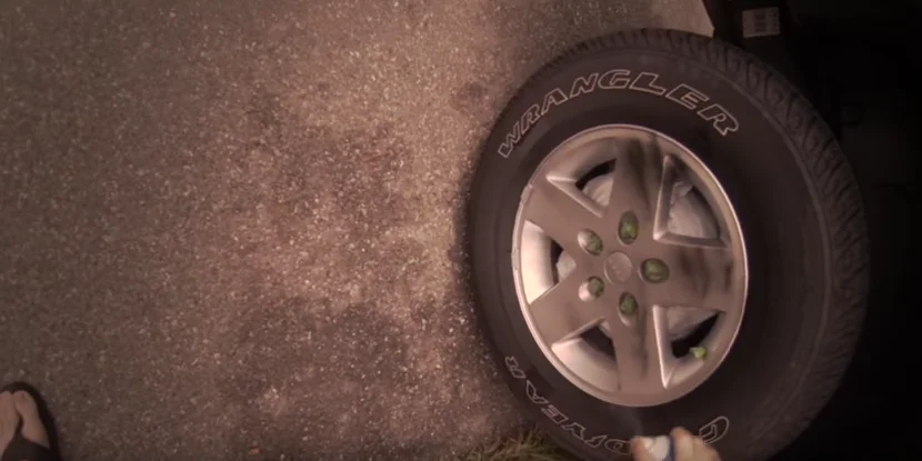

Step 3 – Paint the wheels
If you've decided to leave the wheels on the car, be sure to cover the brake components behind them and the lug nuts. If you removed the wheels, then you're ready to start.

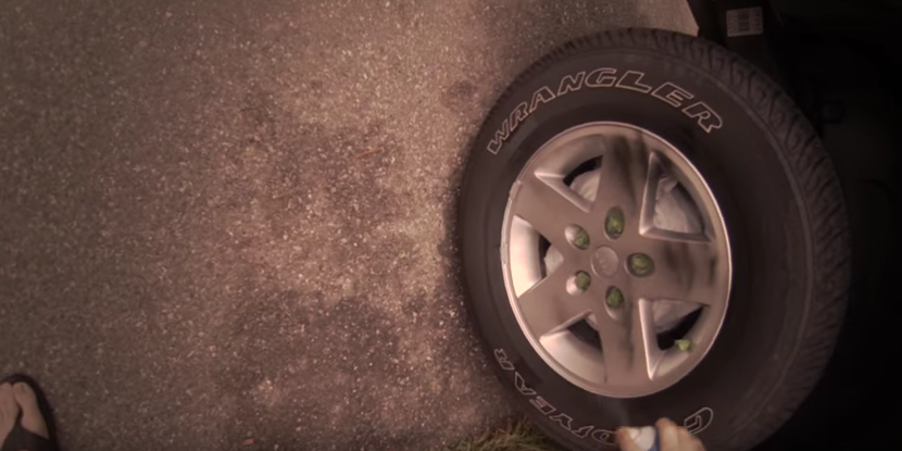

Hold the Plasti-Dip spray can about 6 to 8 inches away from the wheel, and once you start spraying, be sure to keep your hand consistently moving left and right. Cover the whole surface. At first, it may look messy, but as you go over it, it will start coming together and the paint will look consistent. Once you have a semi-consistent coat, wait 15 minutes then spray another coat. The goal is to do three coats for each wheel.
Figure 4. Spray 6 to 8 inches away from wheel.
Figure 5. Paint three coats for each wheel.

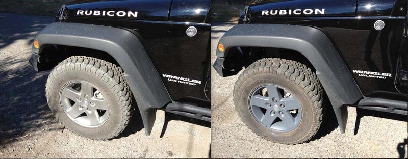

Figure 6. A before (left) and after (right) shot of Plasti-dipped wheels.
