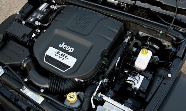

Before going on your off-road adventure, you will first need to make sure your vehicle is in peak mechanical condition. In sand dunes, you are going to need all the power that your vehicle has to offer. This means making sure that it is in the condition to provide you with this needed power. Dune driving will also usually require your engine to operate at higher RPMs for a longer duration, so making sure that it is ready to do this is extremely important. A fresh oil change and filter, spark plugs, and a fresh air filter is where you should start. If you have any check engine lights on, it would be a good idea to get those taken care of also.
Figure 1. Check your fluid and replace as necessary.

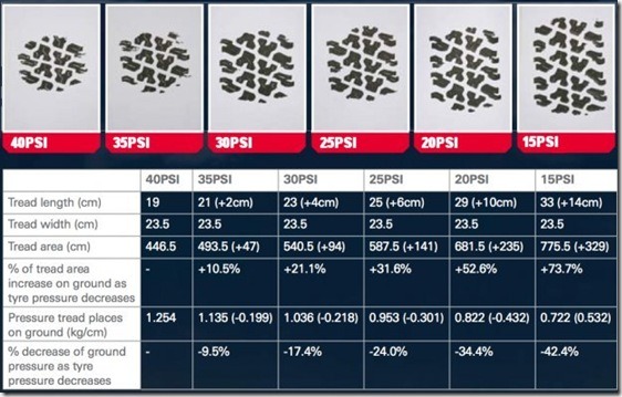

Tires are a very important part to sand dune driving. Other than your driving technique, this might be the most important thing to focus on. With dune driving, it's not all about an aggressive tread pattern like with other off-road driving. It's about having a large footprint and keeping the tire from digging into the sand. To make sure that we have the largest footprint available from the tires on our vehicle, we need to air down. This will make the tire widen where it contacts the terrain, proving it with a much larger footprint than normal. How much do we air down? Well, that actually depends on the tire, but you should be safe with 12 to 15psi on most street tires. What you don't want to do is air down too much and cause the bead to roll off the wheel. If you have deadlocks, then you can air down much farther.

Figure 2. Footprint versus tire pressure.

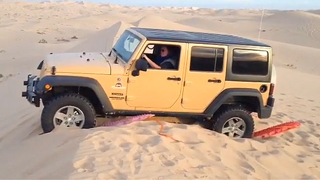

This is where your driving style will play an importance. You only get stuck in the sand at slow speeds. Nobody ever gets stuck in the sand going fast. So after you have all of your mechanical variables covered to help you keep your speed up, now it's up to you. This will require you to shift at the correct time if you have a manual, or shifting your automatic into the right gear at the right time to keep yourself moving at a good enough speed so you don't dig in.
Figure 3. This is what happens when you lose momentum cresting a dune.

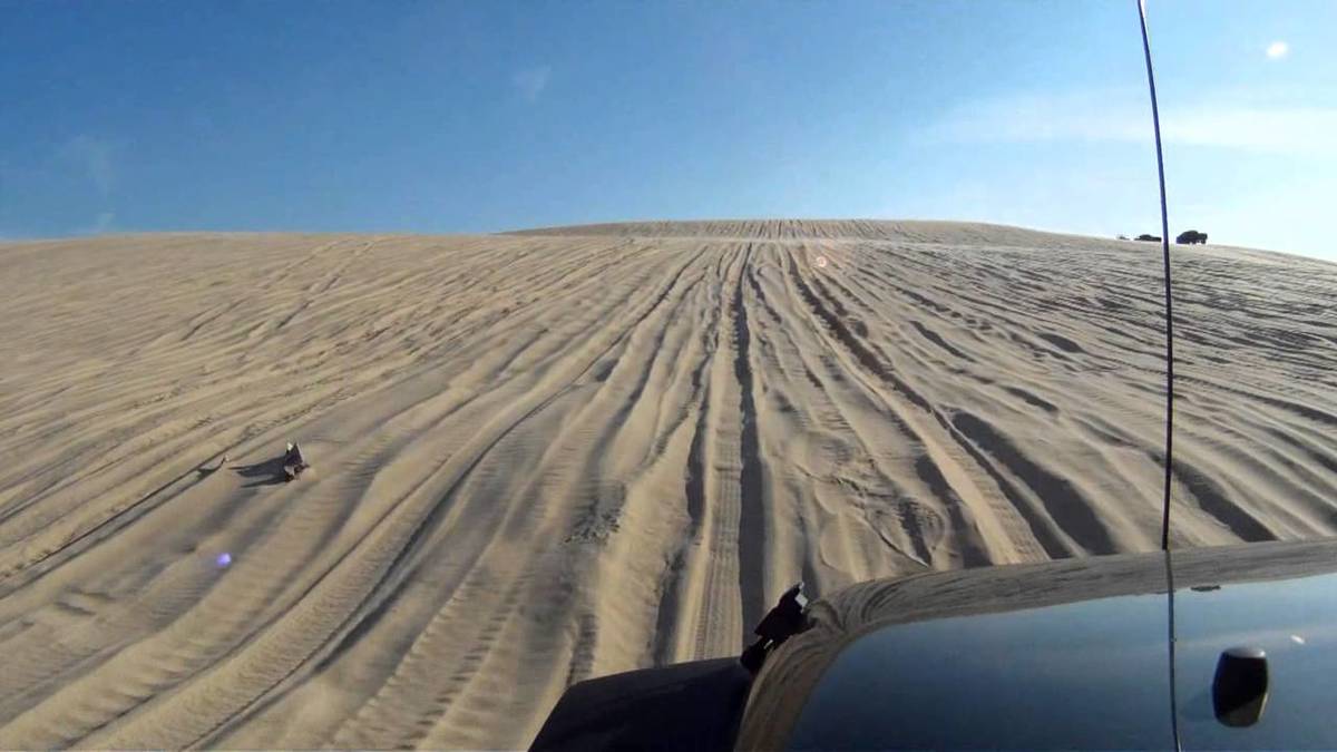

Keeping the momentum that you need to keep yourself from getting stuck will require you to operate your vehicle with smooth inputs and picking your driving line far ahead of where you are headed. If you turn too abruptly, it could cause the front tires to dig in, which will lose you momentum. If you don't pick the proper driving line, you could drive in sand that is much deeper and softer, causing you to lose momentum. Try driving in other people's tracks as long as you see that their tracks keep going and don't come to a stop. This means that they probably got stuck there. If you are going to drive where you don't see tracks, aim straight and pick up even more momentum. It's going to seem counter-intuitive, but try and stay off the brake pedal. You shouldn't need the brakes too much, as sand will slow you down pretty effectively, so try and keep the wheels from slowing down unnecessarily. Last but not least, you are going to have to stop eventually. Before stopping, try and find a spot that looks firm and higher than the other areas around you. This will help when it's time to get going again.
Figure 4. Follow the path of those who came before you.

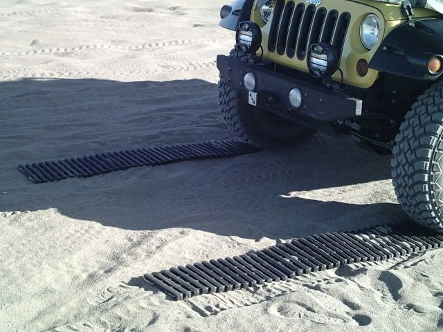

Now comes the part nobody wants to talk about. Getting stuck. It's going to happen, and when it does, you want to be prepared. In the sand, I would say there are three things that you can equip yourself with at a minimum to make getting stuck not so bad. A tow strap, preferably one rated to the weight of your vehicle. Ensure you also have good, solid tow points at the front and rear of your vehicle. A shovel; this will come in handy to dig your tires out if they get too deep in the sand. Finally, sand ramps. Sand ramps are actually a product that is offered so that if you get stuck, you place these in front of your tires and use them to drive on, which will lift you out of the sand. You can make your own sand ramps out of wood or metal. I've also seen some people use a roll of carpet, or their floor mats if they failed to bring their own.
Figure 5. Traction strips.
Aside from a winch, I highly, highly recommend a good set of traction mats, such as these ones:
With traction mats like that, you'll be able to get yourself out of most stuck situations.
