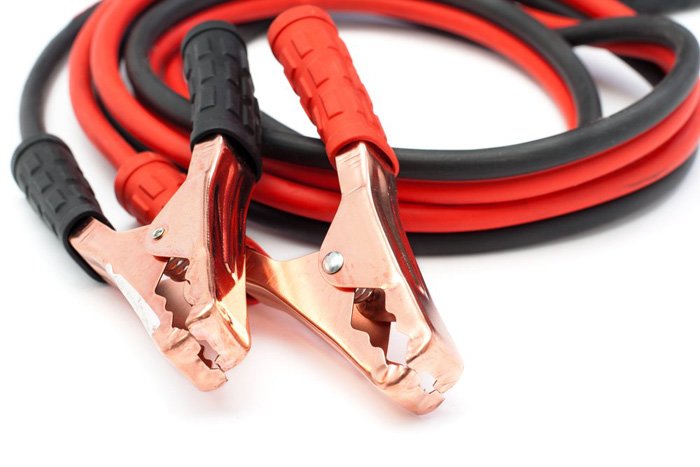

If your Jeep Wrangler's battery dies, it means you are not going anywhere; unless, of course, you have jumper cables. In order to jump your battery, you need another working vehicle and a jumper cable. The process of jumping the car should be classified as one of the easiest procedures you can do for your car, even easier than driving. The jumper cables borrow the charge from the working battery and charges your dead battery with just enough to get it started. Once it started, the alternator takes over and it recharges the battery. Sometimes you can recharge the battery by driving it for a little bit, but other times the battery will keep losing charge and you will have to replace it. Either way, jumping your car will allow you to get home instead of sitting around waiting for a tow truck. Read on to learn how to jump your Jeep Wrangler's battery.
Figure 1. Jumper cables.

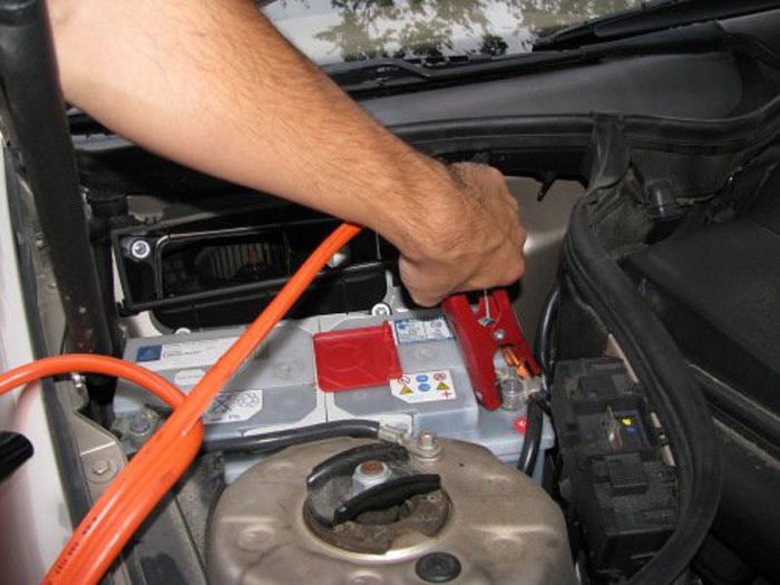

Step 2 – Connect jumper cable
Open the hood on both cars. Connect the red cable to the working (running) car battery, then connect the other end of the red cable to the dead car battery.

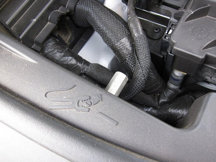

Connect the black end of the cable to the working car battery, then connect the other black end to anything metal on the dead car, such as a bolt or bracket. The Wrangler will have a bolt designed for that under the hood, which is connected to the fender, so connect the black cable to it.
Figure 3. Connect negative cable to metal part.
