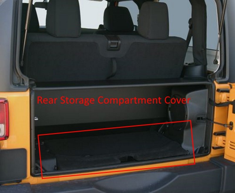

Step 2 – Remove scissor jack kit
The scissor jack kit will be located in your rear storage compartment. Remove the cover (carpet or plastic) on the trunk floorboard. Remove the scissor jack by pulling it to the right. Place the jack, jack handle, jack handle extension, and lug wrench in an accessible area.
Figure 1. The rear storage compartment cover.

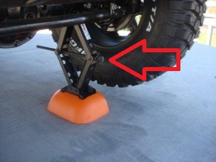

Step 3 – Locate the factory jacking points
The Wrangler's jacking points are located on the axle tubes. Center the scissor jack under the axle tube corner closest to the wheel your trying to raise.
Figure 2. The jacking points under the axle tubes.

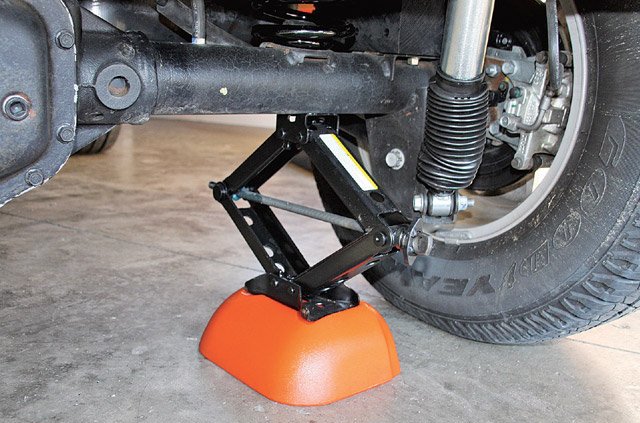

Step 4 – Jack up your Wrangler
Turn the jack screw clockwise with the hooked end of the jack handle driver. Use the extension for added leverage. The turning effort will increase once the jack's maximum height is reached.
Placing a jack stand rated for your Wrangler's weight next to the scissor jack on the axle tube is a great idea when crawling underneath.
Figure 3. The scissor jack and optional base plate.
