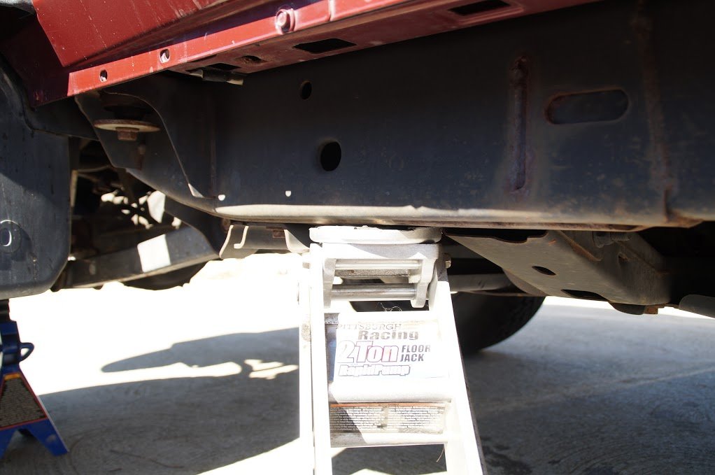

The factory jacking points on the JK are at the ends of the front and rear axle tubes.
Figure 1. Jack up on the frame and put stands under the axle.

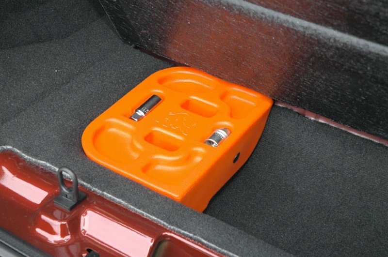

Figure 2. The AEV jack base.
Step 3 – Mount the jack to the jack pad
For off-road situations, jack pads with a wide base provide added stability. Soft ground can cause your jack to sink into the ground possibly leading to collapse. The wider base will spread out your vehicle's weight and counter this effect.
Jack pads come in different styles and designs. Some are simply placed underneath the jack with no physical attachment. Others bolt the jack to the jack pad. Follow the jack pad manufacturer's specific instructions when using their jack pad.
