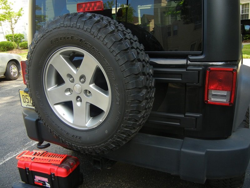

  • Use the lug nut wrench to loosen the spare tire.
  • Once the lug nuts are loose, remove them by hand.
  • Pull the spare tire off.

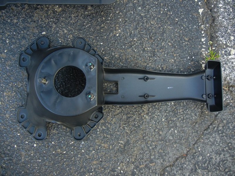

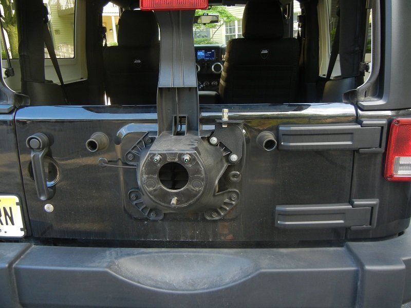

  • Use the ratchet wrench and 13mm socket to remove the tire holder.
Figure 1. Remove spare tire.
Figure 2. Tire removed.
Figure 3. Removed holder.

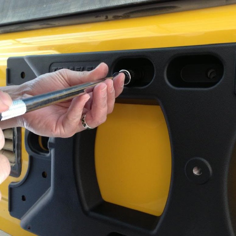

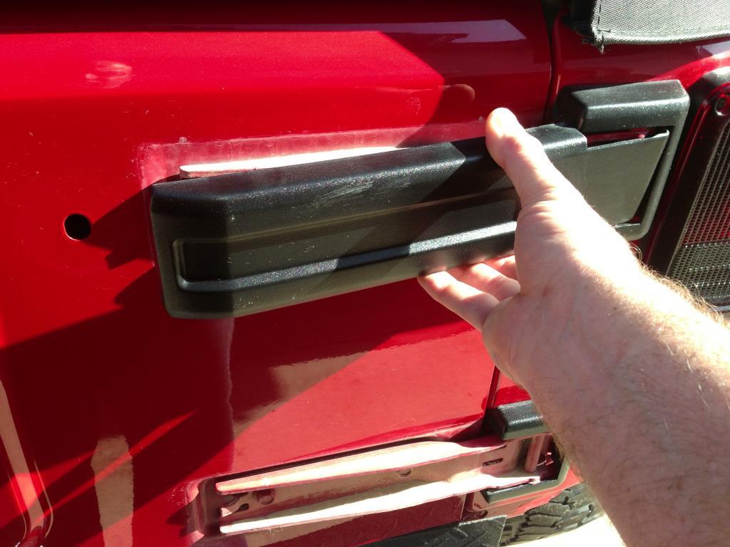

  • Use your hands to pop out the plastic covers that cover the hinges.

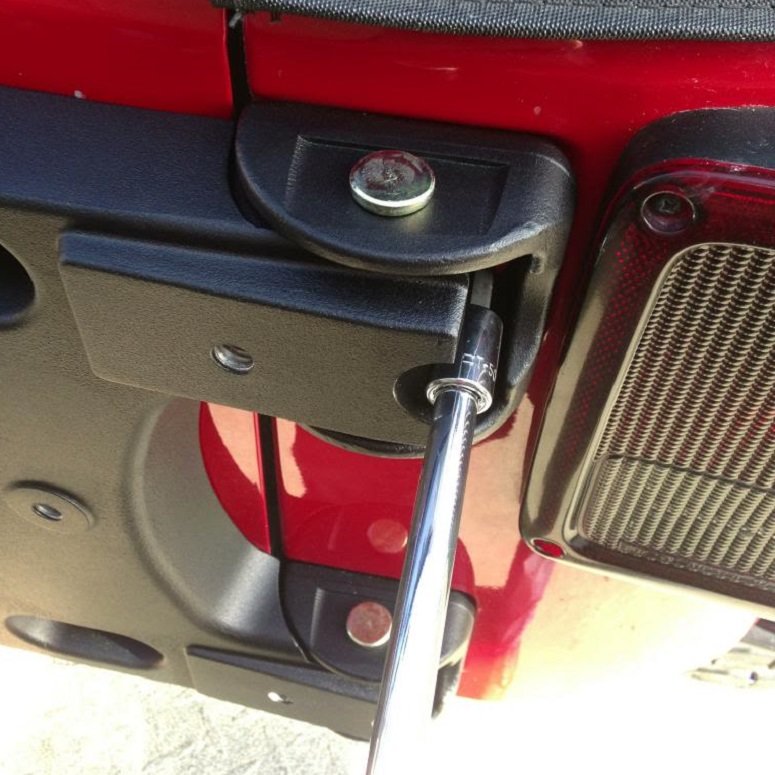

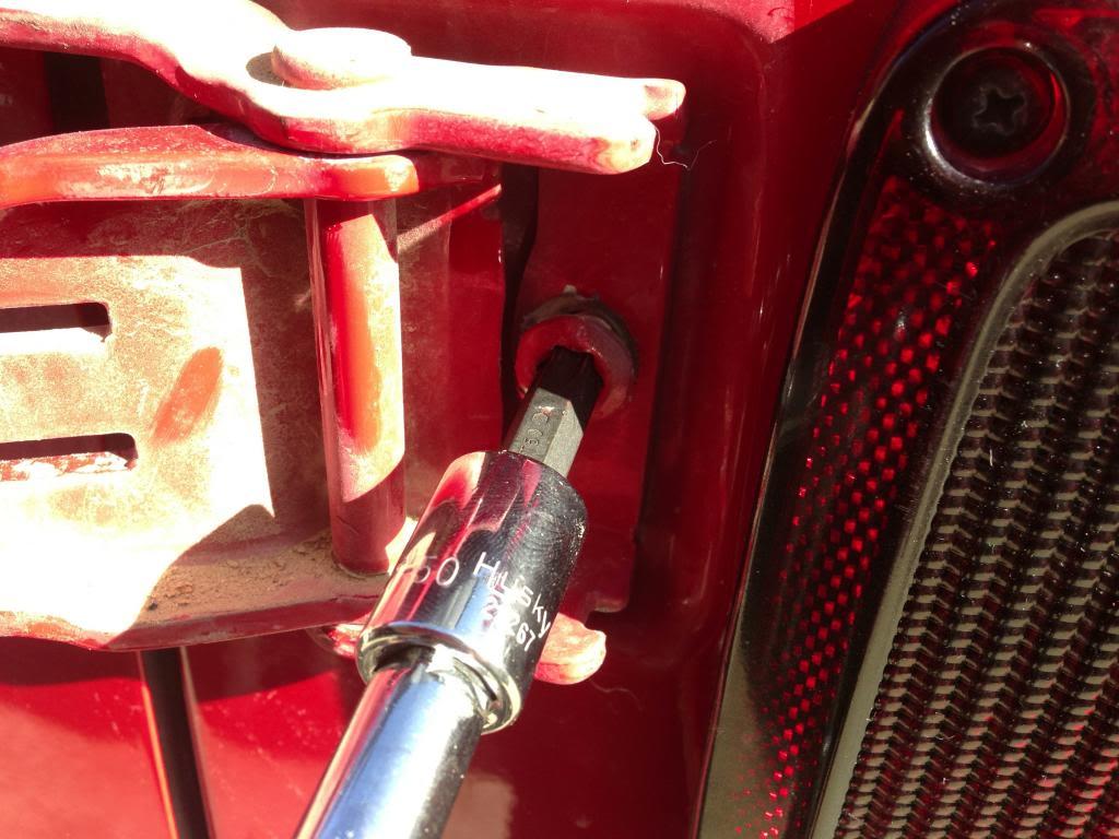

  • Use the ratchet wrench and 13mm socket to remove the (inside) hinge bolts.

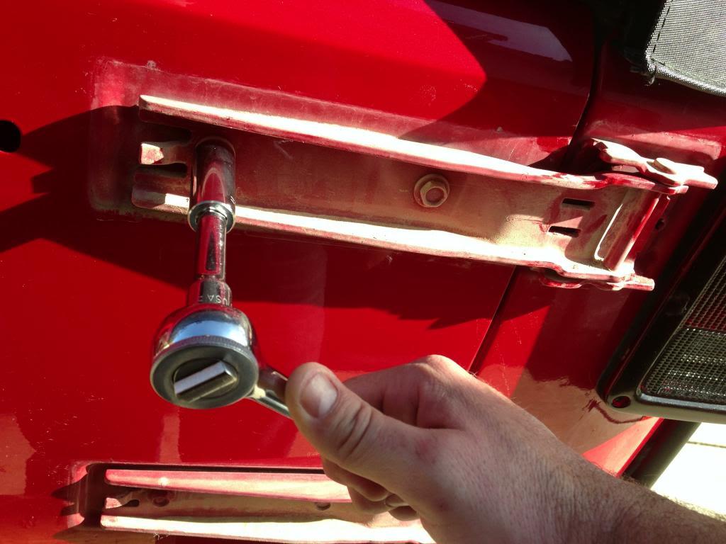

  • Use the ratchet wrench and Torx T50 driver to remove the (outside) hinge bolts.
Figure 4. Pop hinge covers off.
Figure 5. Remove interior hinge bolts.
Figure 6. Remove exterior hinge bolts.

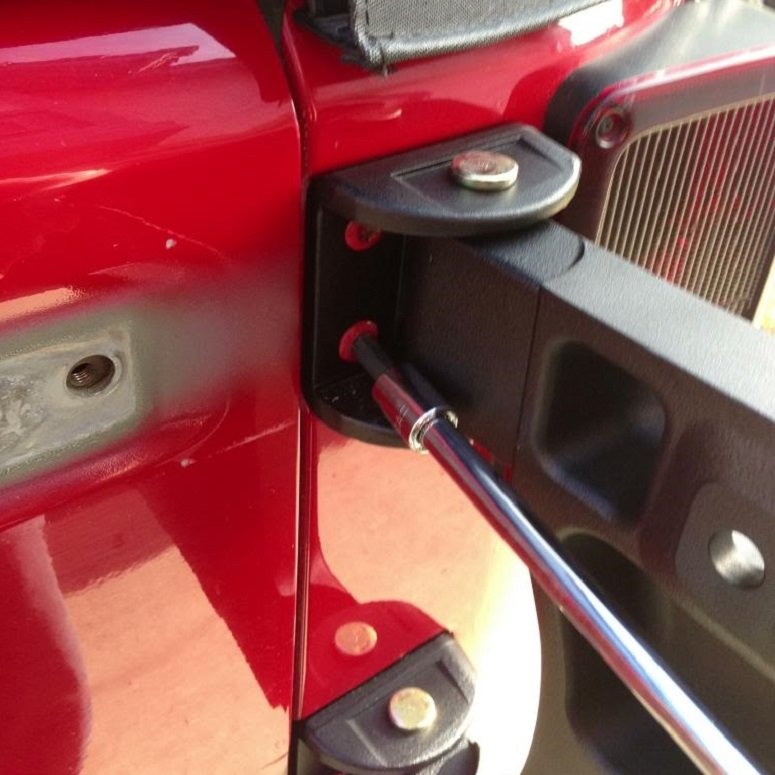

  • Use the provided hardware to install hinges in the same spot as the stock setup.
  • Tighten the interior and exterior hinge bolts.

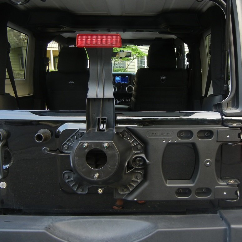

  • Mount the center tire holder.

Figure 7. Install new hinges.
Figure 8. Tighten down hinge bolts.
Figure 9. Install center tire holder.
