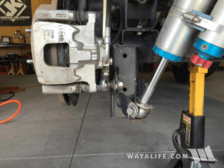

2. Using an 18mm socket and wrench, remove the bolt and nut securing your Jeep JK Wrangler’s rear shocks to the lower axle mounts. Pull the shock out of the mount and push it aside for now.
3. Using an 18mm socket and wrench, remove the bolts and nuts securing the factory links to the lower axle mounts. If you have a set of aftermarket links, you will most likely need to use a different set of wrenches. The EVO links shown in this photo requires a 5/8" wrench to hold the stud in place and a 3/4" socket to remove the nut.

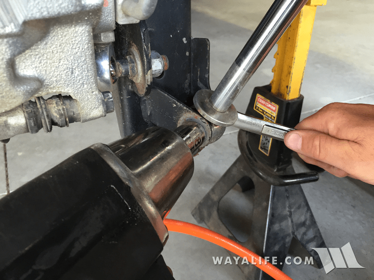

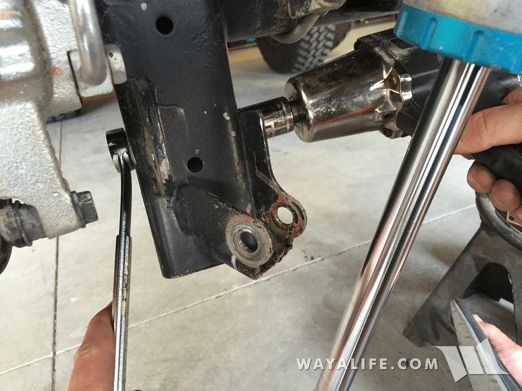

4. Remove your Jeep JK Wrangler factory rear lower control arms from the axle mounts using a 21mm socket and wrench.

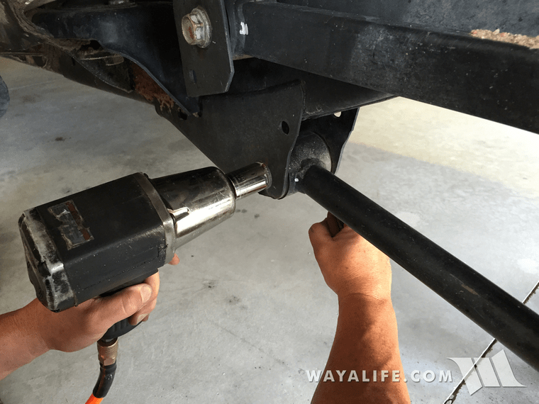

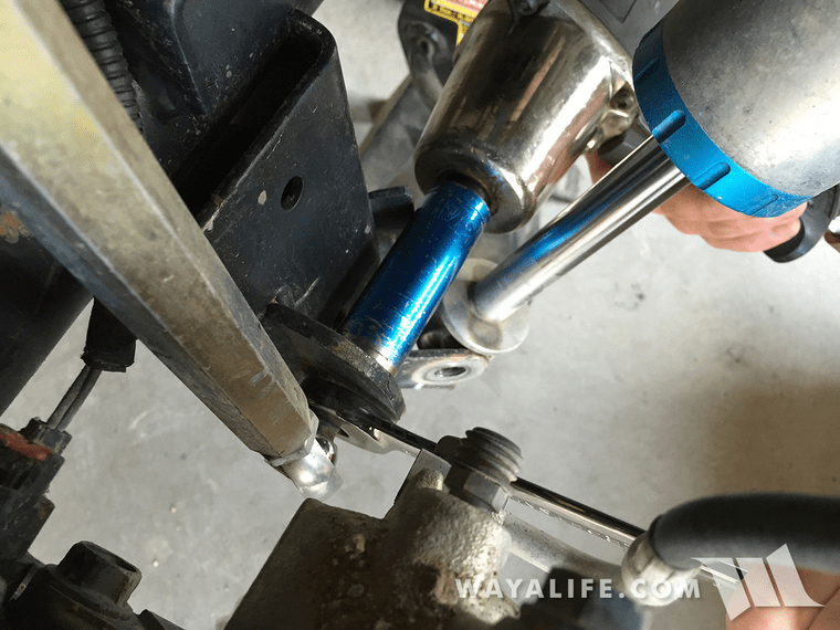

5. The bonded rubber bushings on your factory lower control arms will prevent it from rotating down and out of the axle mount. Using a 21mm socket and wrench, loosen but do not remove the bolt and nut securing the control arm to the frame mount. Allow the control arm to rotated down onto the ground.

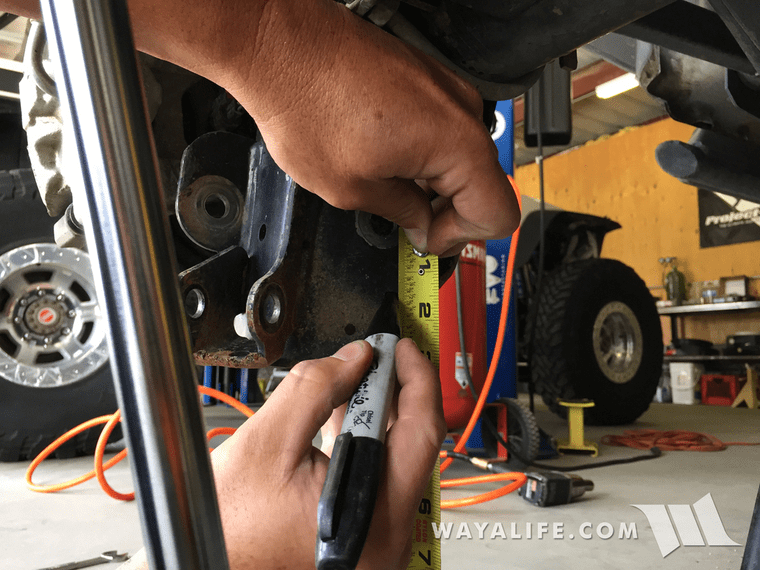

6. Measuring from the center of the axle mount hole, make a clear mark 1-1/2" down using a Sharpe or grease pencil and then continue that line all the way around the entire mount.

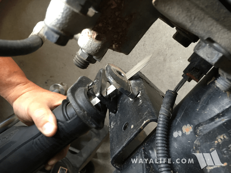

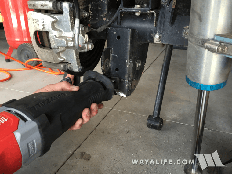

7. Using a sawzall or grinder with a cutoff wheel, remove the shock mount from the control arm mount as shown.

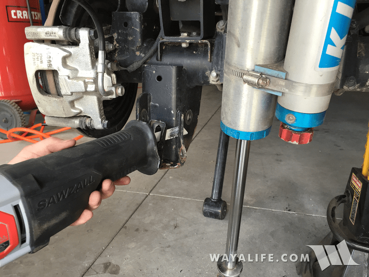

8. Using a sawzall or grinder with a cutoff wheel, cut the mount off along the line you drew back on step #6.
9. Finally, using a sawzall or grinder with a cutoff wheel, cut the sway bar mount off and then grind down what's left of all the mounts using a grinder with a flap disc.

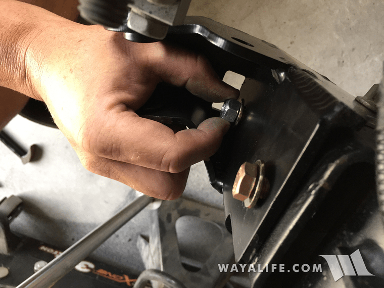

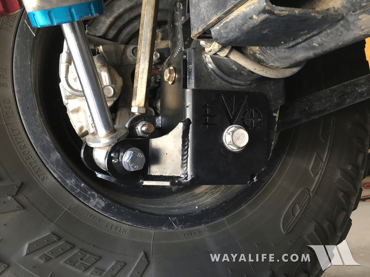

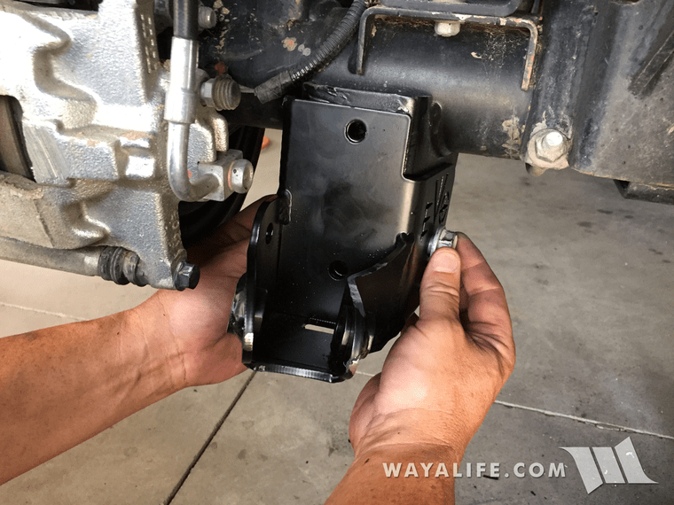

10. Loosely install your new EVO Rockstar onto your factory axle mount using the new control arm bolt provided with the kit.

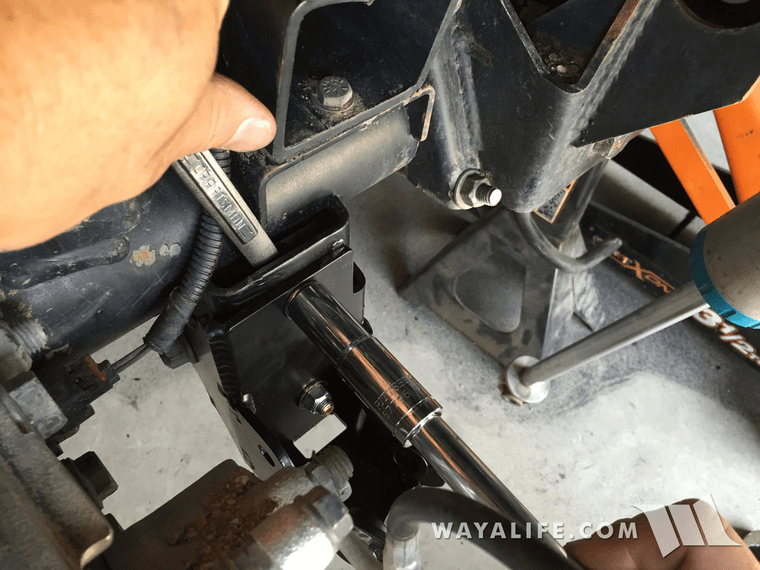

11. Install the provided nuts, washers and bolts through the EVO Rockstar mount as shown. Please note that the upper bolt goes through the face and that the lower bolt comes through it from behind and secured in place with a nut.

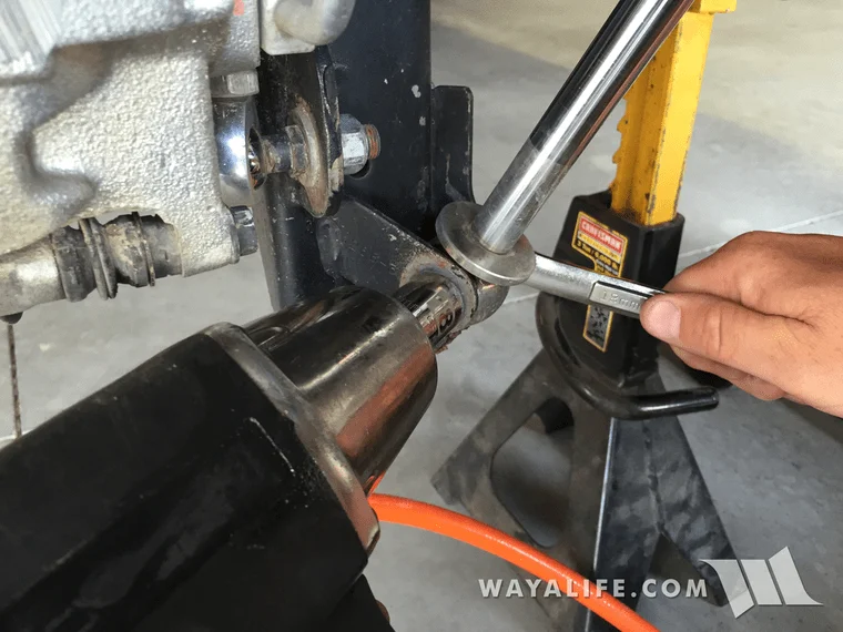

12. Using a 9/16" wrench and socket, secure the bolts and nuts in place.
13. Reinstall your lower control arm and secure it in place using the new bolt and nut provided. Install your sway bar link and shock onto your new EVO Rock Star mount and then repeat the whole process on the passenger side of your Jeep. When finished, reinstall your wheel, lower your Jeep back onto the ground and then make sure to tighten your control arm bolts to 125 ft. lbs. of torque.
