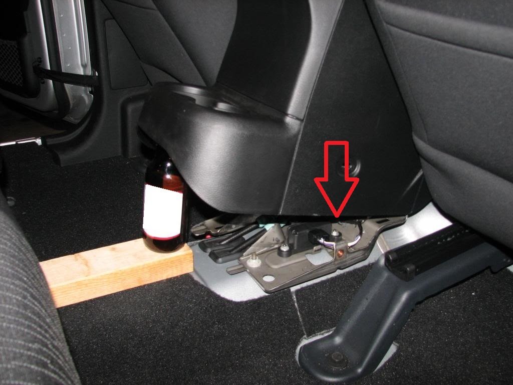

Open the driver's side front and rear doors for some working room and locate the main wire harness behind the center console. Gently cut through the outer casing to reveal the wire bundle as shown in Figure 1.
Figure 1. Wire bundle to locate.

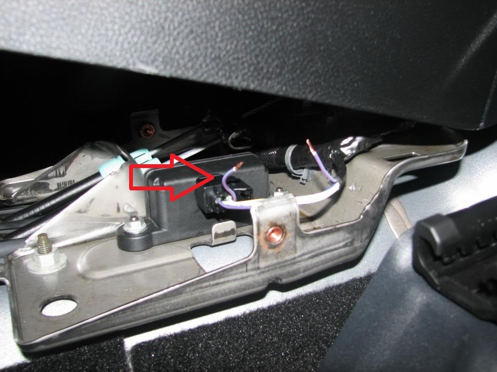

It is important to locate the correct wire, as there are both purple/blue and purple/light blue wires in this particular harness. You will need to work on the purple and light blue wire as shown in Figure 2.
Figure 2. This is the correct wire to cut.

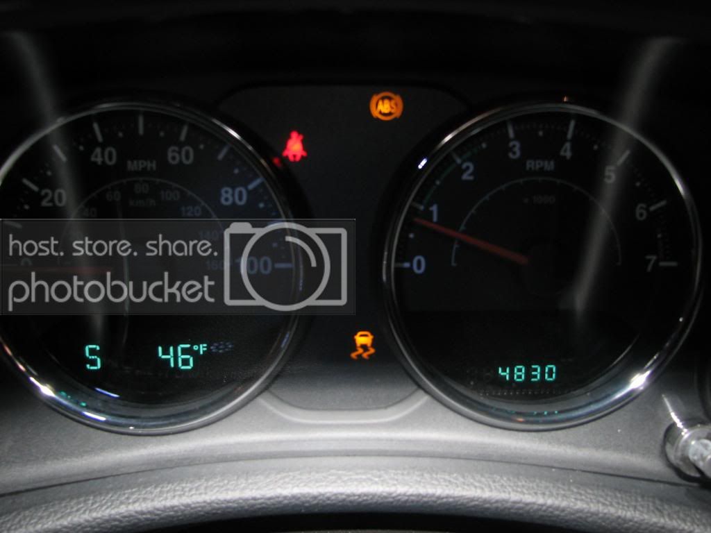

Before proceeding with the switch installation, cut the purple and light blue wire to verify if it's the correct one. Start the Jeep and take a look at the dash. There should be three lights illuminated: traction control, ABS and ESP OFF (shown in Figure 3). Then you know you cut the right one!
Figure 3. These are the indicators you should see.

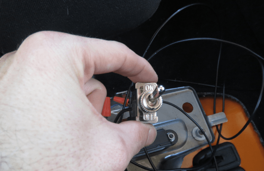

Step 3 – Install the kill switch
Now that we have the right wire, it's time to install the switch. This is a simple on/off toggle switch with two prongs (see Figure 4), so you just need to connect each end of the wire to the two prongs of the switch. Strip off enough of the insulation to get adequate wire around each prong, and slide a butt connector down each wire. Next, connect the wire to the prongs and put a drop of solder to make a good connection. Then slip the butt connector over each prong and tighten.
Figure 4. Toggle "kill" switch.
Step 4 – Test the switch
With the switch wired in place, set it to the on position to complete the circuit and verify that none of the indicator lights come on. Next, turn the switch off to open the circuit and you should see the three indicator lights illuminate; your kill switch is now functional. Keep in mind that any time you decide to flip the kill switch, you would have to turn the Jeep off and on to reset the system.
