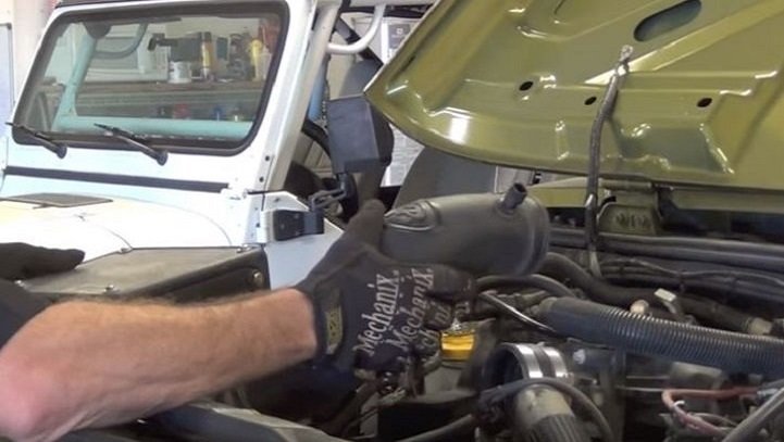

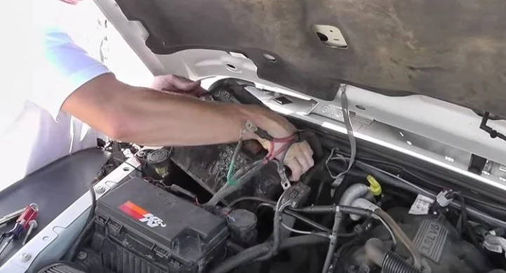

Step 1 – Remove air box or cold air intake system
  • Pop the hood latch, raise it, and secure your hood.
  • Use a flat head screwdriver to loosen the clamps on your main air hose at the intake. Keep it attached to the air box.
  • Disconnect the wiring harness from the main air hose and just move it out of the way.
  • Remove the bolts that mount the air box to the frame.
  • Pull off the air box and the main hose as one unit.

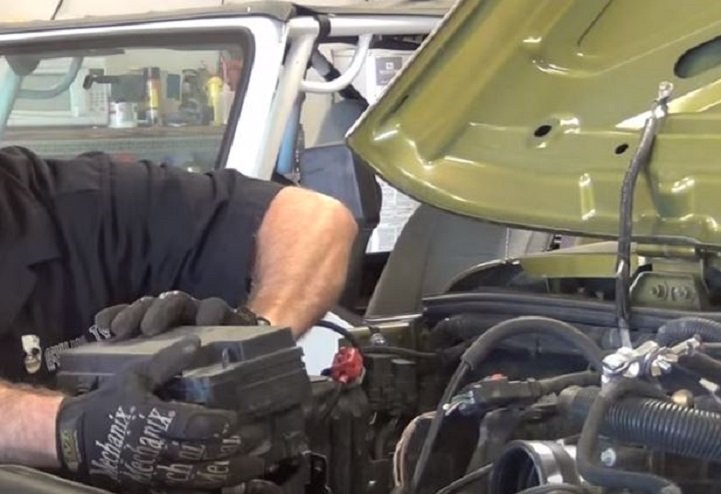

Figure 1. Disconnect this wiring harness quick release clip by pressing in on the sides and it will pop right off the intake hose.

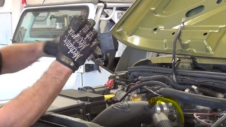

Figure 2. Remove the air box and large hose as one complete unit and set aside.

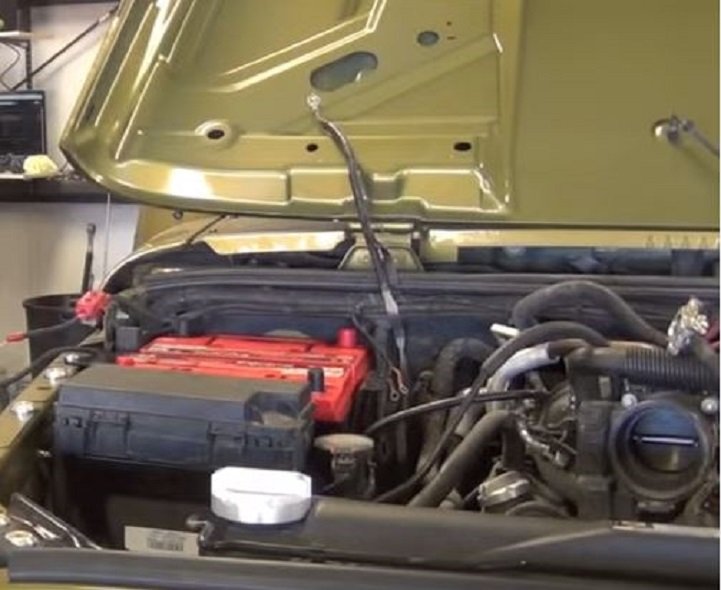

Step 2 – Disconnect and remove your old battery
  • Locate your existing battery on the passenger side close to the firewall.
  • Use a ratchet with extension and 10mm socket (a box wrench will work on the posts, but the ratchet and extension is needed for the mounting bolt on the battery tray).
  • Remove the accessory wires from the battery posts, then remove the main battery terminal cables from the posts.
  • Remove the mounting bolt from the battery tray and remove the retention block, as well.
  • Lift the battery straight up and out of the engine compartment, then set aside.

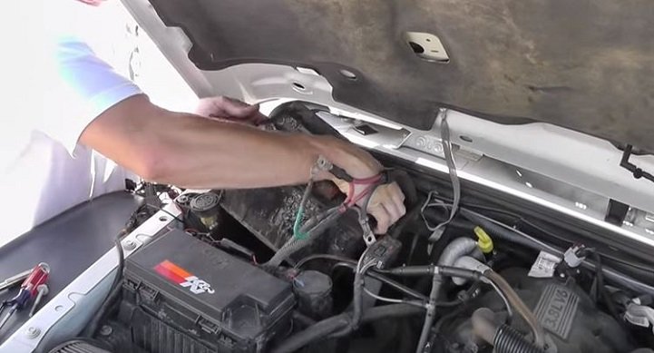

Figure 3. Disconnect the battery cables as well as mounting bolt, then lift the battery off the tray and set aside.

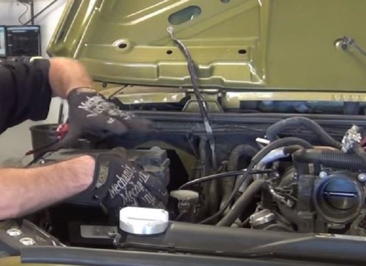

Figure 4. Take special care when removing the fuse box.

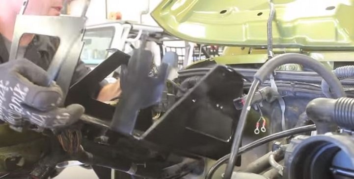

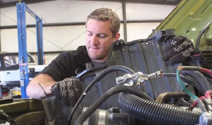

Step 4 – Remove the old battery tray
With the air and fuse boxes as well as the old battery removed, the battery tray can be lifted out. Remove any mounting screws in order to lift out the tray. You will likely have to contort the tray a little to get it out of the engine compartment. Be careful that you don't damage any of the wires trying to pull this large part out. The air box tray is attached to the battery tray as one unit. It will need to be cut out.
Figure 5. The battery tray in your Wrangler is large and a bit awkward to get out. You'll have to twist and turn it around while lifting.

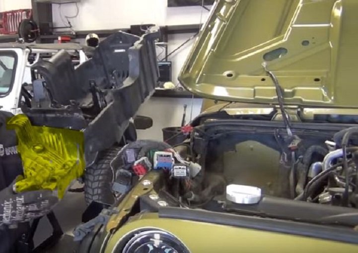

Figure 6. The yellow highlighted are is the tray for the air box. Use a hacksaw to cut out this part to ensure the bolt holes match up.

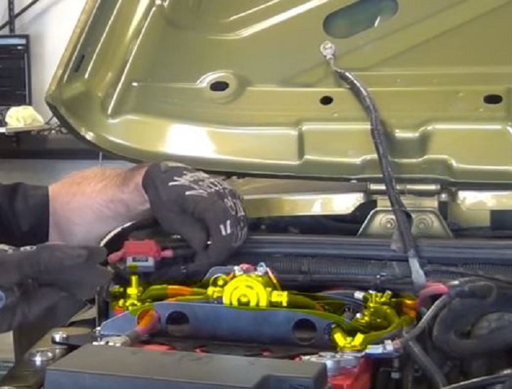

Step 9 – Reconnect battery cables

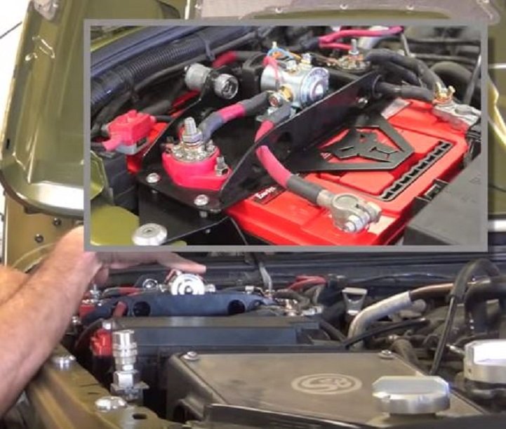

This particular kit comes with a buss bar system, which avoids all the screws and bolts holding the wires in place. The accessory cables simply plugs right into its own port on the buss bar. The bar sits on top of the batteries in between the posts and all the accessory cables are neatly arranged as well as plugged into it. Feed the battery terminal cables through the frame holes on the buss bar and make the connections to the battery terminal posts. This setup allows the accessories to be wired separately from the cranking wires via the smart isolator that is mounted in between the buss bars on top of the battery. This system isolates the accessories to one battery while the engine is not running, leaving the other battery fully charged for enough power to start the engine. Once the engine is running, the alternator then only needs to recharge one battery at a time, thus preventing the need for an upgraded alternator.
Figure 10. Reconnect all the accessory wires and terminal cables to the battery via the buss bar that sits on top of the dual batteries.
