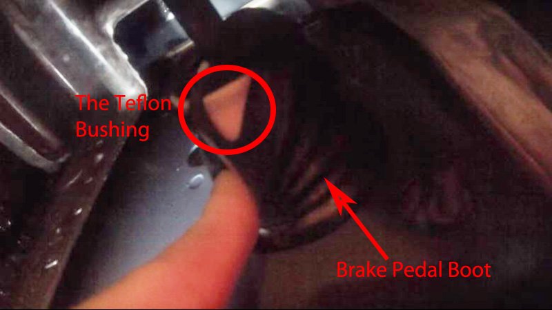

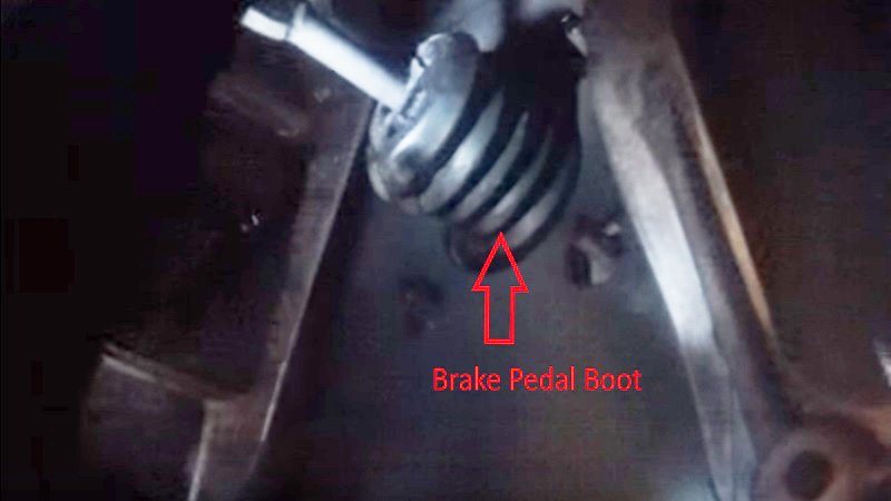

Behind the brake pedal you'll see a rubber boot. This boot is designed to keep the grease on the bushings and dirt out. Carefully pull the boot towards the firewall to expose the white teflon bushing. Apply some synthetic grease or similar lubricant to the surface of the bushing. Press and release the brake pedal several times to spread the grease throughout the bushing. You may have to repeat the application several times through the next week to reach all areas on the bushing with a dry surface.
Figure 1. The brake pedal boot.
Figure 2. The brake pedal bushing (circled).
