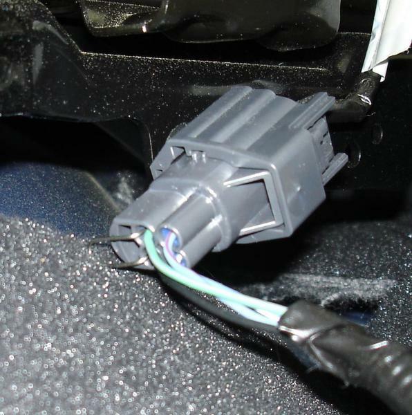

Option 2 – Disconnect the connector
Using a paperclip, join the green and black wires on the connector located underneath the driver's side seat of your Jeep Wrangler. Doing so will disable the chime. This modification is reversible; simply reconnect it when desired.
Figure 2. This is the connector.

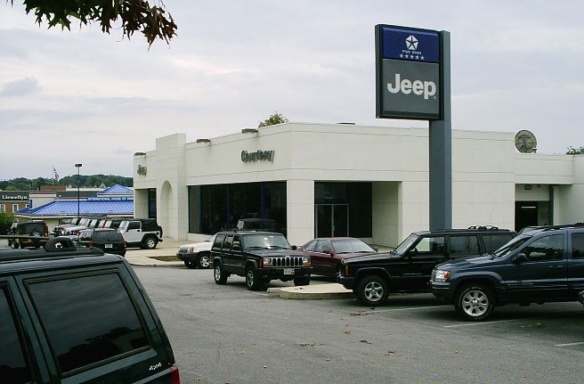

Option 3 – Visit a local Jeep dealership
For a small fee of around $20 to $40, a local Jeep dealership can disable (or enable) the seat belt chime in your Jeep Wrangler. This step is generally recommended for those Jeep owners who can't work fast enough to complete the job on their own. Otherwise, save your money and complete this easy modification on your own.
Figure 3. Make an appointment for faster service.

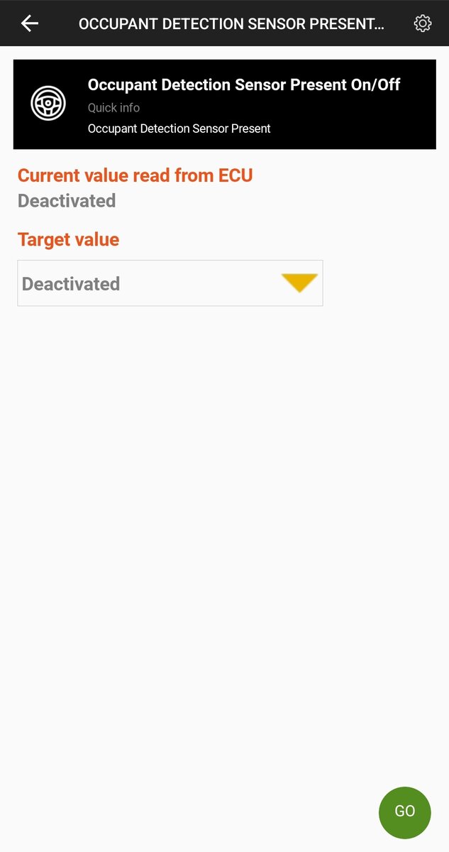

I would think JScan would also do this, maybe someone who has it could check to see if it does.
