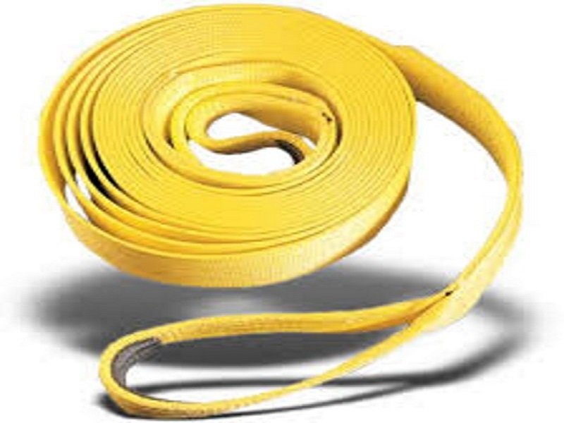

To start, you need the correct recovery/towing equipment. Tow straps differ from recovery straps. Tow straps are designed not to stretch to increase safety as the towed vehicle is traveling behind you. Recovery straps use elasticity to stretch than shrink. This force helps propel the vehicle from its stuck, stationary position. Tree straps are used to safely anchor to a tree. These straps distribute the force evenly around the tree to lessen the chance of damage to the tree and strap.

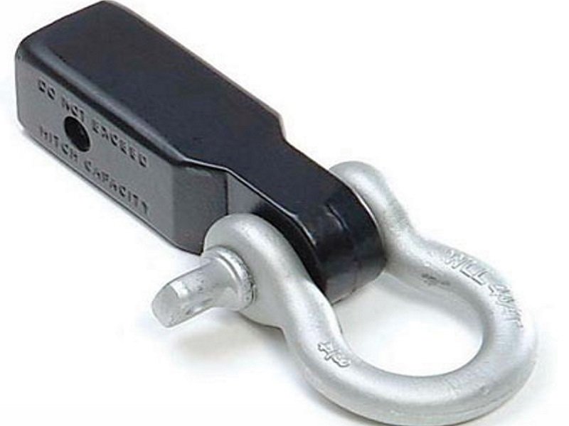

The smartest ways to tow/recover another vehicle are by using factory tow hooks or tow points. Another way is using a recovery hitch mounted to the rear of the vehicle. Another method (although not very safe) is using a short length of chain with a set of hooks. These hooks can be attached to the frame. Make sure your equipment is rated above the capacities of the vehicle being towed.

Figure 1. A recovery strap.
Figure 2. A recovery hitch.

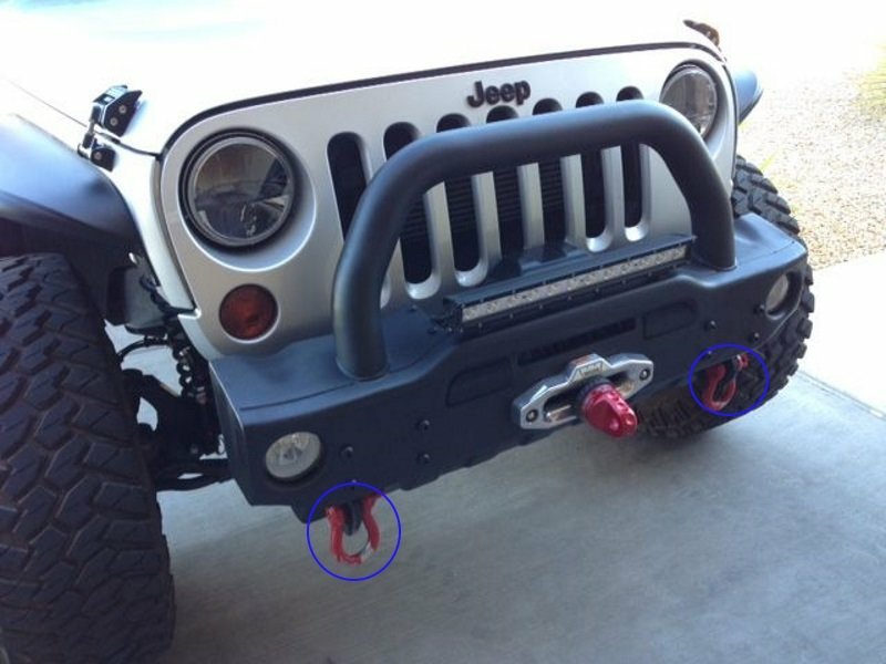

Figure 3. Attaching D-rings to front tow points for easy strap connection.

  7. Never place a D-ring in the middle of the two straps.
  8. When closing in a D-ring, once threaded all the way in, back it out a quarter turn for easy de-latching when complete.
