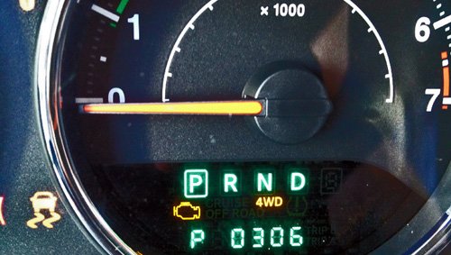

Figure 1. Engine code on instrumental panel.

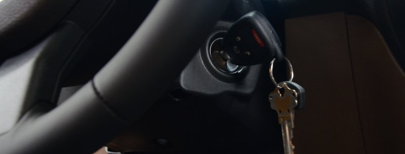

Step 2 – Turn key to ON position
Insert your key into the ignition and turn it to the ON position, but don't start the car. Push the key into the ignition and turn it to the OFF position, while holding it in. Then turn it back to the ON position. Repeat this process three times in a row and stop on the ON position on the third time.
Figure 2. Turn the ignition from ON to OFF three times, while pressing it inside.
Step 3 – Read the code
When and if you do Step 2 successfully, the dash light will turn on and off, then a code will appear. Take a note of that code. However, if you get a massage that says "done," it means you have no codes to read. If nothing happens after Step 2, repeat it and be sure you are not waiting too long between turning the ignition on and off.
