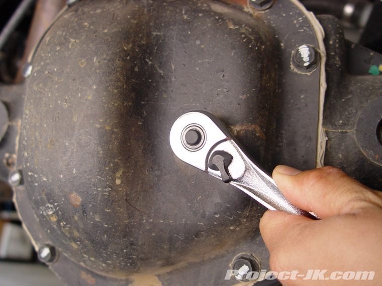

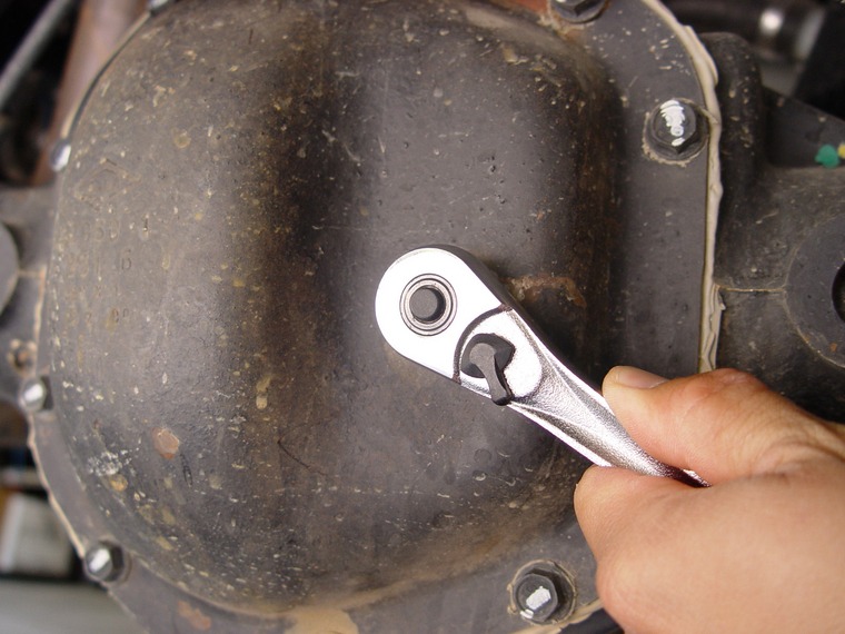

1. Using the square head of a 3/8" Drive ratchet, remove the fill bolt from your differential cover.

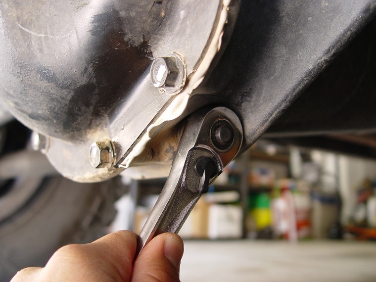

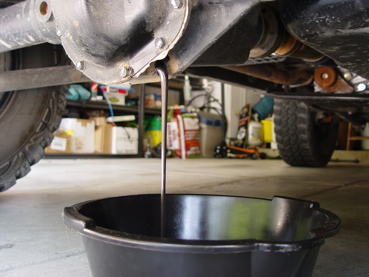

2. Place an oil catch pan underneath your differential. Then, using a 3/8" drive ratchet with a 3" extension attached to it, remove the drain bolt from the base of it as shown.
3. Allow your differential to drain completely before proceeding.

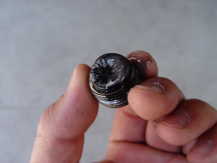

4. Your Jeep JK Wrangler’s drain bolt is magnetic and the inside end of it should be fuzzy with fine iron filings. Use a paper towel and some brake cleaner to wipe the bolt clean.

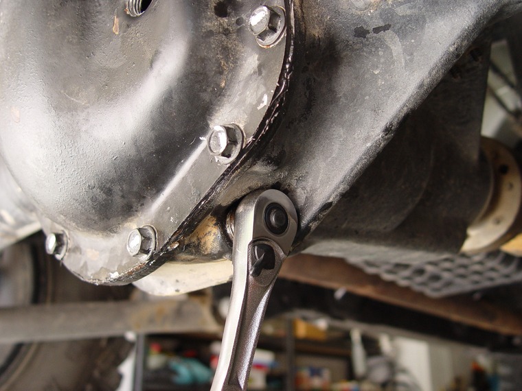

5. Using a 3/8" drive ratchet with a 3" extension attached to it, reinstall your drain bolt back on to the base of your differential. Tighten this bolt to 25 ft. lbs. of torque.

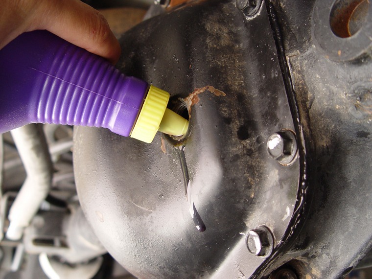

6. Proceed to refill your differential with gear oil. Please note that a front Dana 44 differential only needs 2.7 pints (1.35 quarts) and the rear only needs 4.75 pints (2.375 quarts). If you have factory covers, all you need to do is fill up your differentials until gear oil oozes out of the fill hole. If you have an after market differential cover that has a higher fill hole than factory, DO NOT be tempted to add any more gear oil than is needs. Doing so will result in a differential that is over-filled that will cause gear oil to get pumped out of the breather tube. If you are unsure how much you'll need in your axle, a good rule of thumb to follow is that you only need as much gear oil as is needed to get it to reach the bottom of your axle tubes. You can use a zip tie bent in a 90° angle to act as a dip stick to help you know where that is. NOTE: IF you have a limited slip differential, you will need to add friction modifier into your differential or, be sure to use a synthetic gear oil as it will have friction modifier in it.
