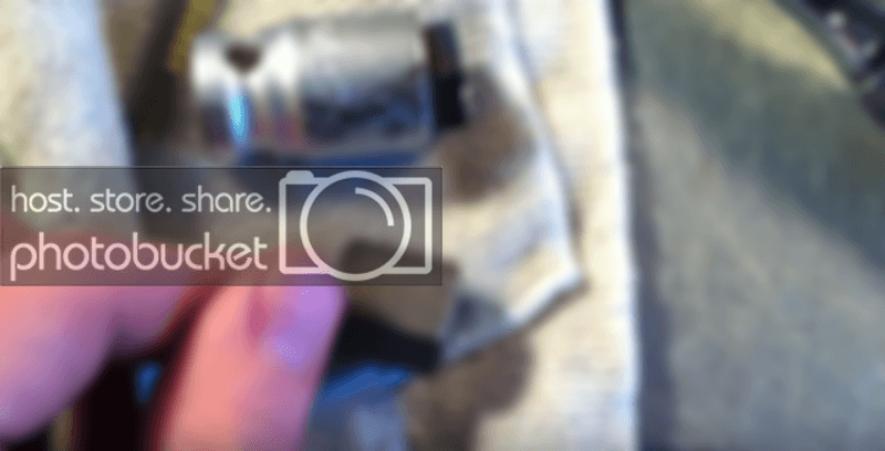

Step 1 – Make custom Allen key bit
The drain plug for your transmission is actually located an inch above the exhaust pipes. This makes loosening it a difficult task, unless you have a special tool for the job. The following instructions explain how to quickly make such a tool.
  • Take a 17mm Allen key bit and place it securely into a vice.
  • Measure approximately half an inch of the bit and cut the rest off using a sawzall.
  • Grind the edges of the bit (optional).
Figure 1. Cut the 17mm Allen key bit.

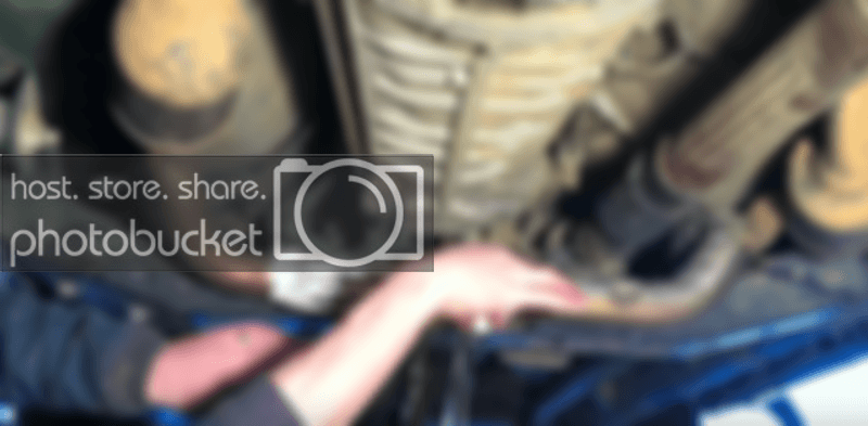

Step 2 – Place a drain pan under the transmission
Old transmission fluid is a terrible mess to clean up, so let's make it a point to avoid any unnecessary spill-ups. Place a drain pain directly under the transmission and place a rag on top of the exhaust pipe.
Figure 2. Cover the top of the exhaust pipe.

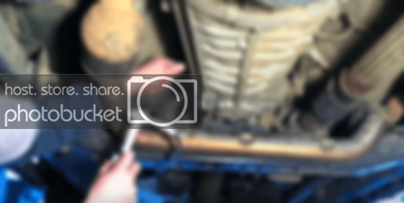

Step 3 – Drain the transmission fluid
Loosen both the fill and drain bolts. The fill bolt is found on the passenger's side of the transmission, and requires a 17mm Allen key bit to be removed. For the drain bolt, take your newly created 1/2 inch Allen key bit, insert it into the socket and use a 17mm wrench to loosen it. Once off, let the fluid drain into the oil pan.
Figure 3. Drain the transmission fluid.

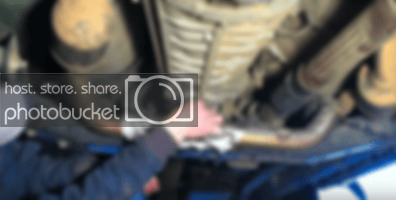

Step 4 – Refill the transmission fluid
  • Install and tighten the drain bolt.
  • Take the bottle pump and place the line into the fill port.
  • Pump two quarts of transmission fluid into the casing.
  • Install and tighten the fill bolt.
Figure 4. Pump new fluid into the transmission.
