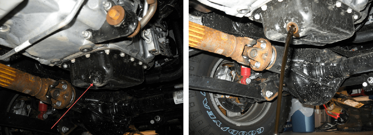

  • With the vehicle sitting on a level surface, position your catch pan under the engine oil pan.
  • Using a 13mm socket and ratchet, remove the oil pan drain plug and catch the draining oil in the catch pan.
  • Let engine oil drain while replacing the oil filter.
Figure 1. Location of oil pan drain bolt.
Pro Tip
An additional amount of oil tends to drain through the pan drain hole when removing the oil filter, which would otherwise not occur if reinstalling the drain bolt before changing the filter.

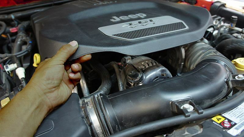

  • Remove the engine cover by lifting the front edge and pulling the entire cover forward. Set cover aside.
Figure 2. Engine cover removal.

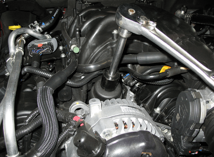

  • Remove the oil filter cap using a 24mm socket, ratchet and extension.
Figure 3. Filter cap removal.

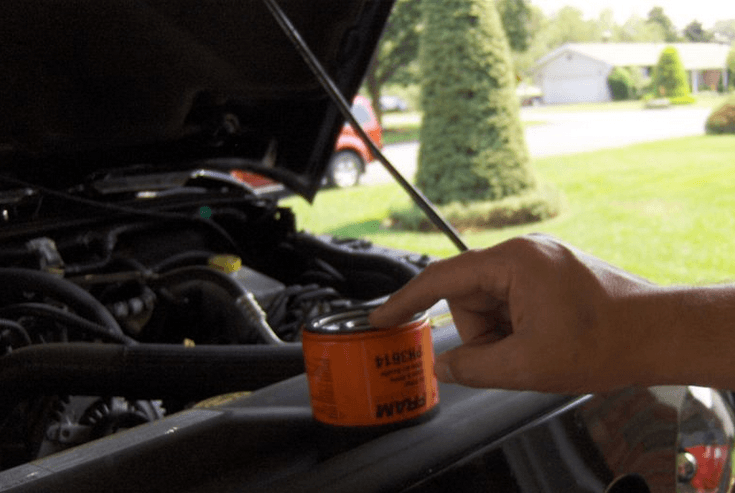

  • With a catch pan handy, lift the oil filter cap and filter element from the filter housing.
Figure 4. Filter cap and filter element removal.

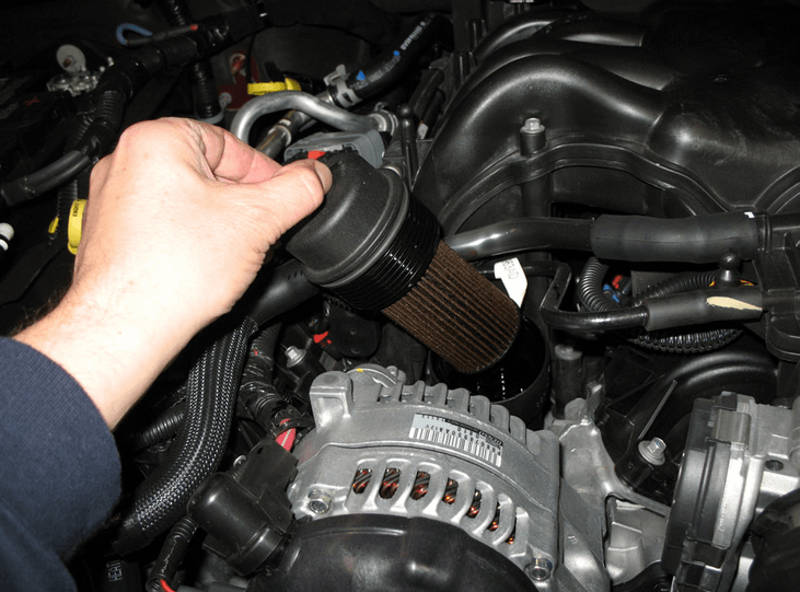

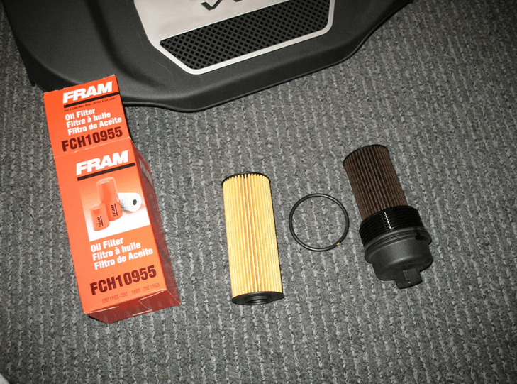

  • Replace the O-ring on the oil filter cap as well as the filter element. The filter element simply pops into place on the cap. Apply a light coat of oil to the O-ring before re-installing.
Figure 5. New filter element and O-ring.
  • With the new filter in place, tighten the filter cap to approximately 18 ft/lbs.

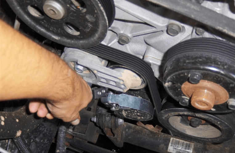

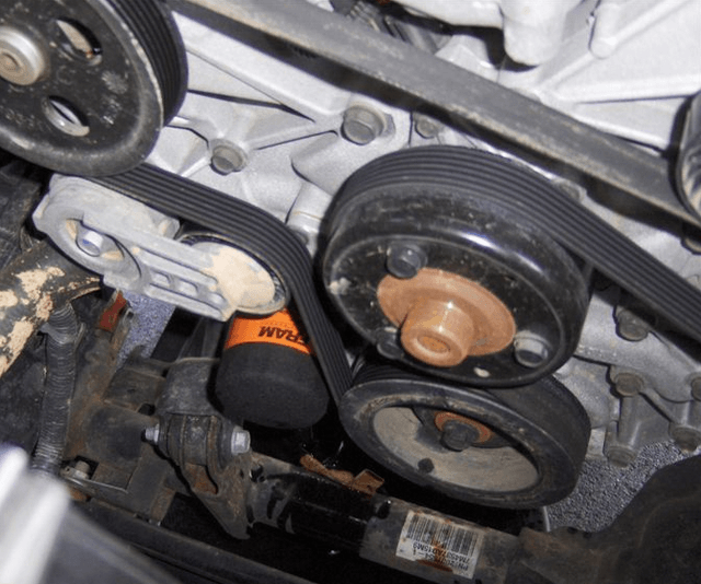

The oil filter is located on the lower front side of the engine next to the crank pulley (passenger's side) and is best accessed from the topside of the engine bay.
  • Position a catch pan below the oil filter.
  • Using an oil filter wrench (optional), loosen and remove the filter. Spin-on filters can often be loosened by hand or with a large set of pliers if a filter wrench is unavailable.
Figure 6. Filter located next to crank pulley.

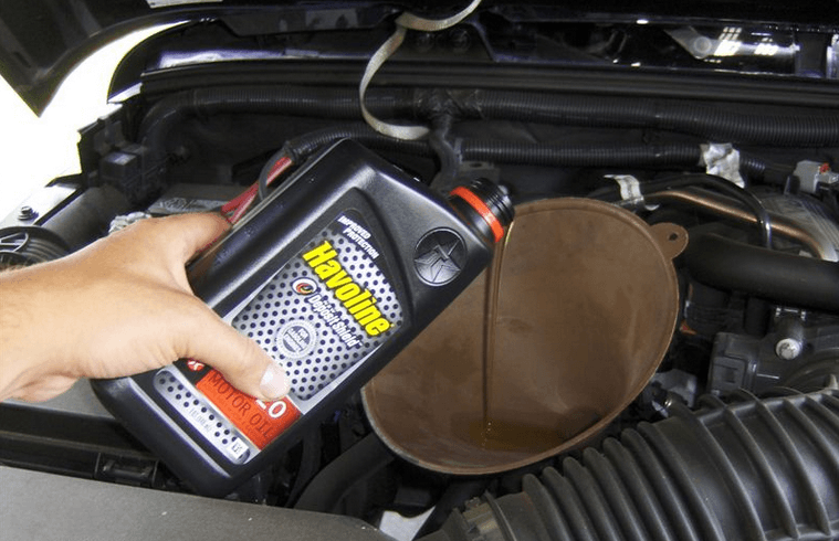

  • Remove the oil filler cap and, using a funnel, fill with six quarts of your preferred engine oil.
  • Replace the filler cap when done.
Figure 9. Filling engine with oil.

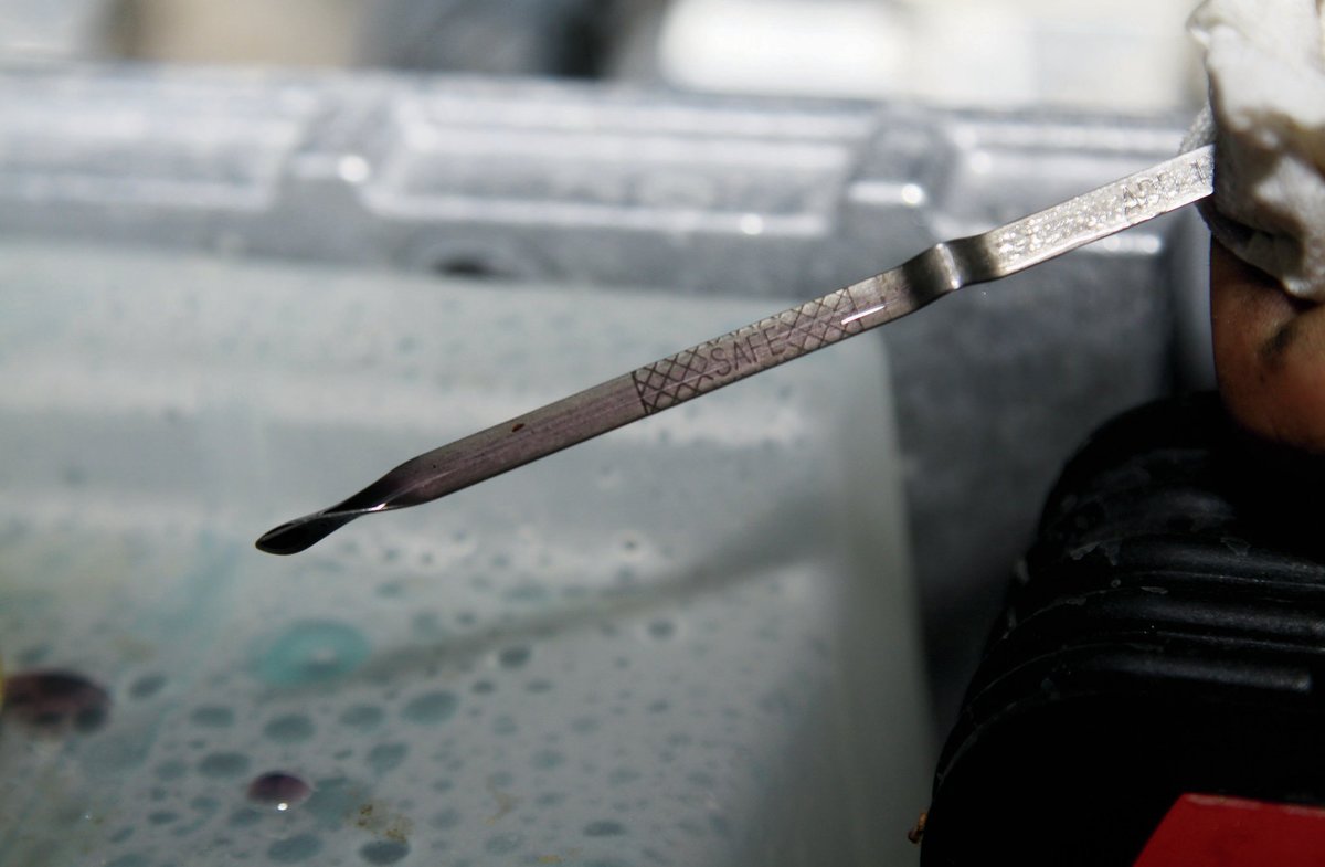

  • Shut the engine off and let sit at least five minutes before checking the engine oil level.
Figure 10. Inspecting engine oil level.
