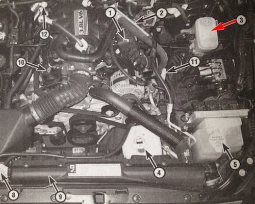

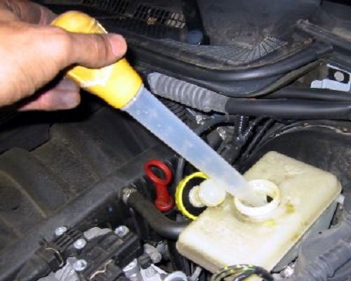

The first thing you will want to do is locate the brake fluid reservoir. It is item number three in Figure 1. Next remove the cap, and using your turkey baster or other suction device, remove all of the old brake fluid from the reservoir. Just get as much as you can out of the reservoir, being careful to not spill any brake fluid on your paint.
Figure 1. Jeep Wrangler engine compartment.
Figure 2. Turkey baster brake fluid removal.

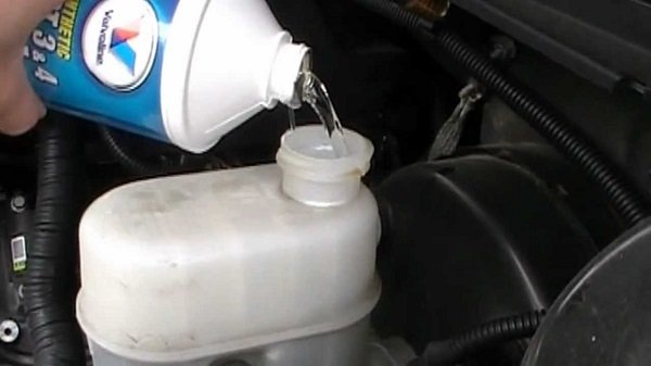

Next, take the new DOT 3 brake fluid you have purchased and fill the reservoir with it. It is okay to fill above the max line because you will be drawing the new fluid through the brake system, so you will want some excess in the reservoir.
Figure 3. Fill brake fluid reservoir.

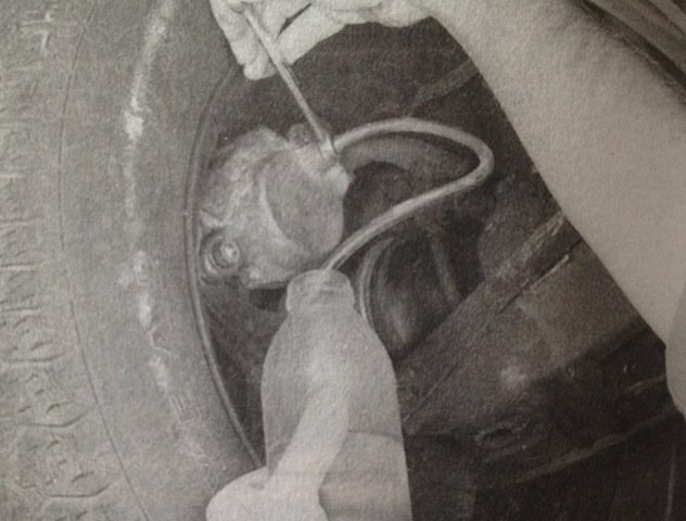

  • Place the tube of the catch can over the bleeder valve on wheel that you are going to be bleeding. Start with farthest corner from master cylinder first and work your way to the closest.
  • Have an assistant slowly depress and hold the brake pedal in the depressed position.
  • Open the bleeder screw enough to allow a flow of fluid to leave the valve. While doing this, keep an eye on the fluid being removed. It will be a dark color.
  • Tighten the bleeder screw.
  • Have assistant release the pedal.
  • Repeat steps 4 to 7 until you see fresh, lighter colored fluid coming out of the bleeder screw tube.
Figure 4. Drawing fluid from caliper into the catch can.
