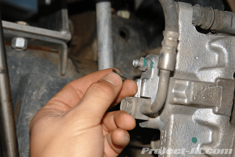

3. Remove the rubber cap attached to the brake caliper bleeder valve as shown in this pic.

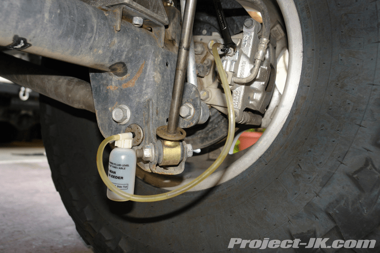

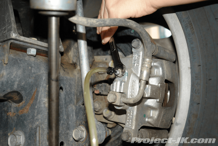

4. Place your 11mm wrench on the brake caliper bleeder valve/nipple and then insert the tapered fitting into it as shown in this pic (or over the nipple if you have a hose that will fit it). Attach the jar using the magnetic head anywhere below the nipple.
5. Have a friend sit in the driver seat with the engine off and then, on your command, have them push down on the brake pedal slowly to the floor.
6. While your friend is holding the brake pedal down, slowly loosen the brake caliper bleeder valve so that the fluid inside flushes out. You should be able to see the fluid and air bubbles moving through the clear vinyl hose in a burst. Once the flow stops moving, tighten the bleeder valve to close it off. Instruct your friend to release the brake pedal and repeat this process as many times as is needed until you see no more bubbles coming out.

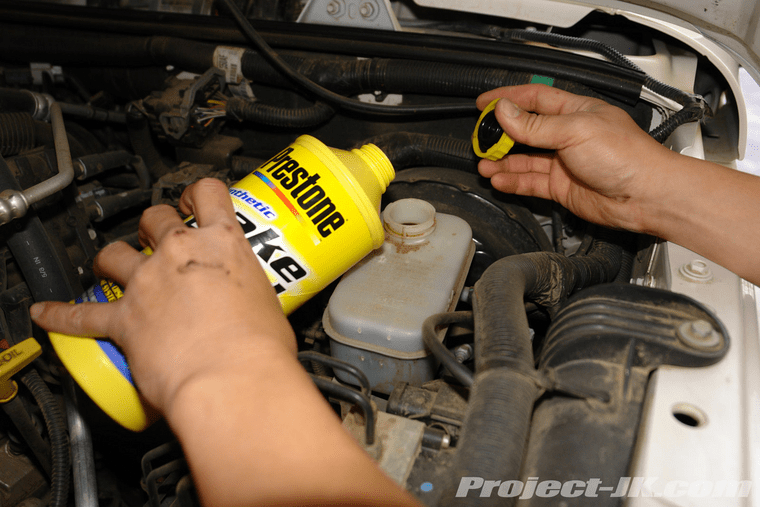

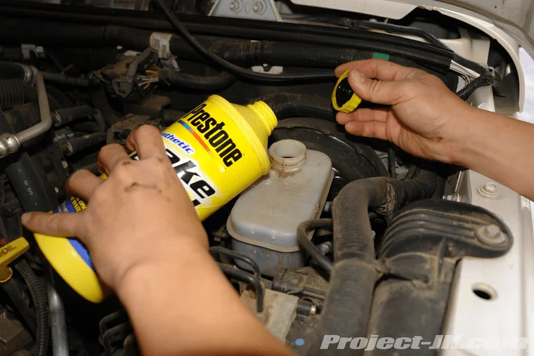

7. Reinstall the rubber cap, check the fluid level in your master cylinder and refill as necessary. Repeat the process on the driver side rear brake, passenger side front brake and last but not least, on the driver side front brake. It is very important to NOT let your master cylinder run dry during this process.
After you've bled all 4 brakes, give your master cylinder one last check and top it off if needed. Your brake pedal should now feel nice and firm.

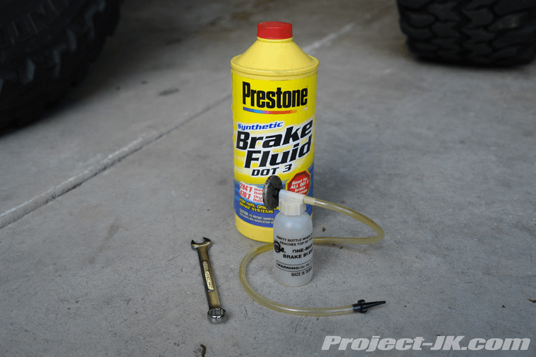

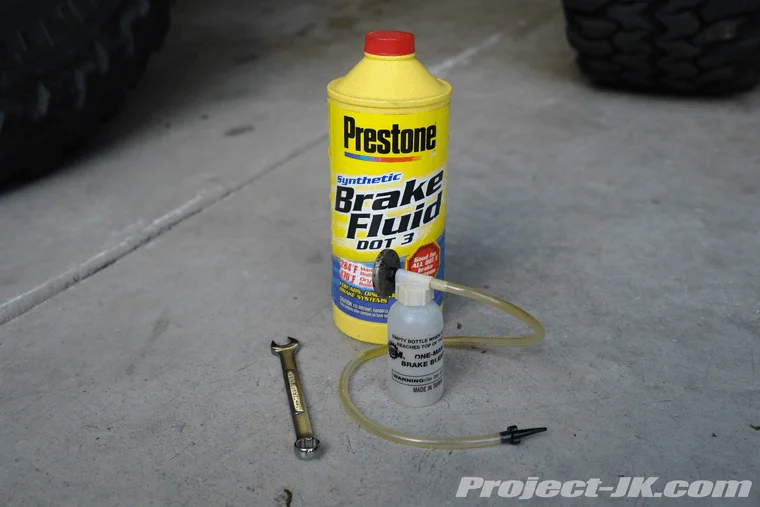

			What You Will Need
- DOT3 Brake Fluid
- 11mm Wrench
- Brake Bleeding Kit or 1/8" Vinyl Hose & Jar
- Rags
- A friend to help
