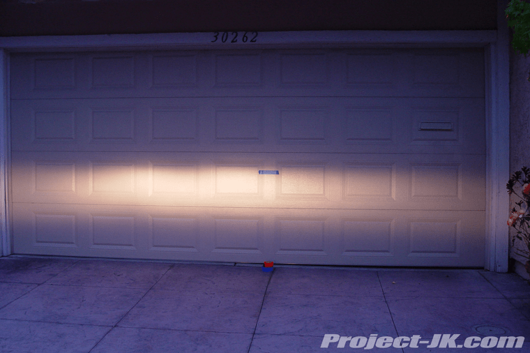

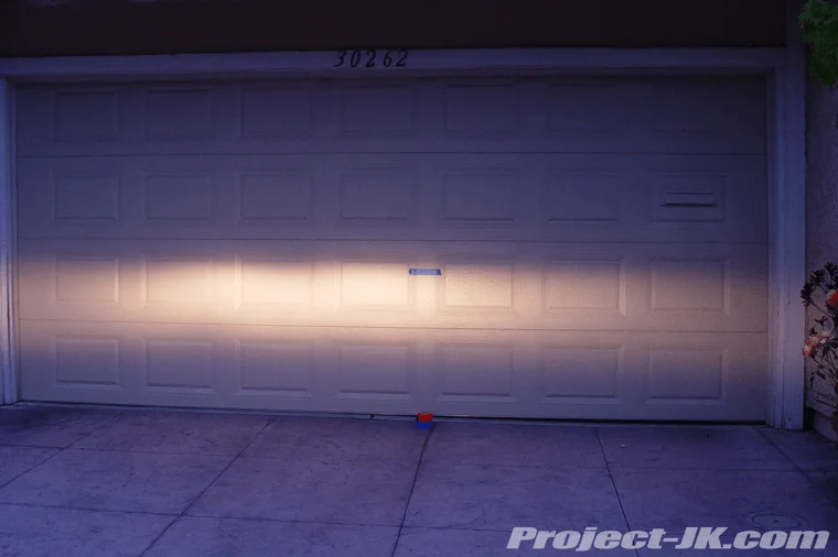

1. Park your Jeep 25′ back from a garage door or wall. Affix a strip of blue masking tape 3′ up from the ground. If you’ve just lifted your Jeep, you will see that your headlights are pointing above the tape as shown in this pic.

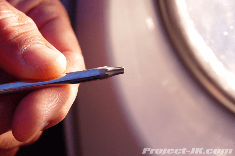

2. To adjust your headlights, you will need a Torx T-15 driver as shown in this pic. It is important that your driver is a stand alone tool and not an interchangeable universal driver that allows you attach different bits to it. Drivers of this nature will be to thick in diameter and will prevent you from accessing the adjustment screws.

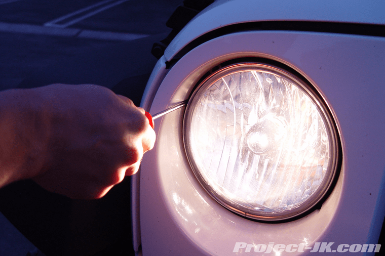

3. Insert your Torx T-15 bit into the adjusting screw slot which is located on the outside of your Jeep JK Wrangler’s headlight. On the passenger side, this will be located at about the 10 o’clock position and on the driver side, at the 2 o’clock position as shown in this pic.

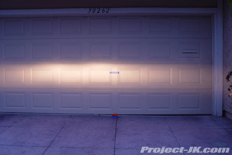

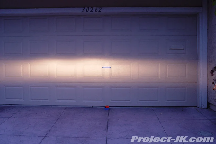

4. Using your Torx T-15 driver, turn the adjustment screw counter-clockwise until your headlight is pointing just below the blue tape on the garage or wall you attached it to.
And that’s all there is to it, you’re done. You should now have headlights with beams that point where they should be and not into the eyes of on-coming traffic.
