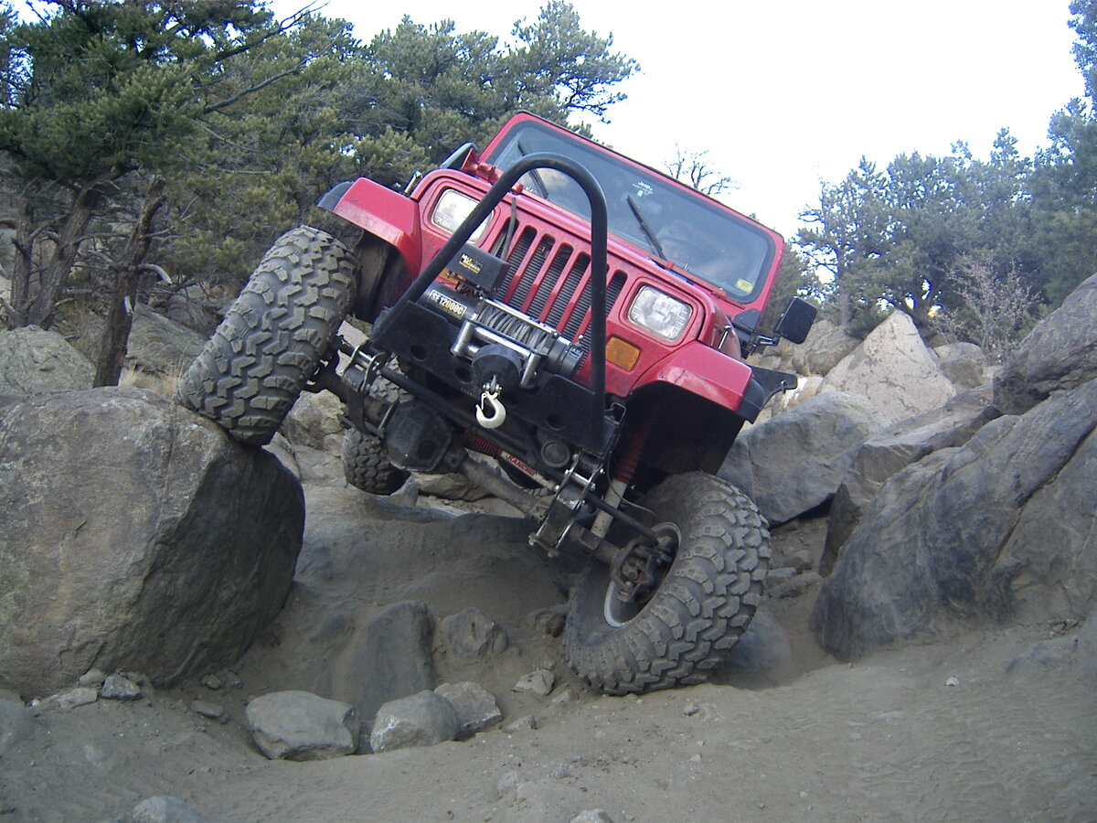

Hard flex can be very subjective. This is what we consider hard flex here.
