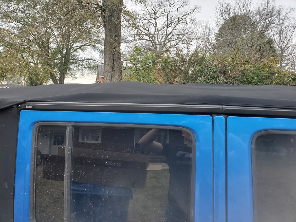

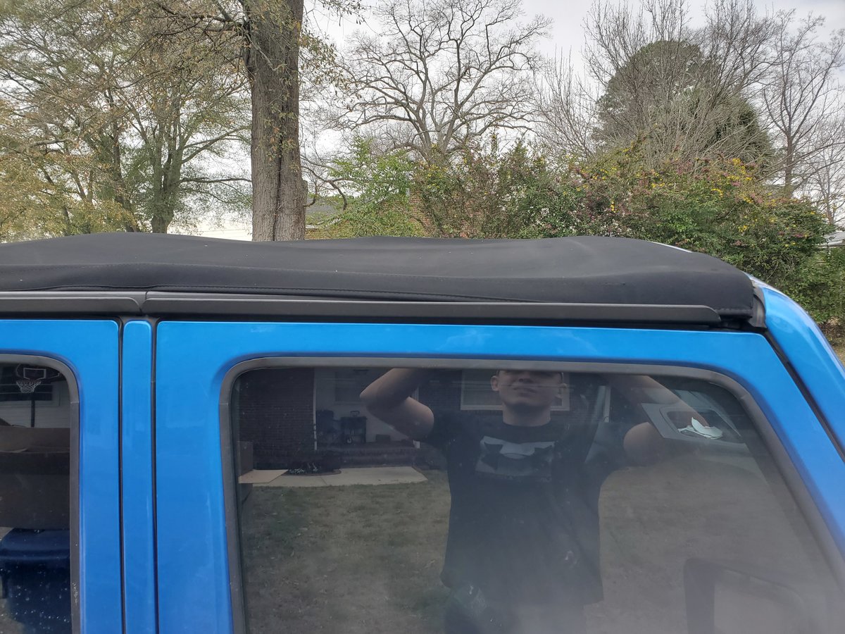

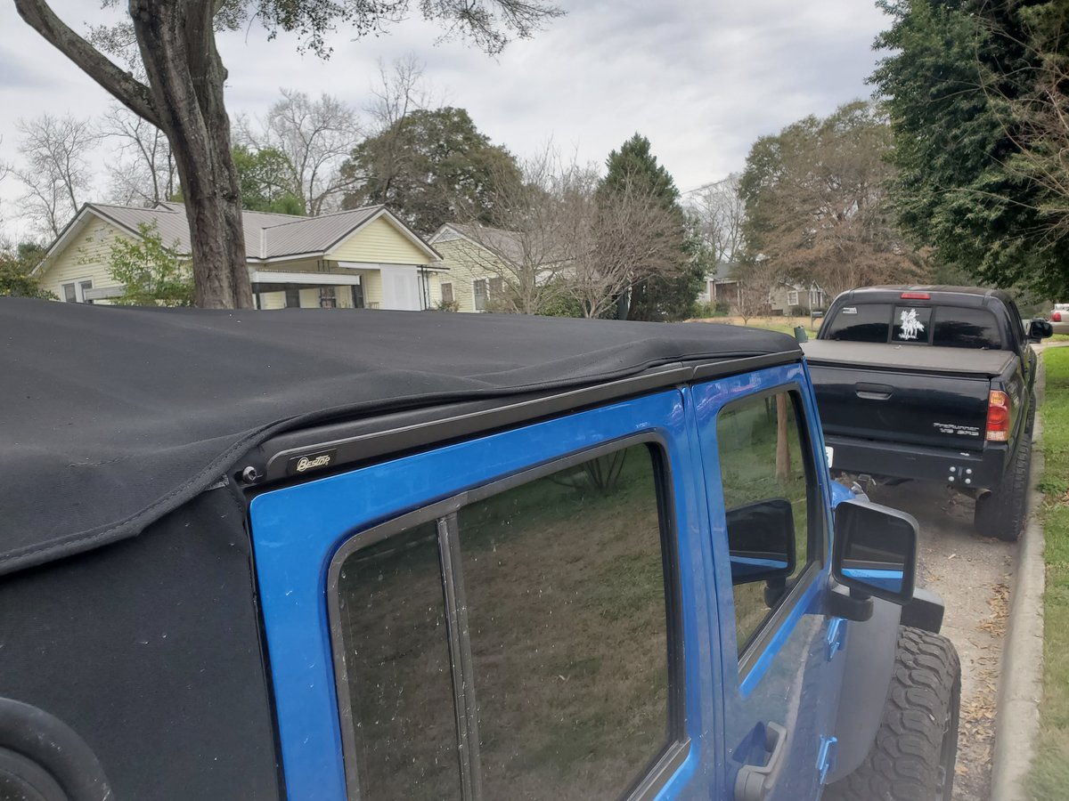

Newer jeep owner, only had it for a few months. I cant figure out how to get the top to seal properly. It's a semi hard top I believe the back window is hard glass side windows are plexi. I cant figure out how to get the passenger side to seal. I've watched all the videos on youtube. Anyone has any info please help.
What do you mean when you say "semi hard top"? Is it the factory hard top? Could you post some pictures so I know what you're dealing with?
It looks like you have the Trektop Pro Hybrid Soft top.
Here are the instructions, i would suggest disassembling and then reassembling from scratch to see if something is missing or out of place.
Bro thanks man. that's exactly the top I have and just looking over this I can see that there are parts missing. I'll figure it out though thanks a lot
