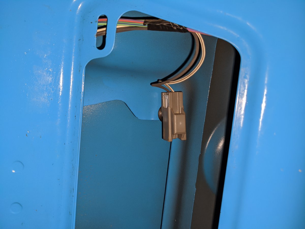

New buy. 2017 jk. Previous owner installed a spare tire delete with built in third brake light. I'm going to buy and install oem or similar third brake with a smittybilt tire carrier but am unsure of what I need for wiring to make sure I have what I need.
If you find a used third brake light that someone took off their JK, it will have the other end of the wire with the plug that goes in through the tailgate and plugs into that harness inside.
If I had kept mine I would have given it to you for free, but unfortunately I tossed it when I installed my AEV tire carrier and AEV third brake light setup.
