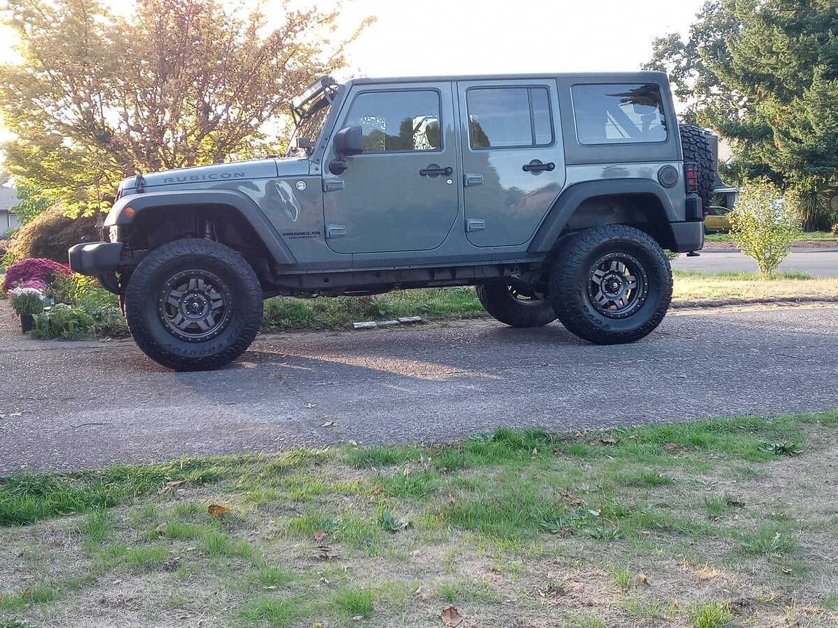

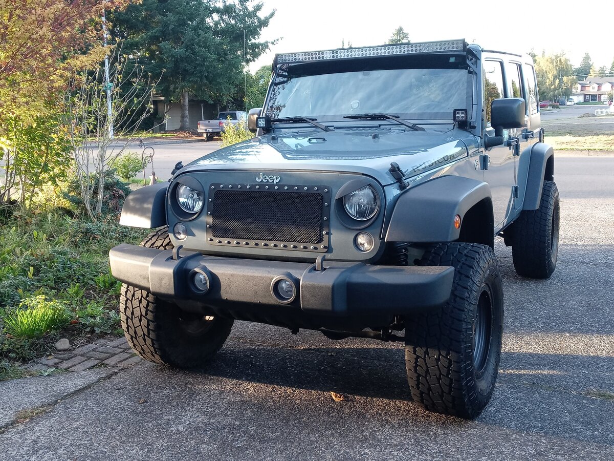

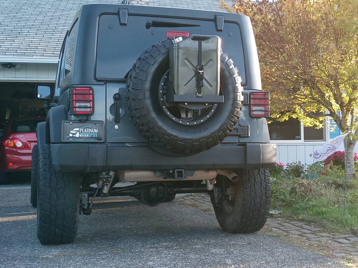

So what we really need is pictures.
Haven't taken pics underneath yet, but here's the shiny side...
