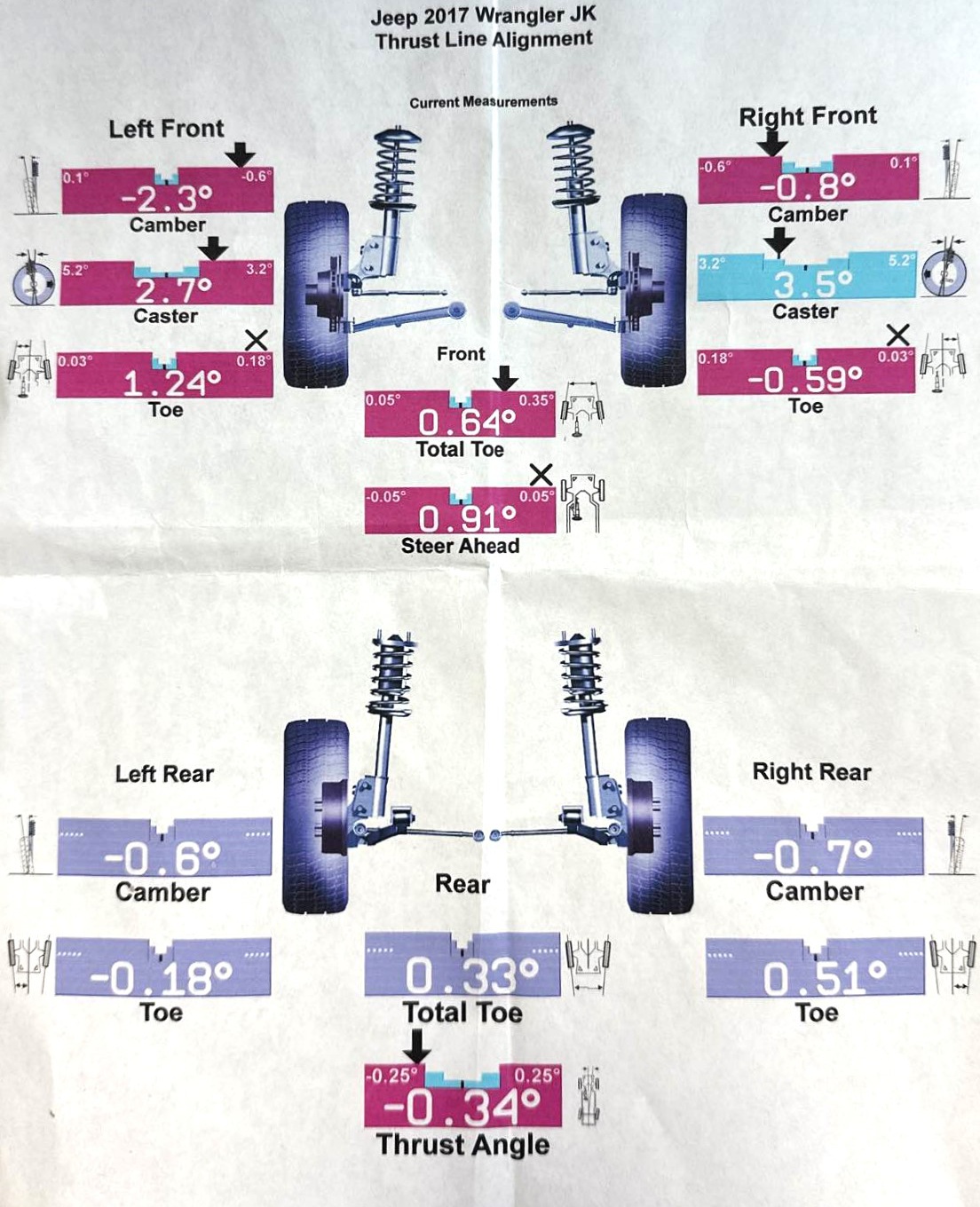

Jeep was in an accident that compressed the left front bumper back into the tire (Grill and hood were untouched). LCA was bent, front driveshaft was kinked, shock was bent. Axle was shifted probably 5 or so inches backwards on the driver's side. Axle has been looked over and looks fine. All of the above has been replaced and the alignment sheet still shows the above. (Also, the Jeep has a 2-2.5 inch RC lift and sits on 35s)
Thoughts on what the repair shop should look for next? UCA? UCA mount? They seem to be stuck and have had the Jeep six weeks already.
Thanks in advance for any thoughts!
