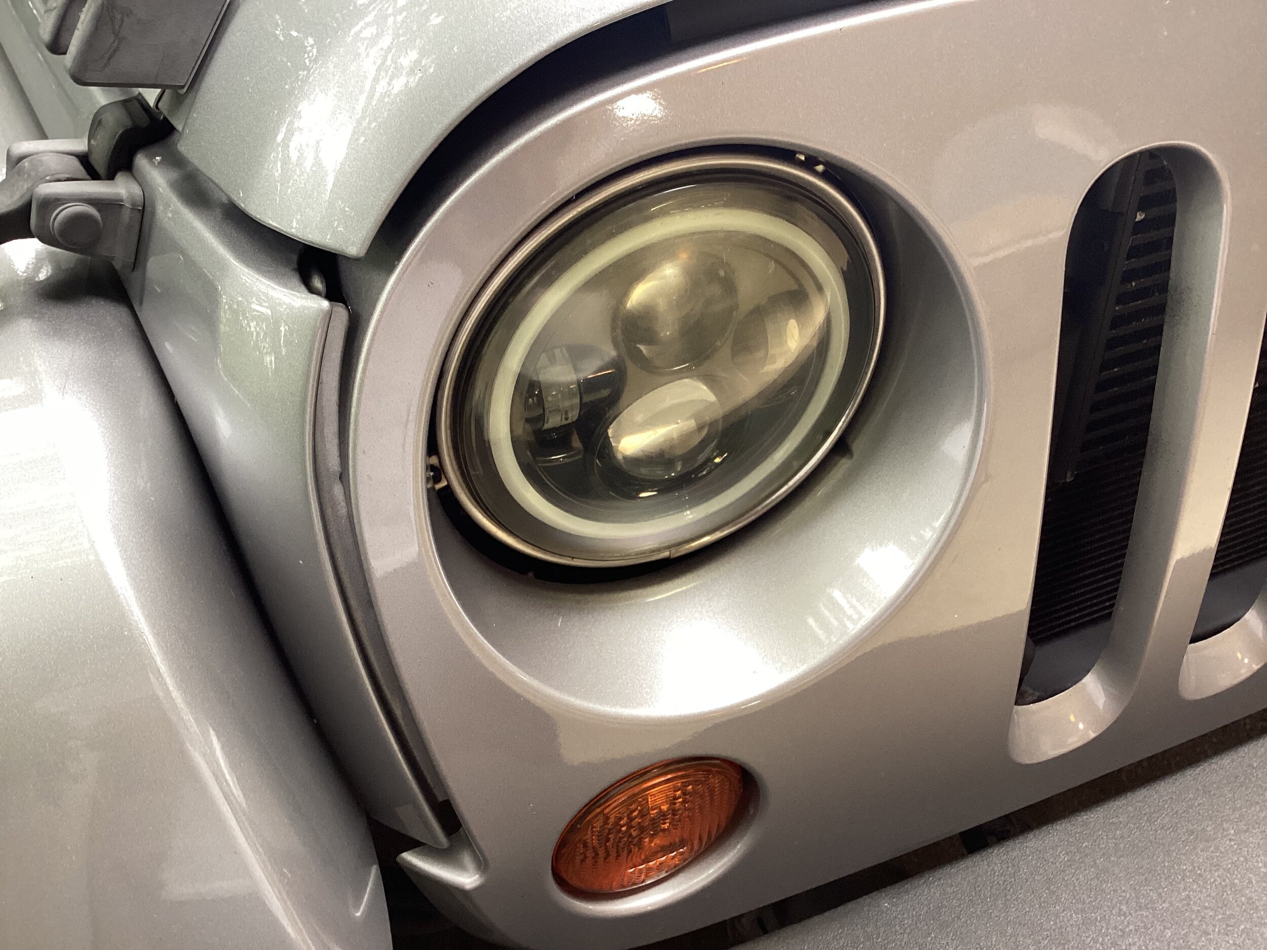

Do those aftermarket headlights have plug and play connectors to the factory harness or are they spliced in somehow? Did you install them or were they already there when you purchased the vehicle? I would start from the headlight and start tracing back to see if there is any visible wire damage.

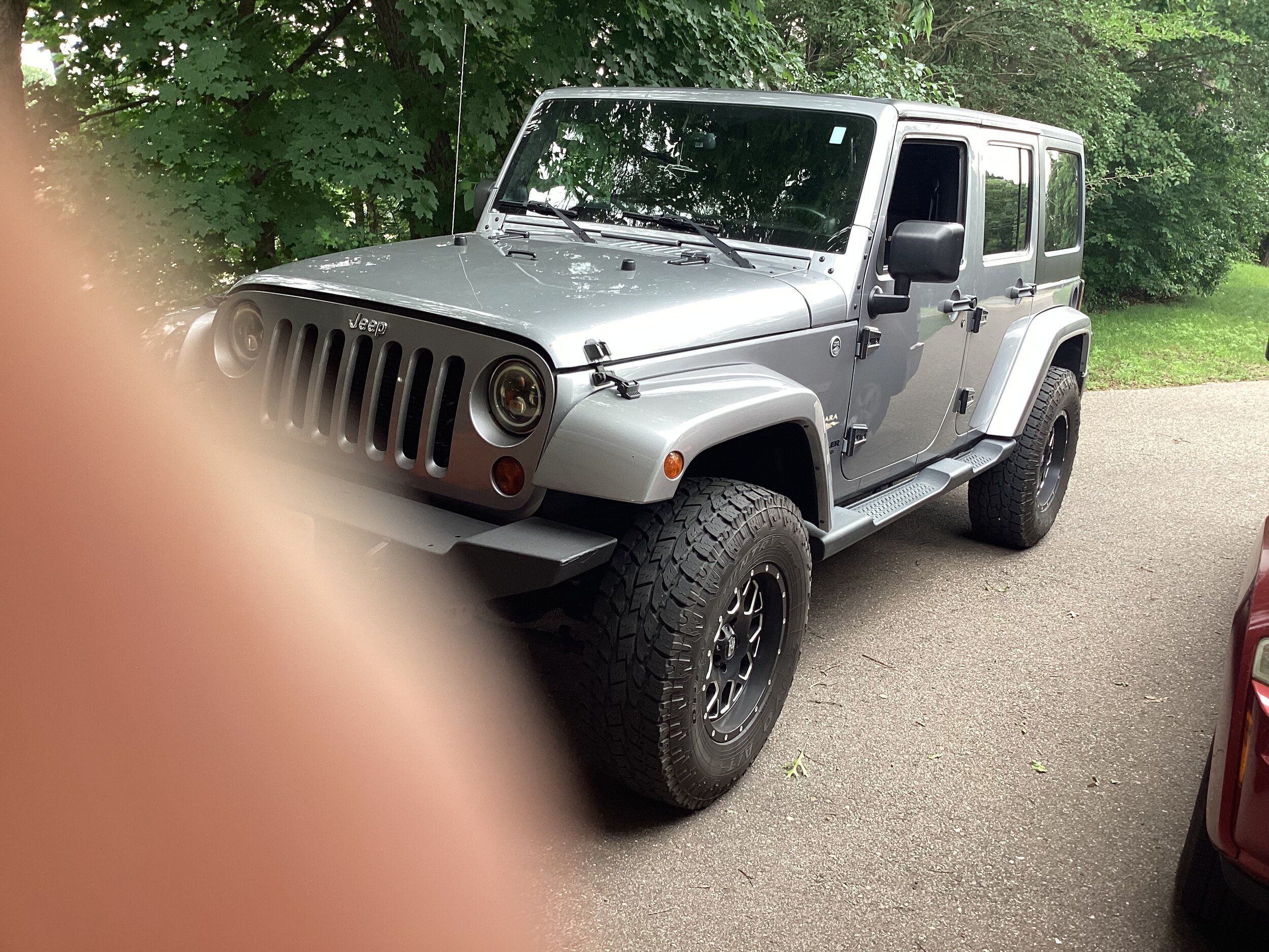

They were like this when I bought it. I haven’t looked at the wiring at all. This just started to malfunction last night. Can you tell by the picture that the lights are aftermarket?
Yes. Because the factory didn't install LED bulbs in 2013, not halo lights.
Reactions: tJKrider
Had this issue open the hood and with the lights on shake around the headlight connections and see if it comes on. you should have 2 plug and play connections ,one where it plugs into the oringinal wiring harness which should be the anti flicker tail wire for the headlight then one where it plugs into the headlight wire .so if it lights clean both connections put die grease on it then what I did was tied the connections very tight with electrical tape ..it worked for me..good luck

Hey vaffanculo, it worked! I couldn’t wait to get off work today and dig into this….your post gave me hope! The plug on headlight was held together with a zip tie and was loose. I cut the tie and put electric grease on connector, put the plug together, and secured it. Lights would flicker and go out as I wiggled plug so I knew it was the issue. I tied wires together in a fashion where lights where good and assembled the front end again. So far so good. If this fix fails, at least I know where to start next time.
Honestly, I wouldn’t have attempted anything without the couple of comments to my post.
Thanks again.
