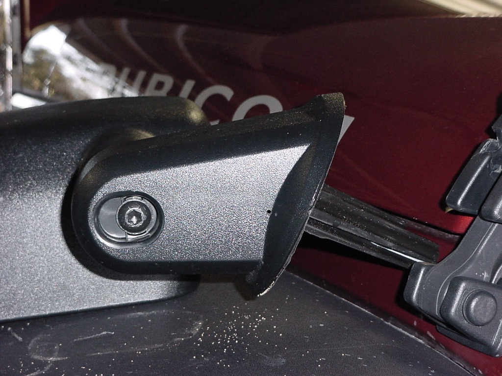

Our mirrors trap a lot of water. As a lot of others have done, I now drill drain holes in the bottom of the housing, as in this pic (not mine)
The full write-up is here. (@Chris, don't recall if this is in the "how-to" area)
I had a mirror corrode so bad it fell off. Now I do this and recommend it to others.
Very cool, thanks for sharing this!
