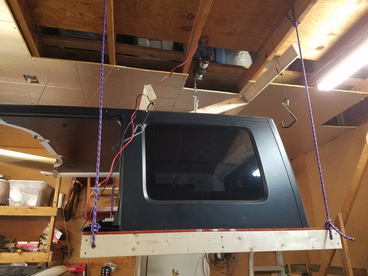

I made ours. I made an I shaped frame with 2x4s, then drilled holes at each corner and ran rope through with large hooks on the end. Drilled hole in the center and tied a short loop with rope to lift from. Installed an atv winch from HF and works great. Less than $100!

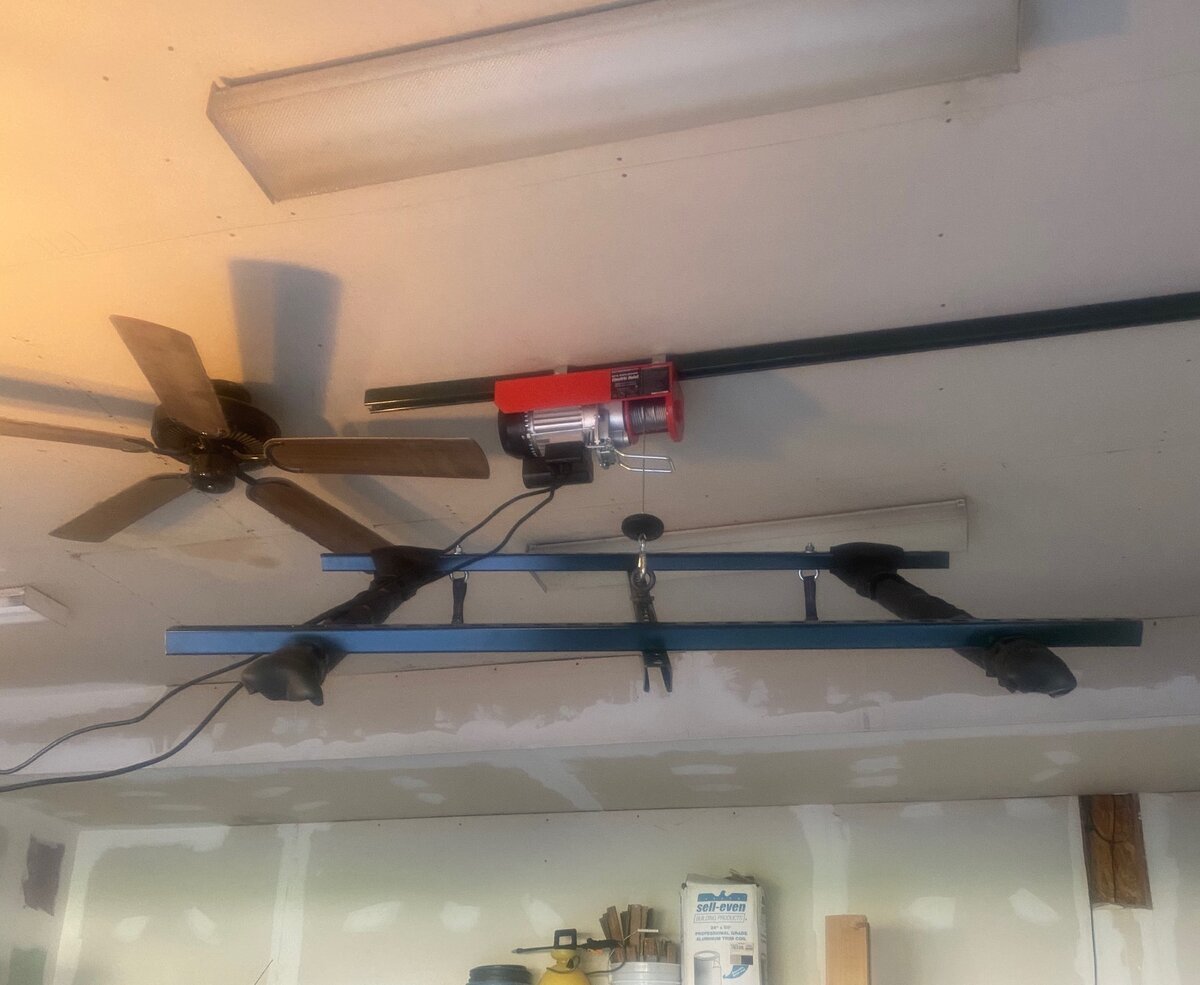

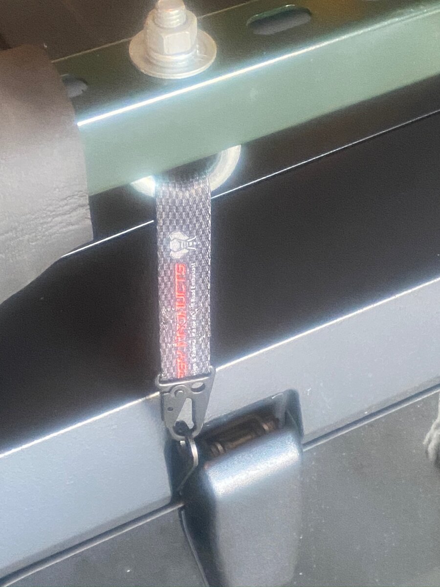

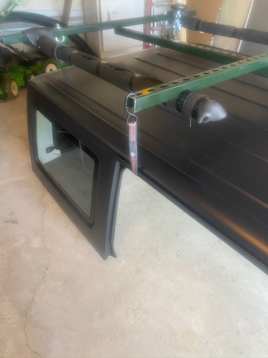

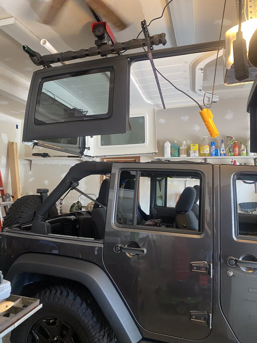

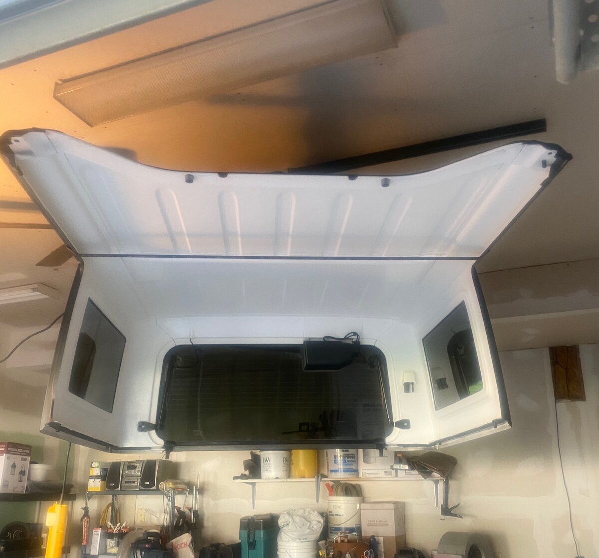

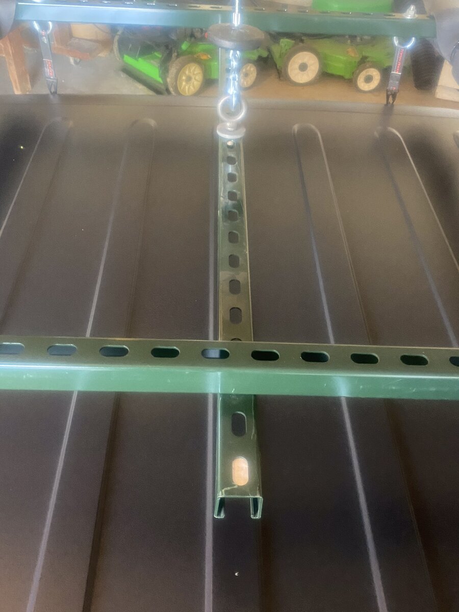

I made mine with a harbor freight 880# electric hoist, some uni-strut, and Topsy Products hinge hoist bracket kit. It works great I can easily take it off by myself in less than 15 minutes. Overkill yes but that’s an expensive top hanging above my Jeep.
